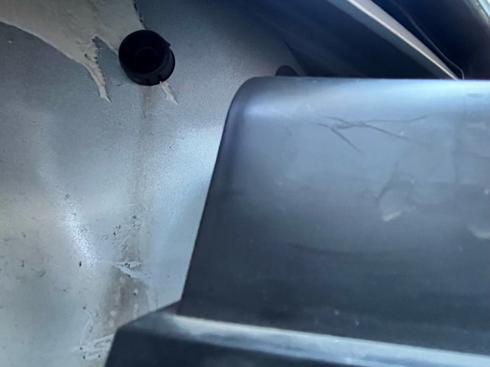

Wheelmanrob, I just went through weeks of trying to find my leak and found it to be the same as yours. Mine is a 2021 Escalade that I just bought! I'm confident the TSB will fix the issue but the reason the TSB was issued IMO is BS. The grommet you originally saw connects the drain line from the forward sunroof drain into the cowl, right under the glass (same on both sides). There in the cowl it meets water coming off the windshield and everything else. If you want to see it, just pop off the plastic connectors that run the length of the plastic cowl cover and peak inside. To take it all the way off you will need a gear puller to get the wipers off. But the grommet the line connects to is also the spout. Design issue here, the spout (grommet) is nearly horizontal. So when water drips out slowly, the surface tension will let the water run back toward the firewall and then down into the cowl. As it runs back, it seeps behind the grommet it just came out of. On mine, there is very sloppy body seem applied across the hole. There are three prongs that hold this grommet in with tension and in my case two couldn't press in correctly due to the thickness of the seem seal. There is a rubber seal on the inside (cabin side) of the grommet, so I guess I could have removed it, cleaned the sealer off and pushed it back tight to create a seal from the back. But it is such a tight space back there I went the lazy route and put some tubing on the end of the grommet and made extensions. I bought mine from Lowes for $8 and heated the end to make it easier to slide on. Like I said, mine was only connected with one little tab so I was carful not to push it back inside. I bet all anyone needs is a couple inches of tubing just to get the water down and away.

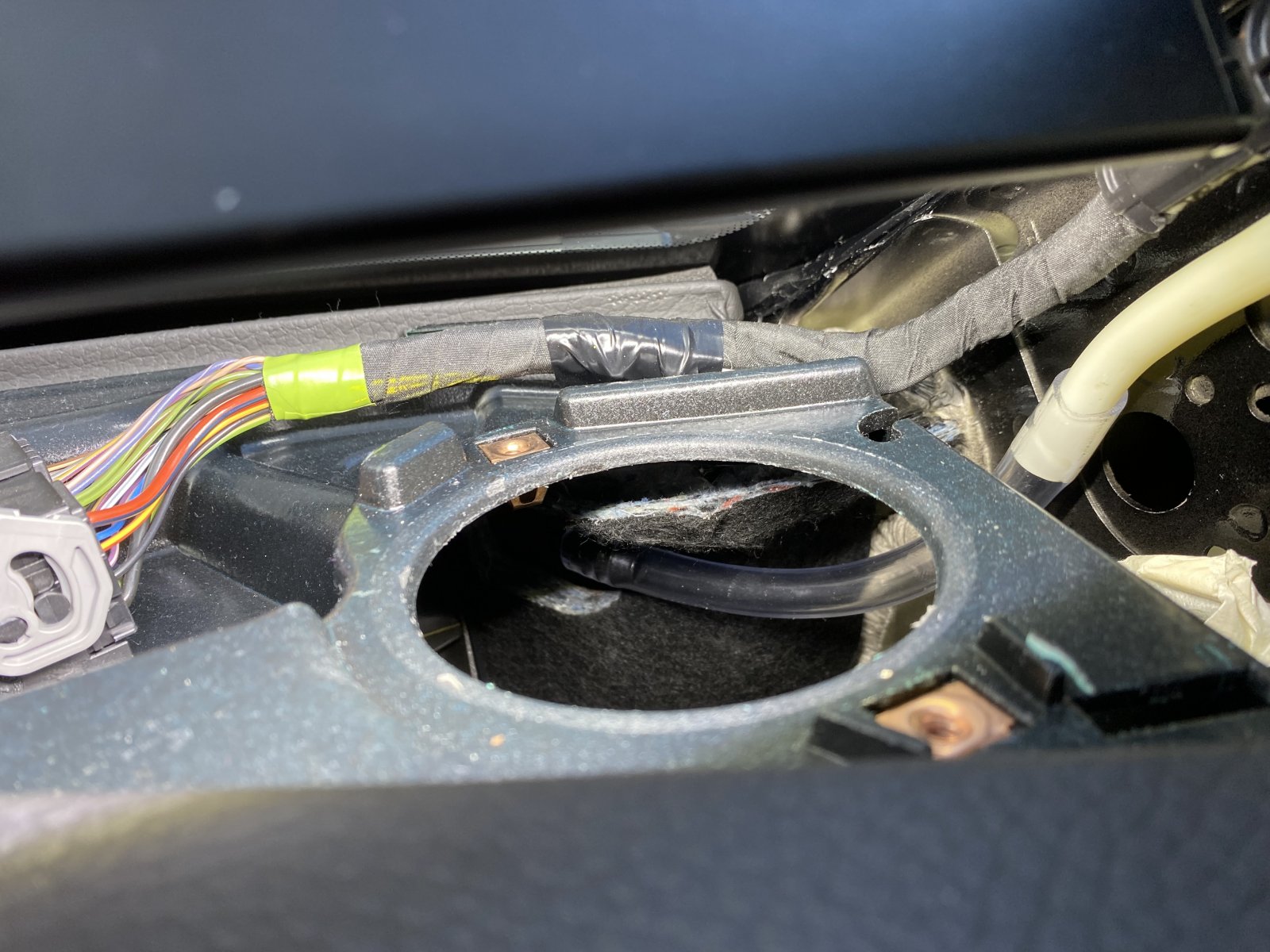

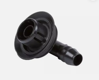

Thanks for the tips here. You were 100% correct. That was the location of the sunroof drain grommet. I went ahead and ordered a new firewall drain grommet of eBay, PN 84618825 and installed it. Once I got the speaker grille and speaker removed, I reached my hand down and grabbed the clear hose that had been run improperly and rerouted it to my new drain grommet.

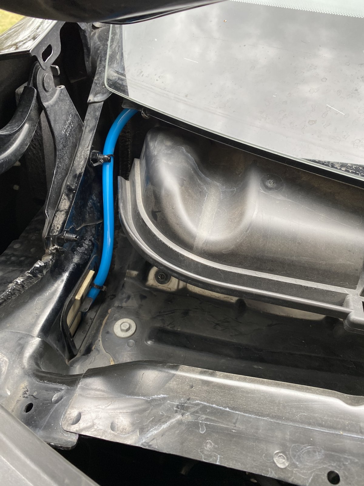

I also got the blue silicone hose referenced in the NHTSA 20-NA-219 "Gurgle or Sloshing Noise Heard Coming from Front Sunroof Drain Hose Areas." After looking at the grommet and understanding how it could fail, it's obvious like you said that the extension hoses will cure the issue. Even though I didn't have the gurgling issue at highway speed, I went ahead and installed the drain extensions. I even got the Loctite 380 black instant adhesive that was mentioned.
