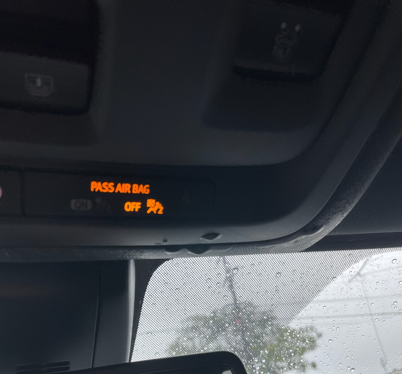

Well, it was raining both outside and inside my Tahoe. I took it to the dealership, so now just waiting to hear back. seems to mostly be on right side. I was parked facing downhill when it happened. I turned it around to park uphill and it stopped.

I just took out the overhead console and found the same small holes in mine. This appears to be the source.
Pacfanweb
Apr 10, 2023
I see at least one of these a month, if not two. Best case fix is to pull the windshield, and put sealer over the exposed spot welds while it's out.
I have tried fixing one with some spray sealer by sticking the little straw/tube between the rubber and the roof so it'll get behind the windshield, and it did work, but I prefer to just recommend the dealer have the glass pulled and do it right since they're all under warranty so far.
