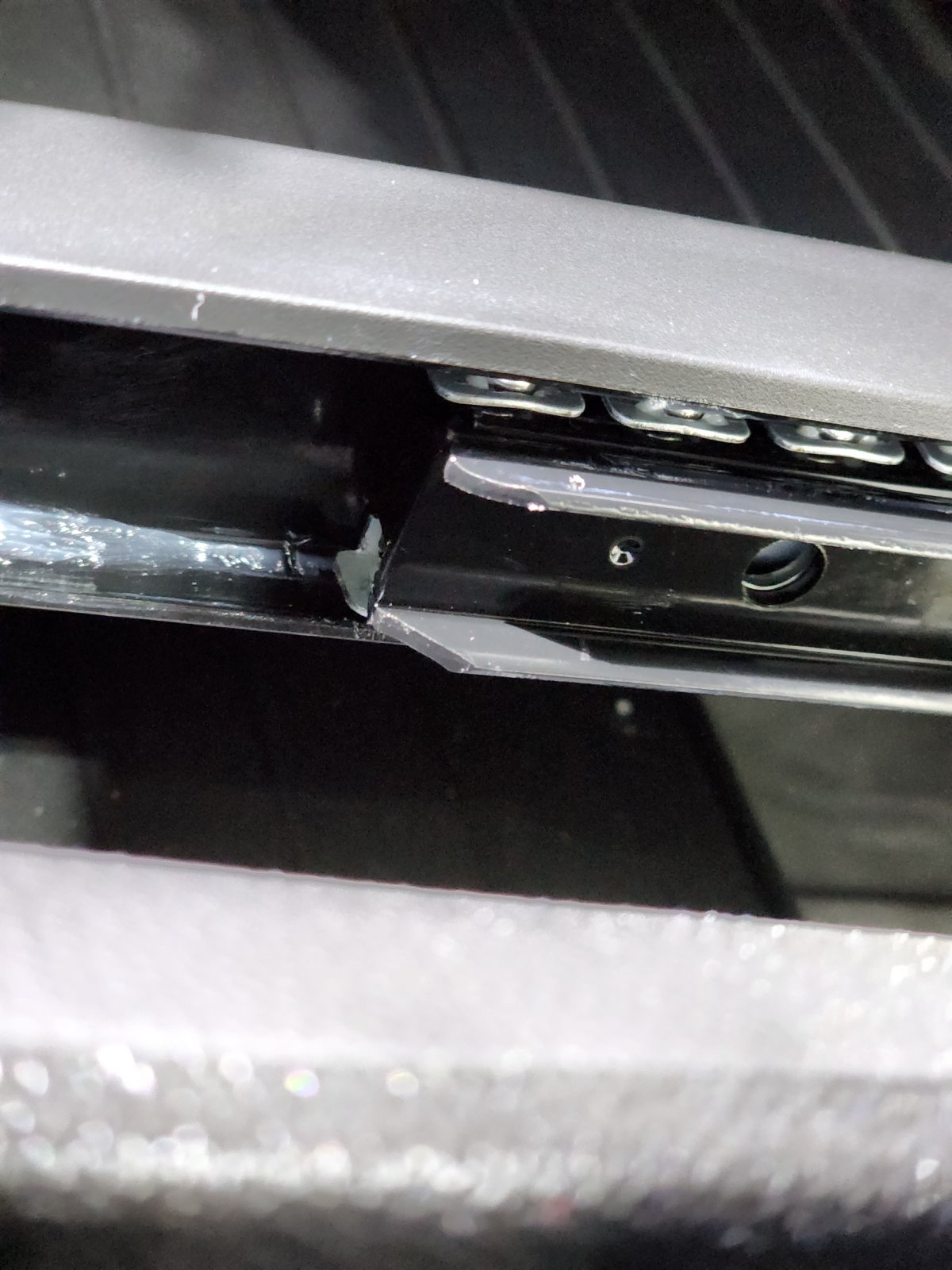

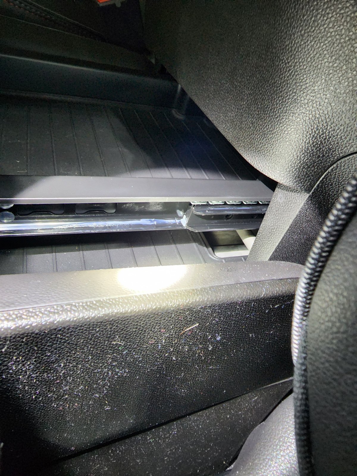

Here you go. Thank you for your help.

Press a flat blade screw driver into that hole that's about an inch back from the end of the slide. There should be a spring loaded tab back there. Press in on it and tug back and forth on the drawer. You should feel it pull out a bit further and then you'll need to do the other side to get it out completely.

Tried pushing in. No luck. Looking thru the large hole there is a tab that slides within the track that is part of the drawer. This tab is about a 1/4 inch long and has what looks like 2 small keyholes positioned up and down. This tab rides all the way out with the drawer and stops at end of the black slide keeping the drawer from sliding out.

Any chance you can get some closer pictures of that tab?

I guess it's possible they made that slide locked together - I've never seen one that way, but I suppose it's possible.
Here's another way of getting at the backside of that drawer.
