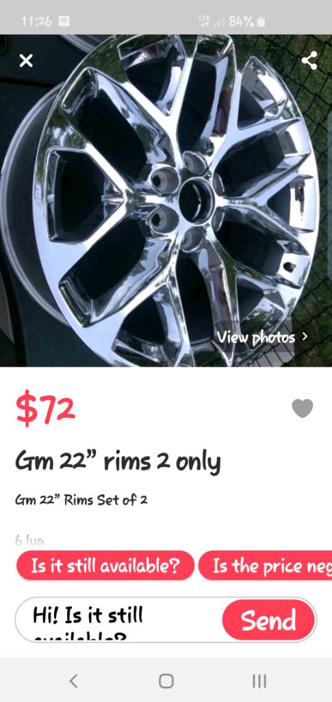

I picked up two blem 22 oem wheels for a great price so im gonna use them. Just not sure about the hoist. I see there are two types.

I don't think the hoist seat would get through the hole. Could probably make a simple adapter from a piece of heavy plate steel with two bolts on each end to pass through the lug holes and hang it by those.

I've never seen the hoist for the 22" wheels but the replacement Dorman is much shorter and covers both part numbers.
