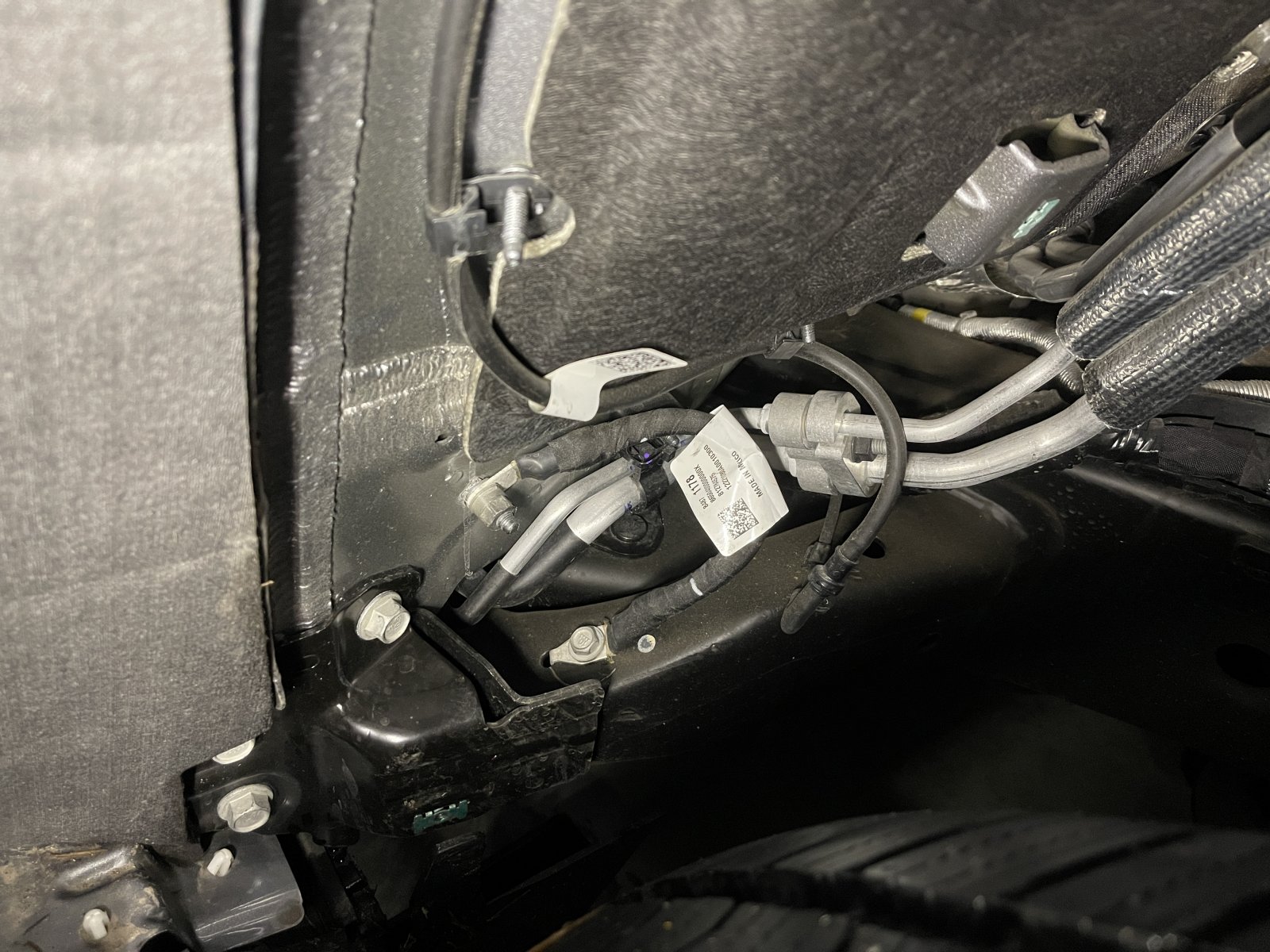

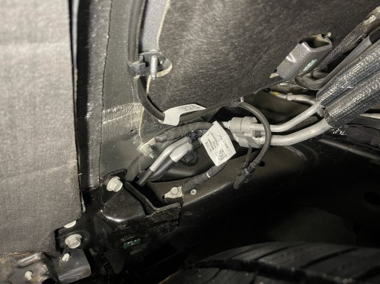

My rear windshield washer will not work. There is water getting to the connection underneath by the spare tire but no water will come out of either the rear wiper or rear camera. When I fill the reservoir and try the rear wiper water will start leaking just behind the front right tire. Then the reservoir will continue going down until it is empty. If I don’t try the rear washer the reservoir remains full. I think somehow it is leaking under the cowl where the rear line goes from the left side to the right side.
Chad G 1979
May 6, 2022
527
327
Might be a broken fitting or split hose somewhere heading to the back.
StephenPT
Jan 16, 2022
1,252
1,266
St. Helens, OR
There’s a handful of screws that hold the carpeted wheel well liner in. Unscrew them and you’ll get access to this area on the passenger side.
There’s a 90deg elbow right next to the frame. I’ll bet the one end of the connection came loose. Push it back on and put a zip-tie on it so it doesn’t come off again.

Well I figured out the problem. I removed the rear storage bin above the spare tire and the padded insulation was a little wet. I removed the tie downs on the right side trim and pulled it away from the wall a few inches. The washer hose had pulled out of a barbed fitting. I pushed it back together and wrapped the fitting with good electrical tape. Now the rear washers work great. I couldn’t figure out why there was water leaking on the ground just behind the front right tire before I found the pulled apart tubing. I have Weathertech floor mats in the entire vehicle. I pulled up the one in front of the rear seat and the carpet was wet. It was also wet in front of the middle seat and in front of the passenger front seat. The washer fluid was running all the way to the front of the vehicle and dripping on the ground right behind the front right tire. I pulled the mats out and all that is left to do is allow the carpet to dry. Such a simple fix for a major headache!
