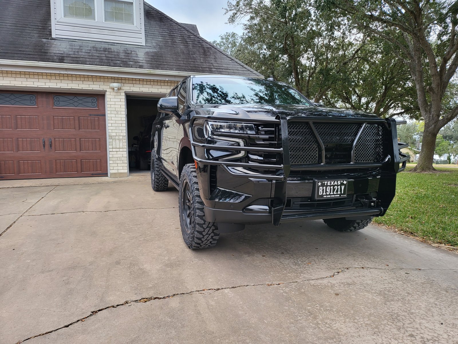

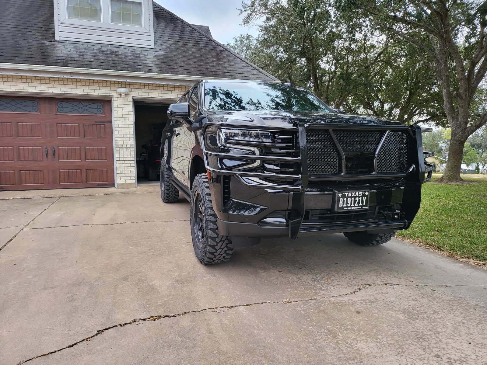

Zero offset was not the best decision for my 275/65 R20 Geolander 003. They rubs heavily at 27° of Turn. 3.5"lift and I had to cut a little fender liner. If I want to get rid of all the rub with 34" tires, I either have to do some serious cutting on the metal bracket at the rear of the fender well, or go down in tire size to a 33" tire. I Belive with the tire size you stated, will not rub. Could be wrong. I just live with it till I'm ready for more tire, which is not far away. Here are some pictures when I first put them on

Zero offset was not the best decision for my 275/65 R20 Geolander 003. They rubs heavily at 27° of Turn. 3.5"lift and I had to cut a little fender liner. If I want to get rid of all the rub with 34" tires, I either have to do some serious cutting on the metal bracket at the rear of the fender well, or go down in tire size to a 33" tire. I Belive with the tire size you stated, will not rub. Could be wrong. I just live with it till I'm ready for more tire, which is not far away. Here are some pictures when I first put them on View attachment 390695
Your pics and wheels help quite a bit. Your wheel being an 8.5 looks nearly flush, a 9" would be another 10mm at least. - Definitely not wanting them to be out beyond the fenders.

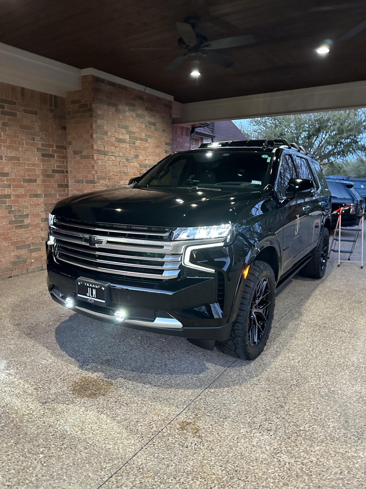

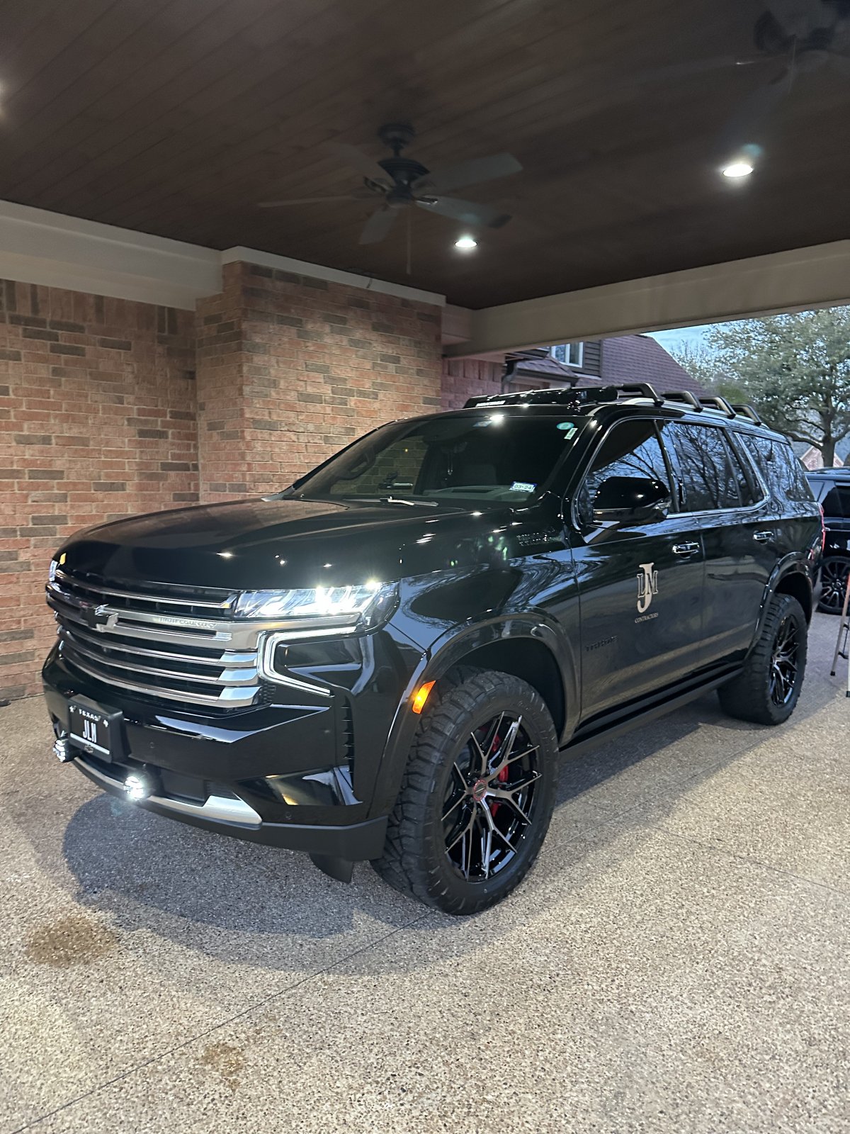

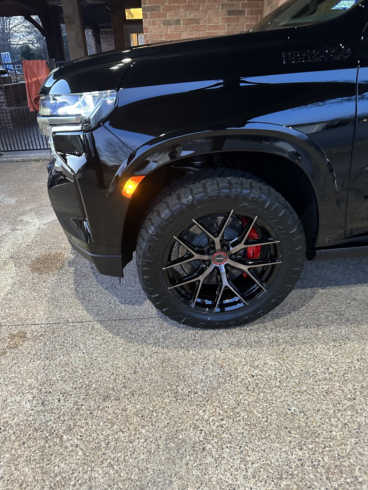

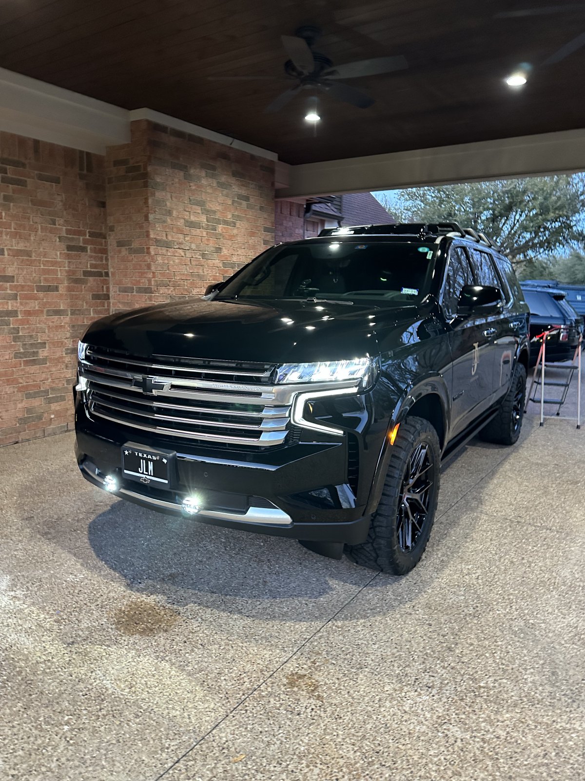

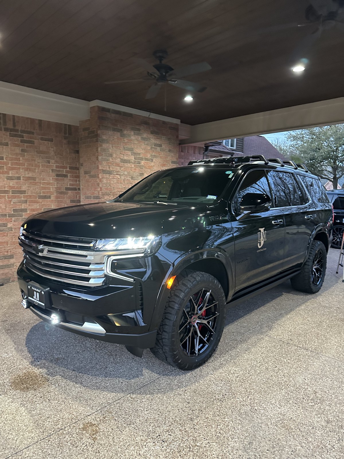

Don't know if this helps but this is a +20 offset, 295 50 22 nittos, I think its a 9.5 width
