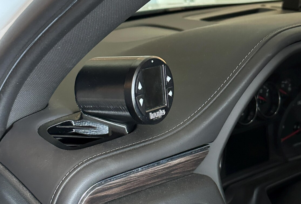

There's no nut-serts in the sheetmetal of the A-Pillar on the SUVs for the LH grab handle. I've had it off before to check. I ended up modeling a 52mm gauge pod and screwed it in from the backside of the pillar to mount my Bank I-Dash.

alright so I got the idash and ordered (reluctantly) a mount from ETSY. If it's a little shiny I may sand and paint it, but we'll see what happens
Can you elaborate on your install? I wish to add a Banks in my 2025 Yukon Denali.
