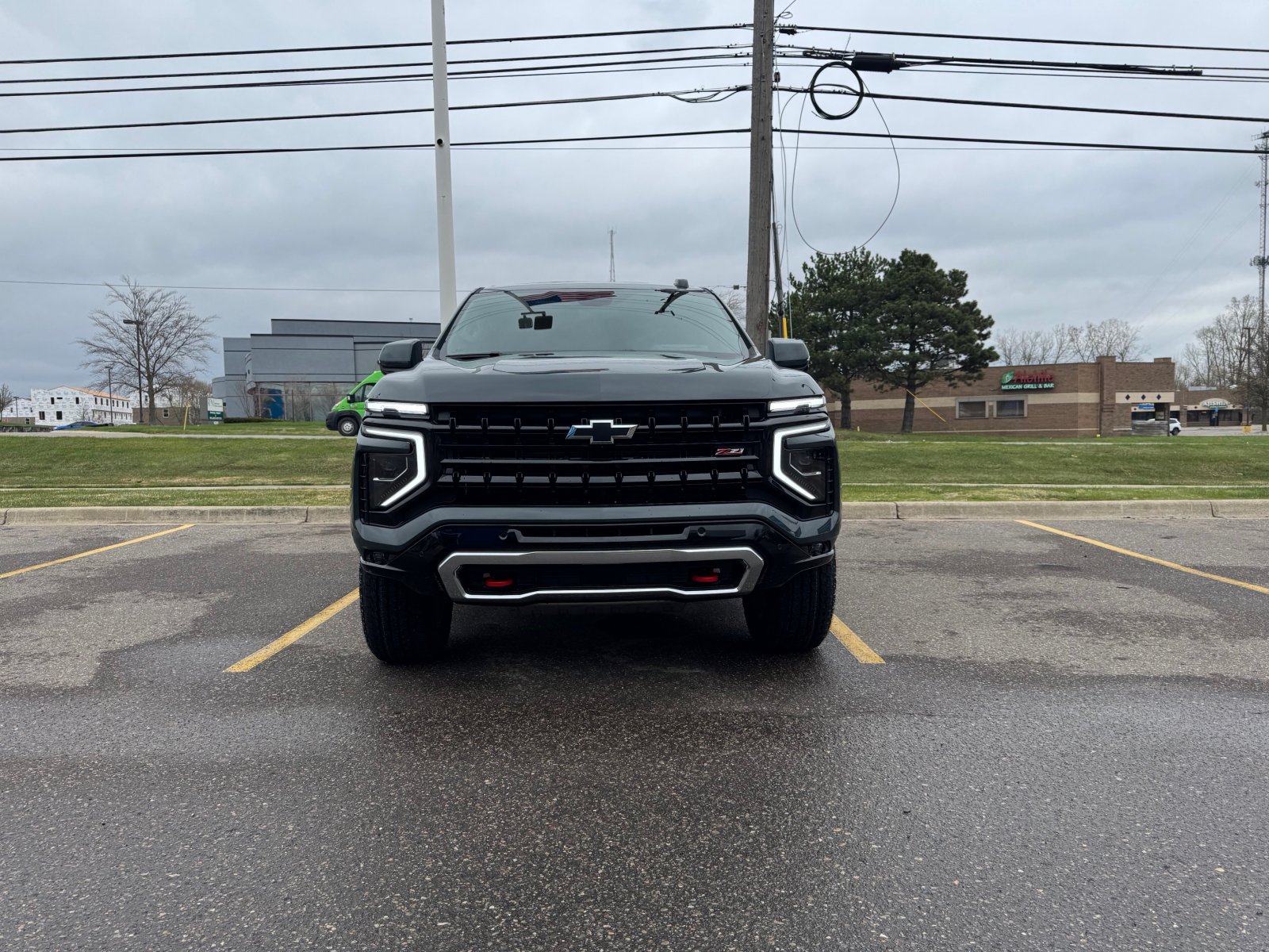

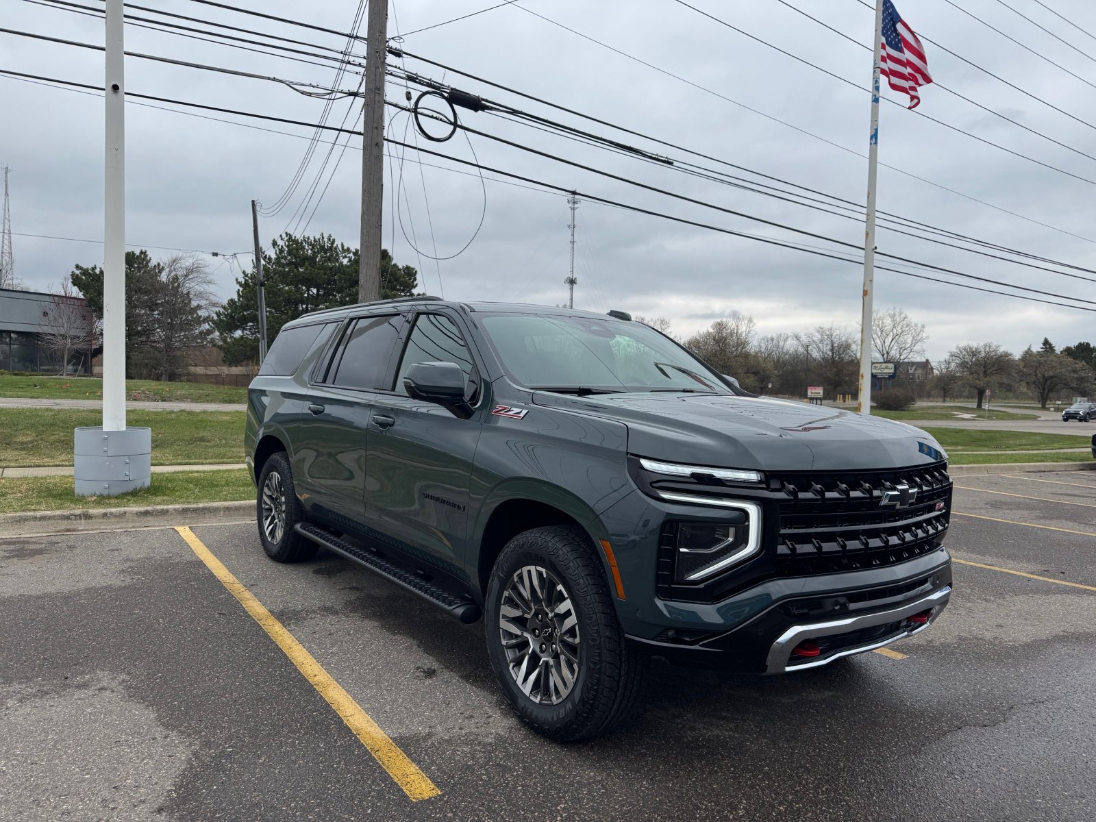

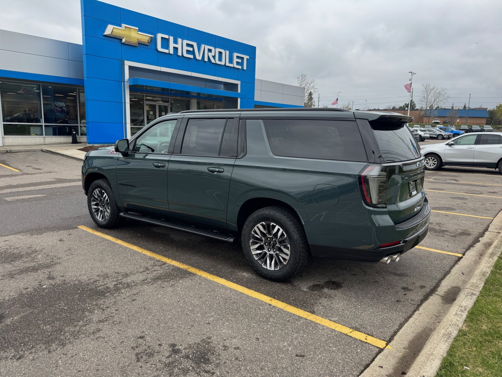

Hi all,
Purchased a brand new 25 Suburban 6.2L Z71 a couple weeks ago. Pics below. Coming from an MDX, it’s quite the change but we love it! Only issue so far is that the shift from 1st to 2nd gear is rough/jerky, like it’s hunting for 2nd gear. The shifts in all other gears are no problem. If I accelerate slowly, then it’s smooth but, if I accelerate “normal”, then it happens. Only 900 miles on the odometer. I found two other threads on this forum for a 2023 and 2024 experiencing the same issue, but no resolution was posted. Some were saying the transmission is “learning” your driving habits and I hope that to be true but why is it only an issue for 1st to 2nd?
Thanks in advance!
