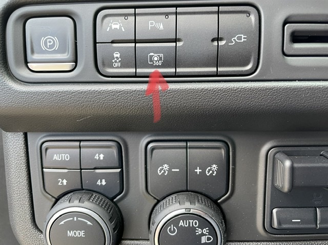

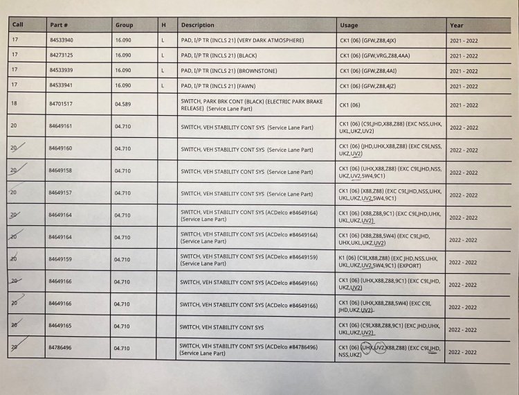

you can add the button from a 22 and it will work. I already did the leg work to confirm the wiring is in place and the circuit works as designed. You will have to look up a Stability Control Switch with all your RPO code, then add the RPO code UV2 to get the correct part number

Wow! Ok I’ll have to look into this, I’m not sure if there are any open switches, or where the switch is located on the 22’s

Here it is on the 22’s.

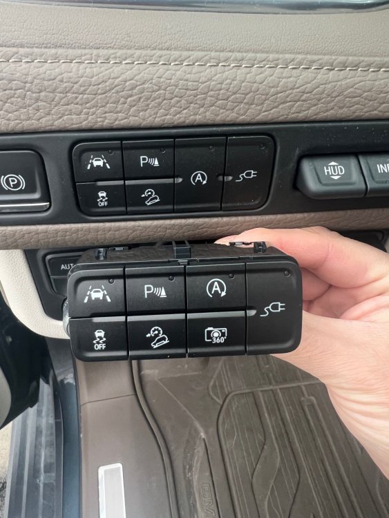

I have to credit this info to peterlawl84 on another forum. Based on his information I ordered the replacement switch panel to add the 360 degree camera button to my 2021 High Country Suburban. If time permits this weekend I will install and report back.

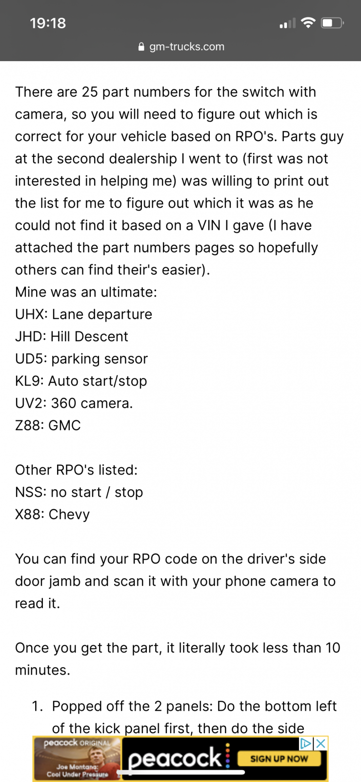

It appears you need the same part that I used… 84786497
I googled that part number and ended up ordering online from quirkparts.com The part arrived today, about 10 working days after I placed the order. I called my local Chevy dealer and they quoted 2 weeks to get the part in and we’re about $15-20 more that the above website I used even with shipping included.

Awesome got it. Yea I didn’t get my door codes but reading what u put and adding x88 I figured it was the same part. I’m gona double check in morning and then order. Let me know how install goes if it’s just plug and play. May wana disconnect black battery cable before u unplug switch?
