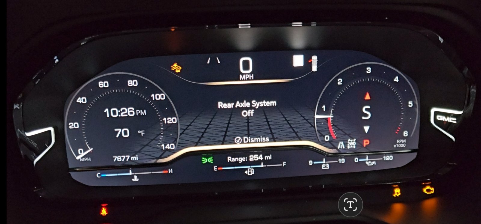

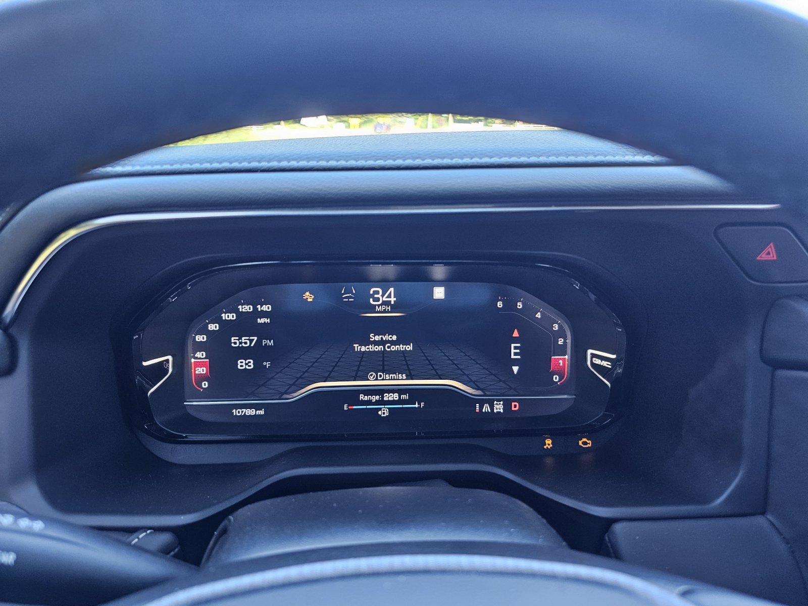

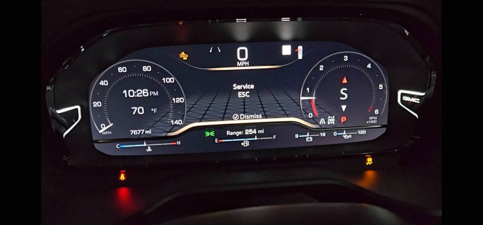

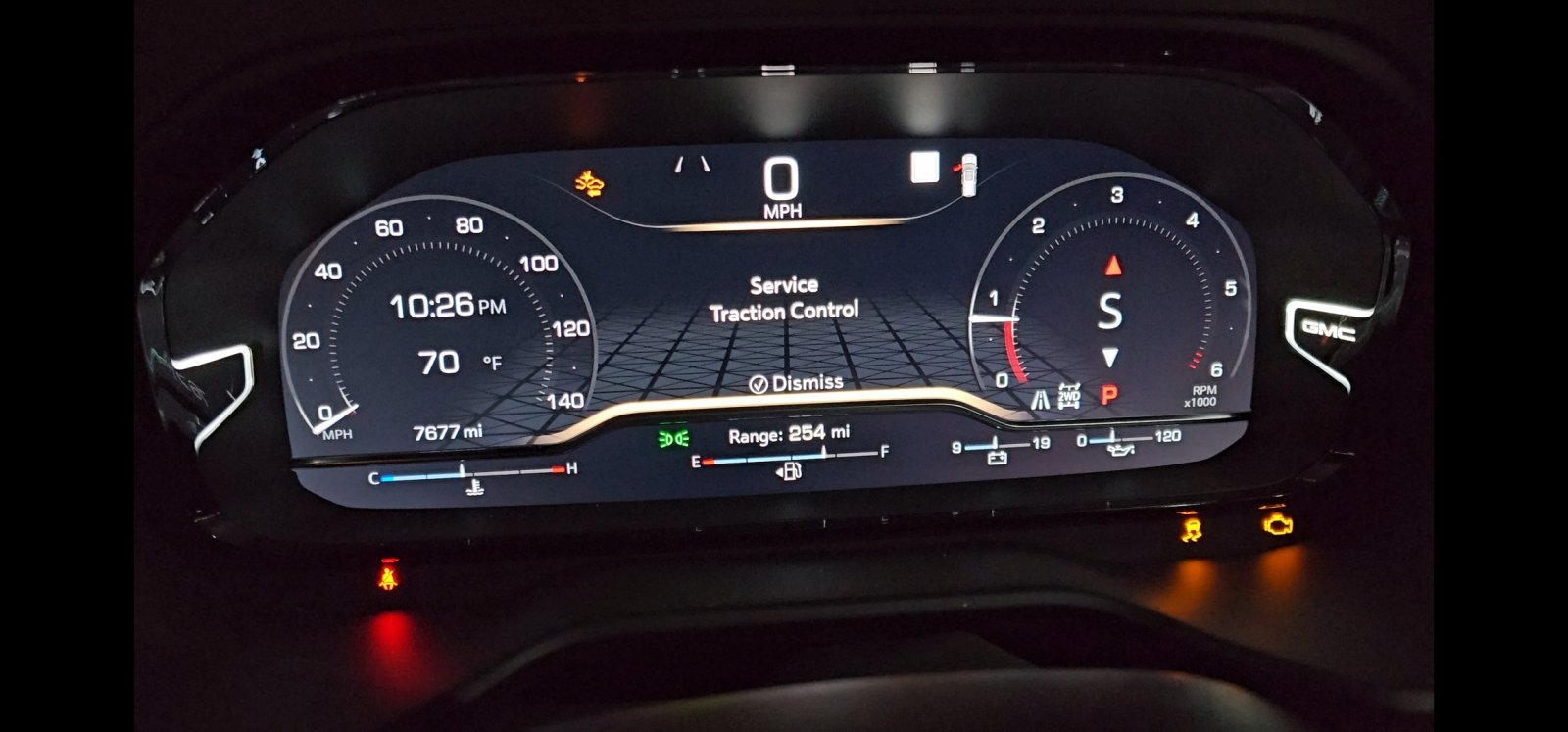

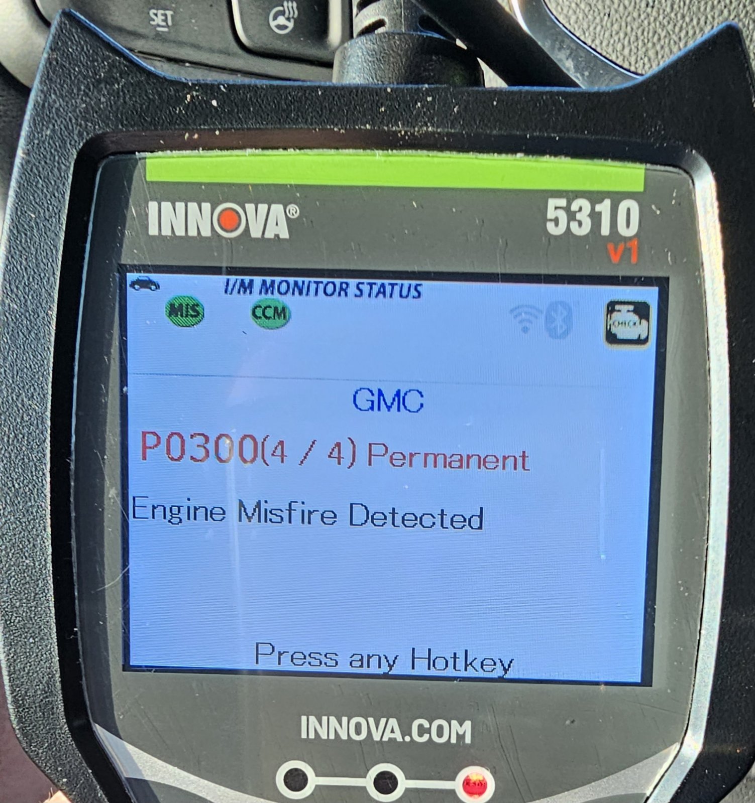

-Was on the highway at about 70mph, and multiple lights came on, multiple messages on DIC and started smoking and running awful.
-CEL flashing, ABS on, Forward Collision on, Stabilitrac light on.
-DIC messages: Rear Axle System off, Service Traction control, Service ESC.
-Air Ride fully deflates.
-Identifiable OBD2 codes: P0300 Misfire detected, P0306 Cylinder 6 misfire
-Mystery (to me) codes: U1346 (Permanent) Engine Control Module LIN Bus 2 and C2A0A which my scanner doesn't define.
What I've done thus far waiting on dealer to open tomorrow:
-Disconnected negative cable for 30 min hoping for reset.
-Pulled #6 plug, which was wet and dark, likely fouled, replaced with new.
-Replaced #6 wire and coil with new AC Delco.
-Tested alternator output via OBD2 scanner, registered roughly 13.5 volts at steady 2000 RPM for 20 seconds, Voltage was about same at idle.
-Tested alternator with voltage meter to hot side and ground. Same voltage.
-Tested alternator by removing negative battery cable while vehicle was running, it stayed running.
I was waaay out of town and did this with borrowed tools in an Autozone parking lot.
Really weird combo of lights/warnings.
Any ideas?

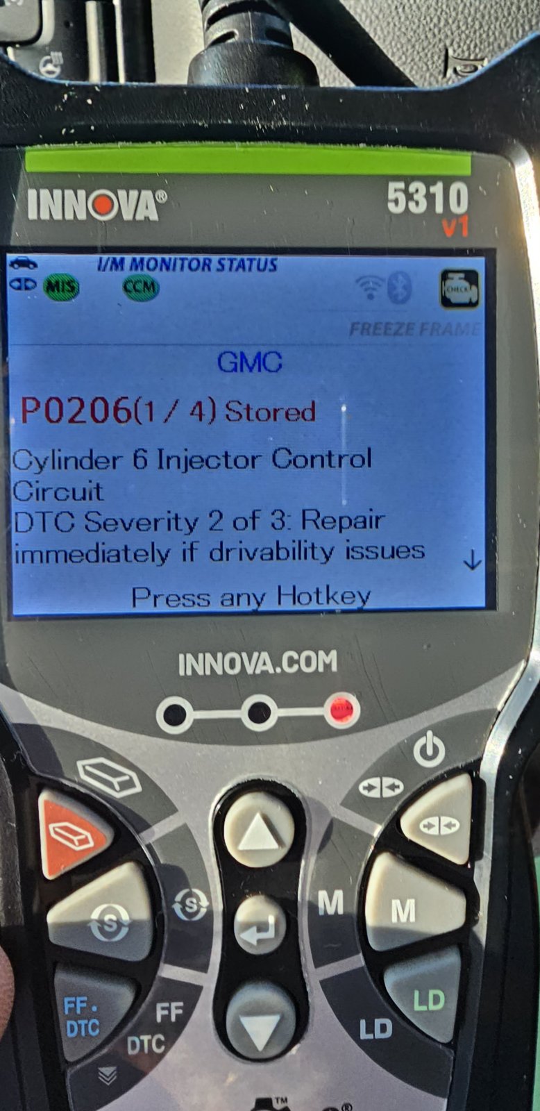

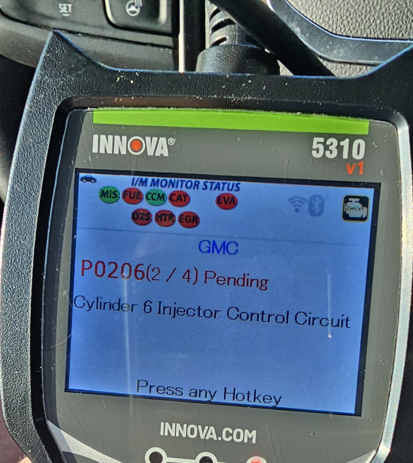

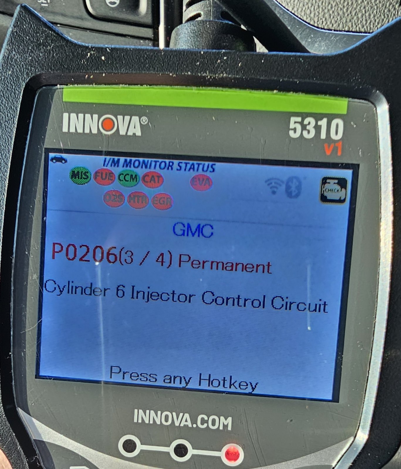

UPDATE: The 2023 GMC Yukon XL "Ultimate" is DEAD AGAIN! Less than 2 months and 2,000 miles after the dealer replaced the lifters under warranty, this giant POS has the exact same problem. This time is especially painful as I'm stranded out of town with the family and a trailer. Effff you GM!!!

Looks like an injector, not a lifter problem to my eyes.
