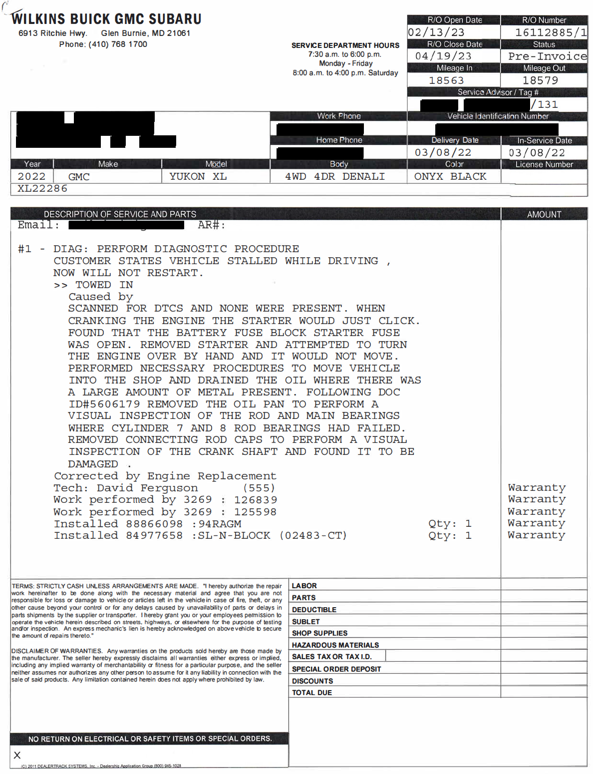

Just to report back in on my situation, I got my vehicle back today. What's it been like 10+ weeks? Everything seems to be fine - new engine, all new cooling system, all new hoses and seals, - basically the only thing left from the old engine were the accessories. Haven't put many miles on it yet, but it drives like new at the moment. Service invoice attached:

While I was at the dealer picking my vehicle up I talked to the service manager and he said that since my vehicle came in they've also had a Sierra come in with the exact same issue and they were just about to finish up the engine replacement on that truck. I asked him about a post mortem on the engines and he said they hadn't been done yet but they were going back to GMC for that. He said based on what his master techs told him they all think it was defective bearings that were part of a supplier assembly line that was shut down during Covid and then reopened with a different set of employees. That was his theory at least.

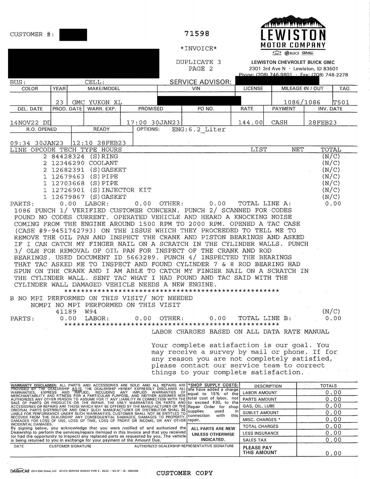

I'm in the same boat as some of you. I purchased a '23 Yukon XL Denali 6.2L in Nov'22. In Dec'22 the Yukon shut itself off while driving and shifted to neutral. This happened 3 times in a row and then the problem disappeared. I took it to a dealer and they couldn't replicate the issue. Fast forward to 1/27/23 and at 1,081 miles the engine started chirping. Turns out the #7 and #8 rod bearings are spun. The new engine installation just finished on 4/21/23, however I haven't yet seen the vehicle. Unfortunately, when the engine decided to self-destruct I was out of town and GM refused to tow the Yukon ~150 miles to my local dealership. The lovely part of all of this is the vehicle has been out of service for as long as its been in service! Here's my interim invoice:
View attachment 397788View attachment 397789
GM has strung me along and lied, told half lies, half truths, etc. As such I reached a breaking point and filed a lemon law case a few days back after GM ignored my demand repurchase letter for 40+ days. The vehicle was purchased in Washington State, which for all of its faults has strong lemon law statutes. What I've learned is don't bother talking to the GM reps - they can't help you and only string you along. Go straight for the lemon law or an attorney. Good luck to everyone!
Not sure about your state, but in my state your vehicle meets all the Lemon Law qualifications. In my state the dealer would have to provide you a new vehicle or a refund. I think you did the right thing by filing.
