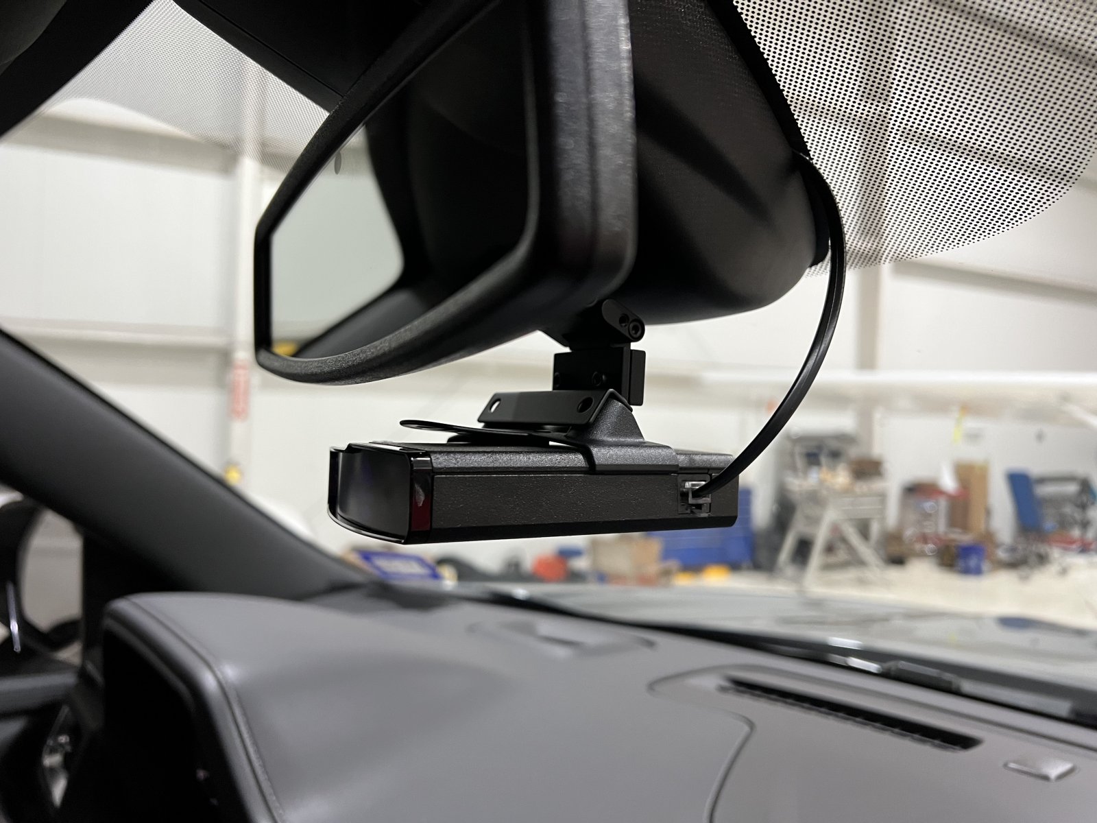

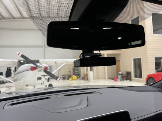

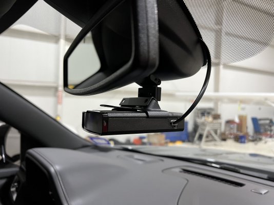

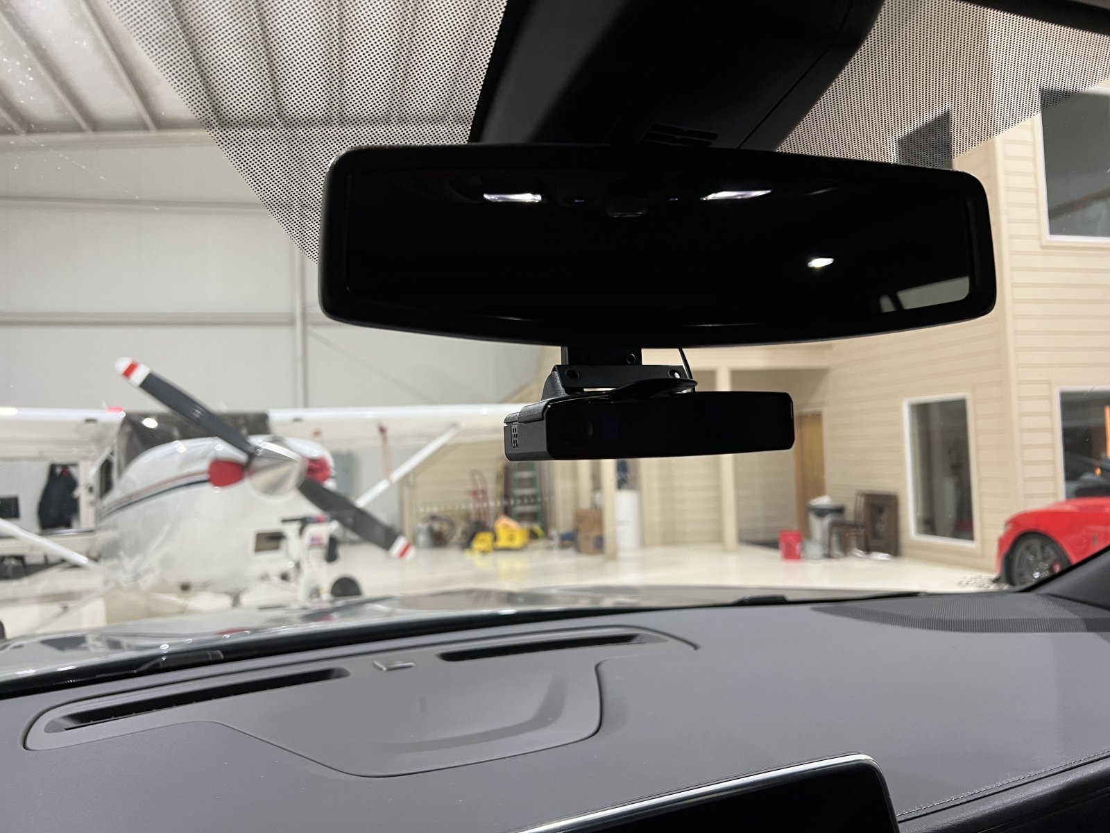

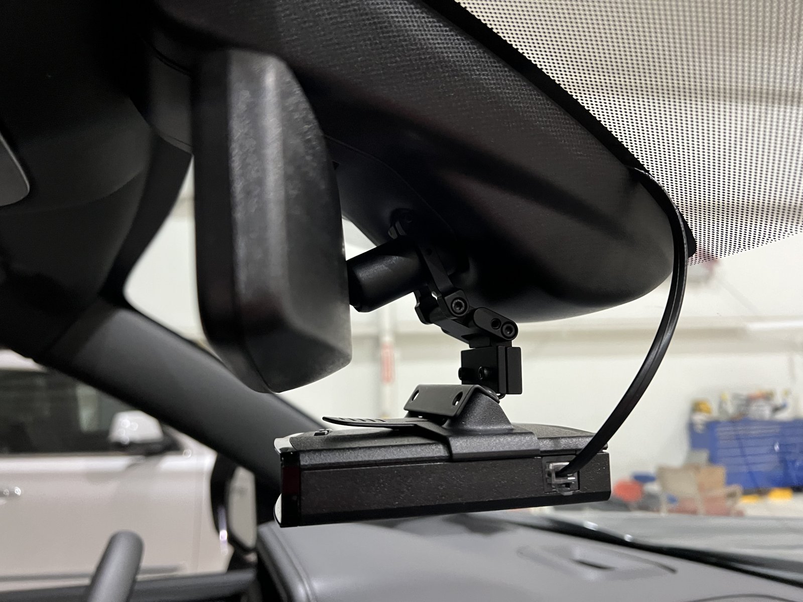

I don’t have pics to post but here is the cable adapter I used.
Super easy install.
Blendmount for the mount on the mirror.
I can take a pic if anybody is interested.
D.

I usually use mirror tap solutions but these guys make a slick harness. Got one for our Camaro also.
As your sitting in the vehicle. Connector is lower left. Hardest part is getting plastic to go back on with the additional cable
D.

The harness is keyed power. So no dead batteries.
here is a video for a Silverado install
The trim on my 22 z71 and connector location was different. Worked perfect. And the blend mount is slick.
D.

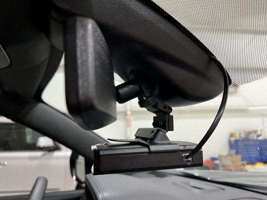

I installed this in my 2022 tahoe High country 3 months ago, with no problems. The people posting about potential issues misrepresent the problem. The blend mount selftap setup has caused issues in the corvette. Look at vortex radar on youtube, one of the best radar people on the earth. The gen 5 harness works great in the tahoe. The worst part is trying to stuff it back under the plastic cover. I have been completely satisfied with gen 5 radar harness. In fact, I just installed the harness for my 2020 camaro SS and it works great as well, actually easier to install than the tahoe. I understand doubeleive saying do it yourself with some wiring, but I am not the capable, so for me gen 5 radar harness did the trick.

Gen5diy harness worked great for me also. I used a cheaper ($30) below-mirror mount from Amazon since I didn't want to spend $100 on a blendmount. Works pretty well and the while the mount isn't as nice as the blendmount probably is, it gets the job done and cleans up my console area. I bought the harness with the pigtails and a voltage converter so I could also power my dashcam. Getting the cover back on was a total PITA.
