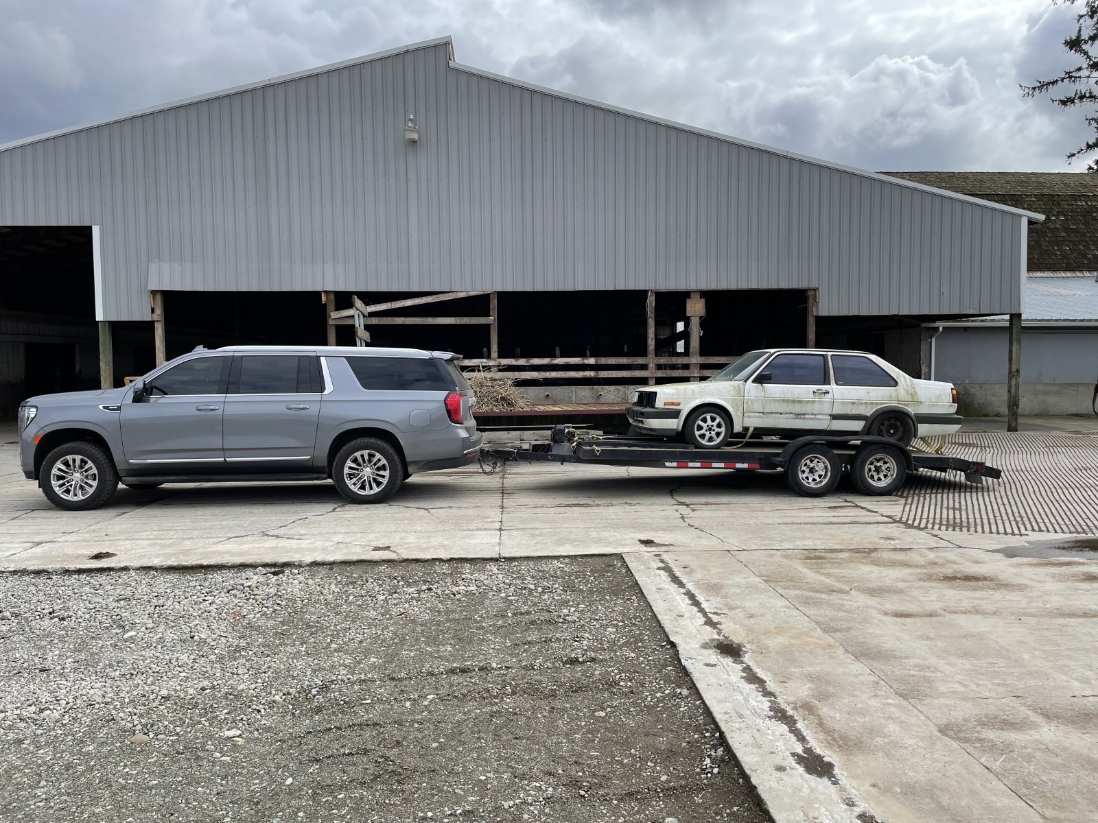

I did my 2nd tow with the new yukon yesterday. Small car hauler with a small car (mk2 jetta coupe) and power wise it was great, no worries at all. Made the rear sag pretty good so that will need to get addressed but the ride was smooth overall. Short tow, 17 miles exactly and got 13.4 mpg

squat squat...Don't mind the pile of **** i'm hauling (parts car for my GTI) but I doubt that trailer and car weigh even 5k lbs

interesting Ive seen a few with a similar squat on the road. Last week saw a similar yukon hauling a 7 seater UTV with similar squat. Im guessing the load leveling is what causes the squat. Then again i saw a Tahoe earlier this week not hauling anything with a similar squat…

With air ride there is no squat. I believe the rig pictured above does not have air ride. When I pull my enclose snowmobile trailer there is no squat, however, I have air ride which auto levels the vehicle with the extra weight.

Correct, I do not have air ride. I have the ZW7 suspension which is not ideal for towing as it's super soft. Level kit possibly makes the sagging a little worse. If I did any amount of regular towing or heavier towing this would not be the rig of choice
