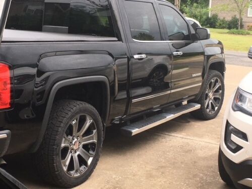

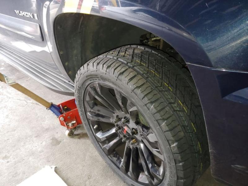

If you're looking at a 285/45/22 tire, look at the continental TerrainContact A/T. The factory photos don't do them justice but they have a really nice "offroad" look with great on road manners (handling, quiet, amazing in the snow and rain). I put a set on my wifes Grand Cherokee and those would be the tires I would go with. I just don't want a lower profile tire, the ride from the stock tires is pretty nice so would want to keep the same sidewall height if possible. With all that written, I wouldn't have a problem throwing a set of these on the Yukon.
Edit: Found a few pictures online of these on GM wheels. Not my trucks.
