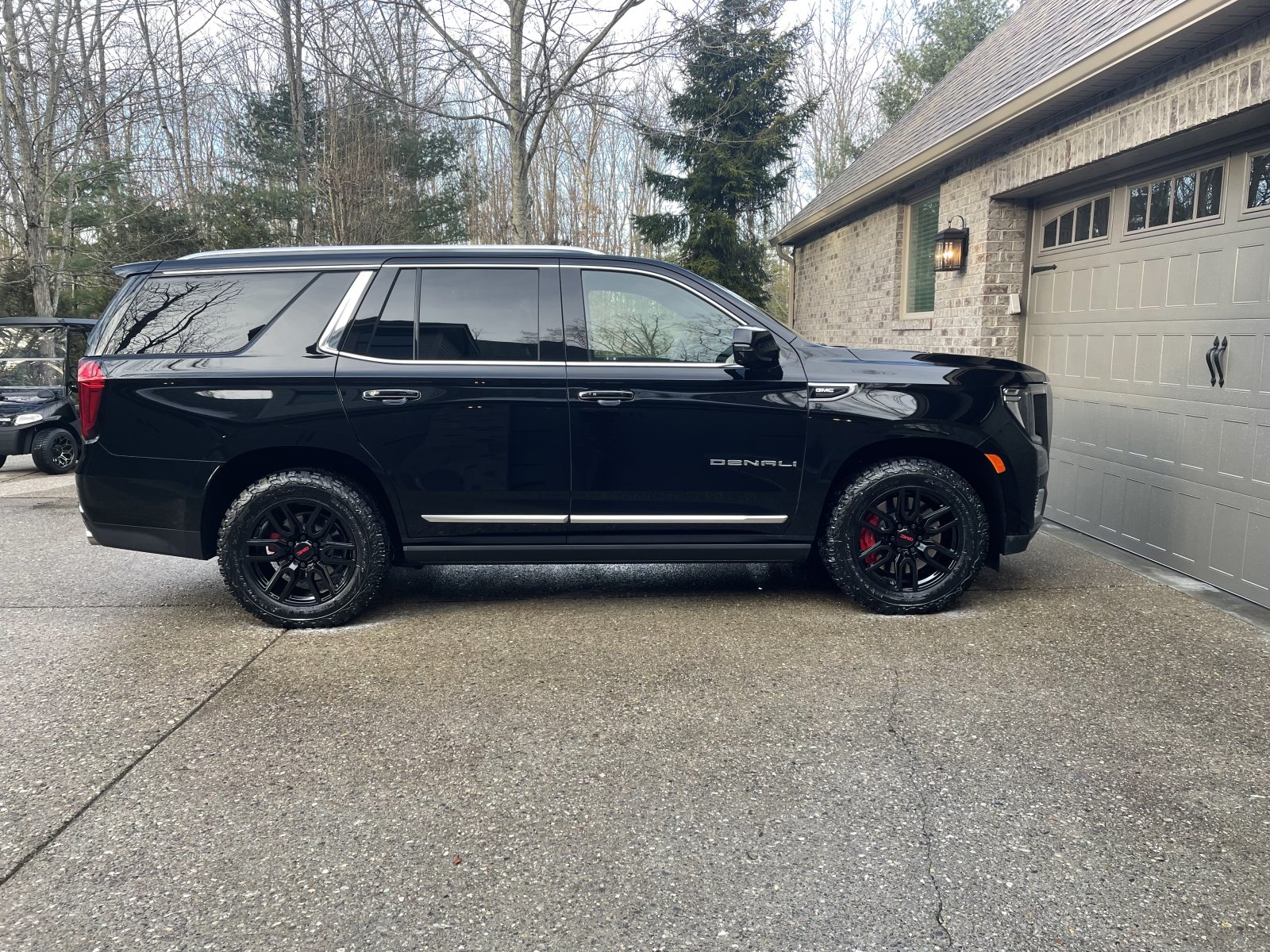

The photo shows my winter setup.
GM Take off 20’s, actually they are replica wheels I purchased on eBay for a $1000. Then mounted the factory AT4/Z71 tire size 275/60R20 in the BFG ATKO2. I have ran the BFG for 25 years and am a huge fan.
In the summer we run the stock 22” black wheels and the Alenza’s.

Alenza’s are terrible in snow period. I know tire performance. They are not suitable to stop or have lateral traction. We also have a 21 Denali Ultimate. I put BFG’s and 20 inch take offs on it during the winter. That thing turned into an absolute snow tank. It was incredible.
What tire setup is this? This look s GOOOOD!
