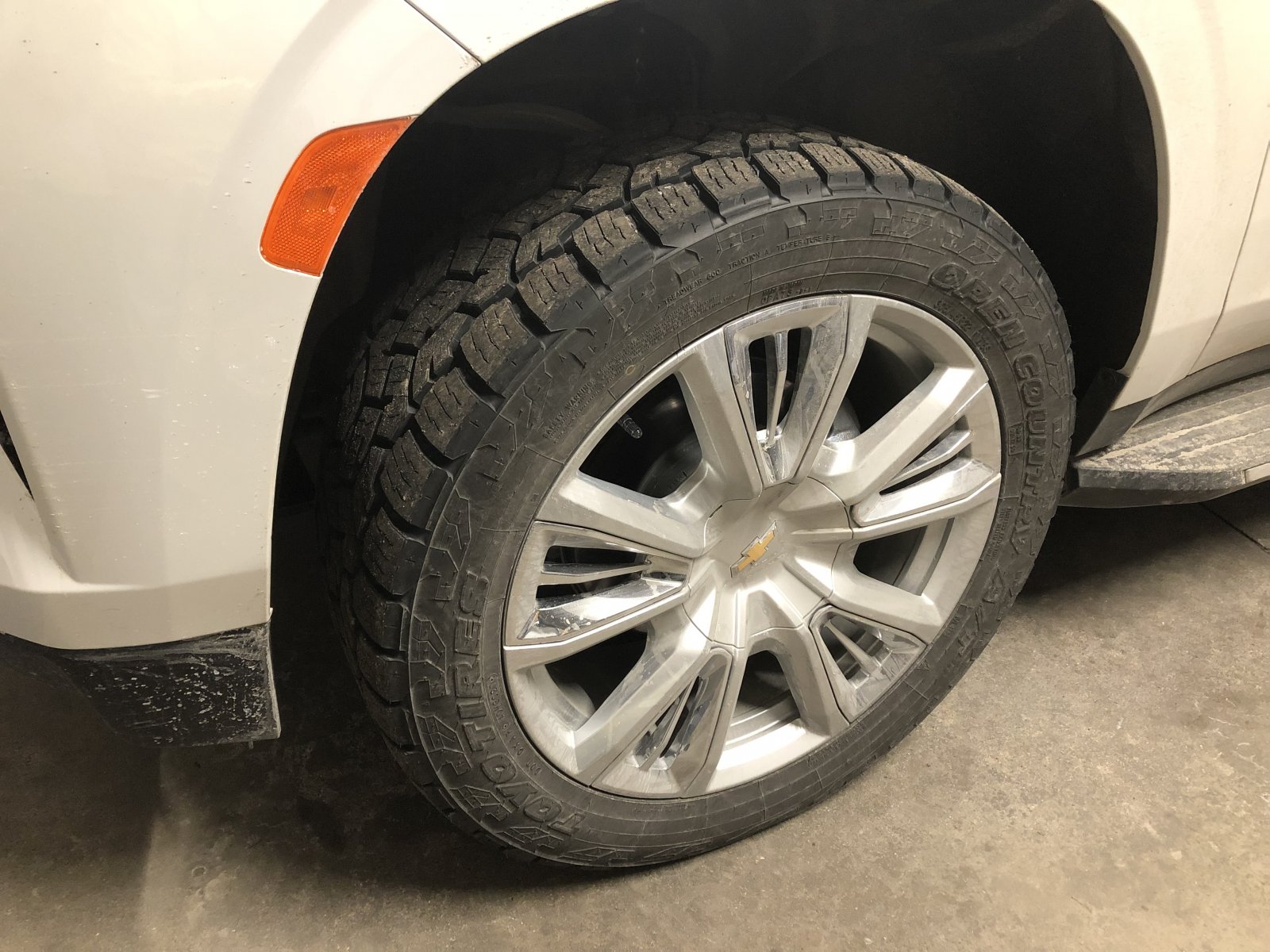

Well, its not the exact same wheels as hers is a high country, but they are 22’s with toyo at3 305/45/22. I have since leveled it up front, but that was not needed to clear the tires. Had no rubbing issues at all at stock height. It does not have the air suspension…however i have read someone who stated they had the same size tires with air and have no rubbing at any height setting.

Well, its not the exact same wheels as hers is a high country, but they are 22’s with toyo at3 305/45/22. I have since leveled it up front, but that was not needed to clear the tires. Had no rubbing issues at all at stock height. It does not have the air suspension…however i have read someone who stated they had the same size tires with air and have no rubbing at any height setting. View attachment 362273
Great, thanks so much. Looks good. Now if they weren't $438 a piece!

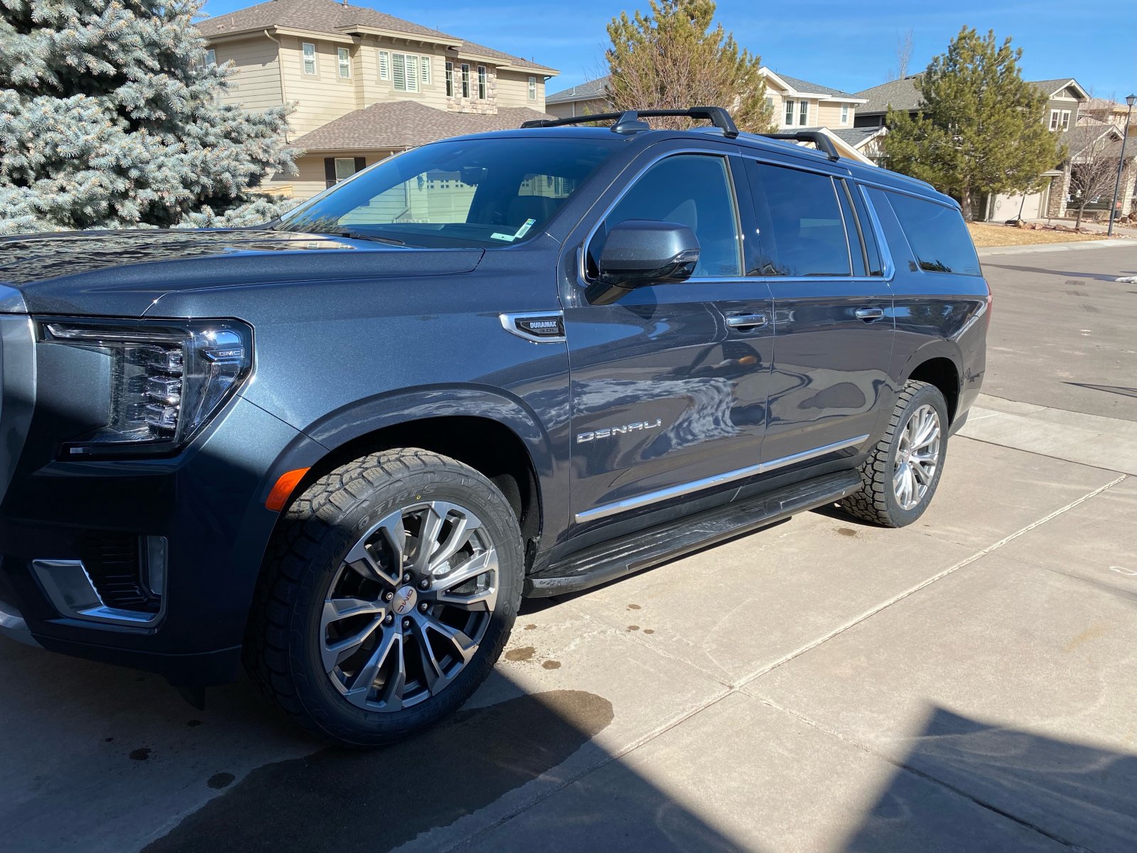

The 305 45 22 Toyo Open Country AT3s fit perfectly no issues. Looks good too.
