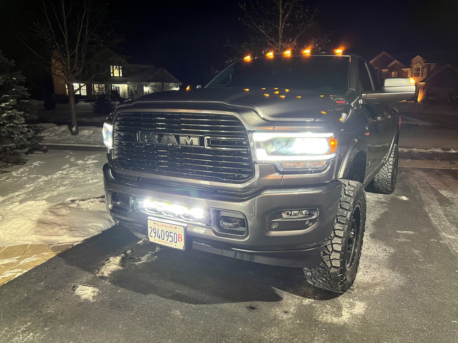

On my Ram I have a Baja Designs Onx6 20" that works awesome. I'm thinking same light bar would be a good fit.

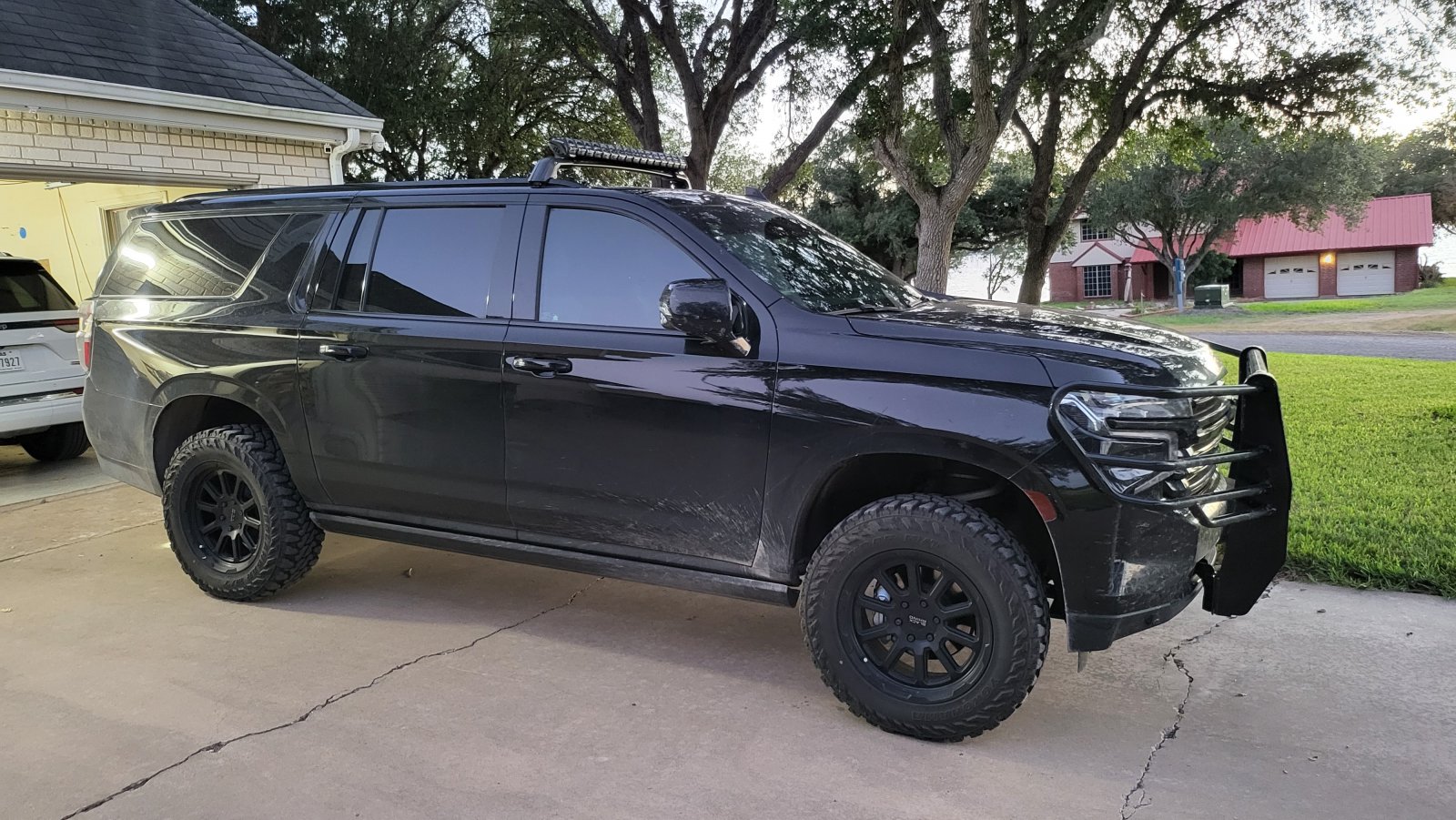

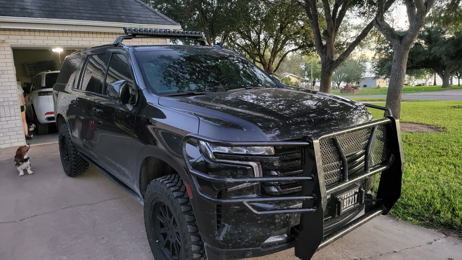

Well, my attempt to mount my 40" Rigid Adapt Light Bar is under way. Roof rack crossbar as the holder for this heavy light bar. Got it finally bolted down and temporarily installed it to see if I liked it or it looked stupid. Jury in my mind is still out. Pics aren't that great as I was running out of daylight.. It definitely sits high as the cross arms are pretty tall to begin with. It also can double as clearance lights Still need to put the rear crossbar on

Well, my attempt to mount my 40" Rigid Adapt Light Bar is under way. Roof rack crossbar as the holder for this heavy light bar. Got it finally bolted down and temporarily installed it to see if I liked it or it looked stupid. Jury in my mind is still out. Pics aren't that great as I was running out of daylight.. It definitely sits high as the cross arms are pretty tall to begin with. It also can double as clearance lights Still need to put the rear crossbar onView attachment 380956View attachment 380958View attachment 380957View attachment 380959
Im in the looks stupid camp, way too high. besides thats gotta produce a ton of wind noise

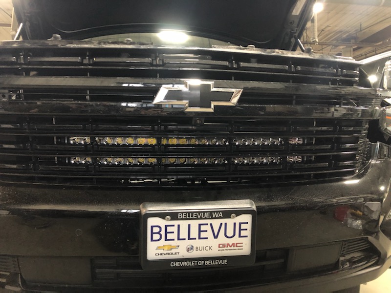

This is on a 22 Chevy 1500, and will soon be done the same on my 22 Tahoe LT.
Pull the front grille assembly off, and basically there is the perfect spot for 1 or more single row 30" curve light bars. VisionX are the ones In these pictures. Basically there is a center bar that has to be cut out, and then 2 bars fabricated & painted in which the light bars mount to, then wire in and put the grille assembly back on.
Local shop quoted $2400 for what you see here. Being a GM technician myself, it sounds crazily overpriced, until you attempt to do it yourself and cook one or more modules and have to pay for that, when and if you can buy one.

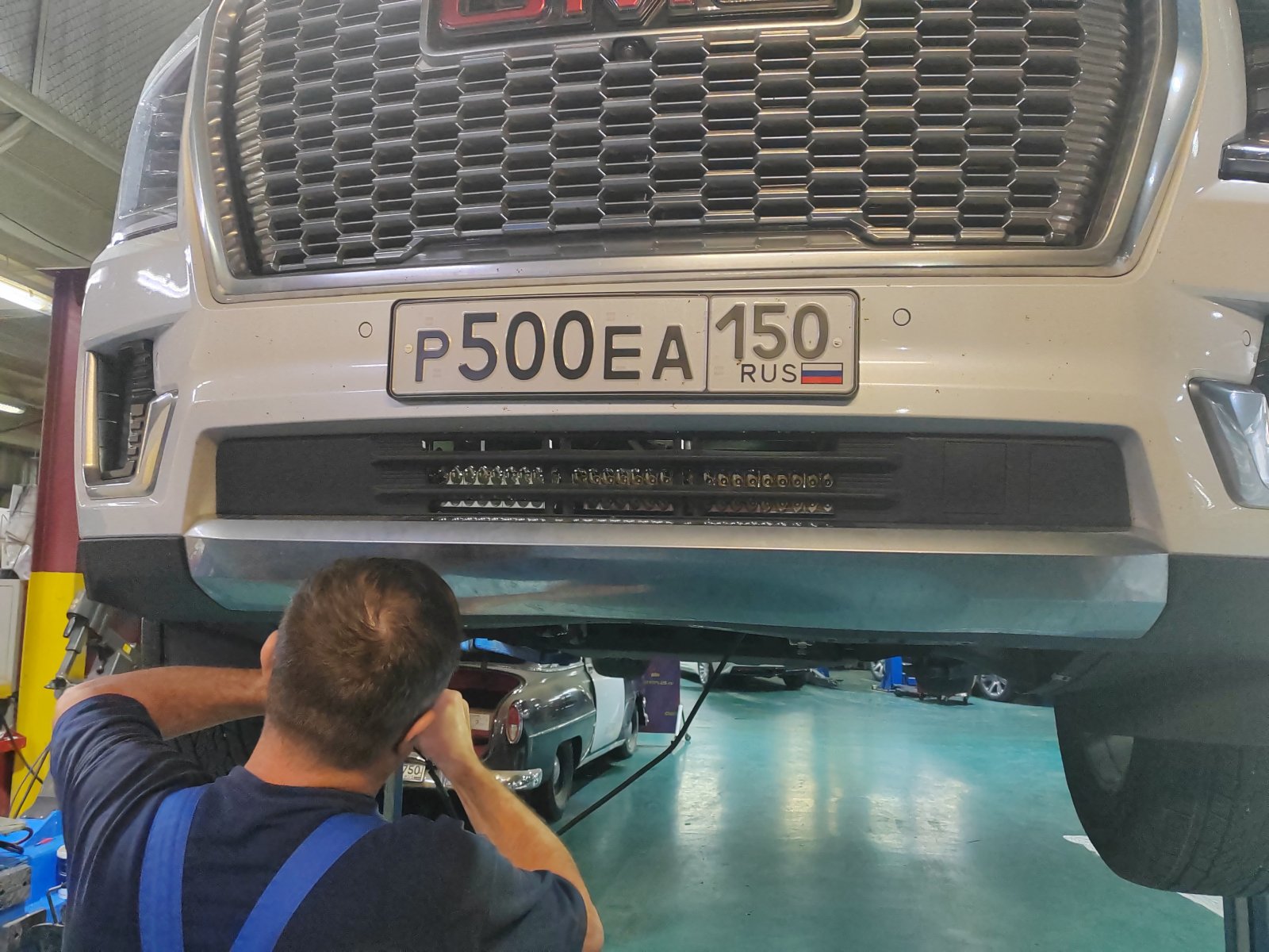

I installed LEDbar on Yukon 2022.

If you have a Tahoe 21+, then like me this space is hidden by a cover that is simply removed. there is no need to cut anything. This space is used in diesel cars for the intercooler.

I loved your led light solution here and I picked up the same light bar to duplicate your design. I’m curious, any notes you can offer on the install? Do I need to develop something custom? Is this simply a drill into an existing support? Thanks in advance for any advice. Mike
Yes, you need to make a metal frame there, to which you can attach the diode beam. This place is just a bit loose, and the beam will start shaking a lot. The service center made me a metal structure that connects the vertical supports, and the beam is attached to this structure. And also, be sure to stick a protective film on the glass of the beam, this is the place where a lot of sand flies.
Here is my high beam, in the distance the road is probably visible 2-3 kilometers away. But here I also have the standard headlights redesigned:)

You wouldn’t happen to have any specs or pics of the metal frame by chance to share? Also curious on the placement of the switch inside. Any cool ideas? Thanks in advance! Mike
Unfortunately, there are no dimensions of the frame. The button is in the cabin, in plastic near the right leg. It was connected according to the activation scheme. Power was taken from the battery. And then we connected to the high beam plus through the activator button. It turns out that when the button is turned on, the beam shines along with the high beam, when it is turned out, the high beam works without the beam.
