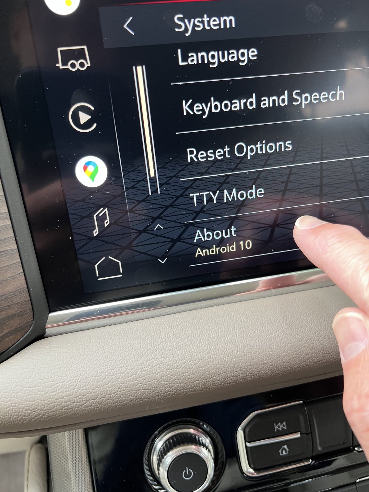

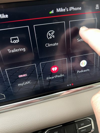

Where can I find my software version?
Checked infotainment screens, couldn't find it.
This moving presets thing is driving me crazy.
TIA
WalleyeMikeIII
Feb 22, 2022
2,753
2,618
Sunny and Snowy Minnesota
Hit Home -> Settings —> System -> About
Then scroll down to see the version info.
The 163 is the version number for mine, and is what is referred to in the TSB’s

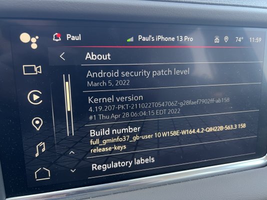

Ok, just got done at dealer. Apparently service writer misspoke and it’s W164
22-NA-142
One thing I noticed right away is the google icons are monochrome! I love it. It matches the rest of the ui. Security patch up to March ‘22 as well.
It’s funny, this week my radio stations started jumping around while I was listening. Never had that before, let’s see how this new firmware works out.
