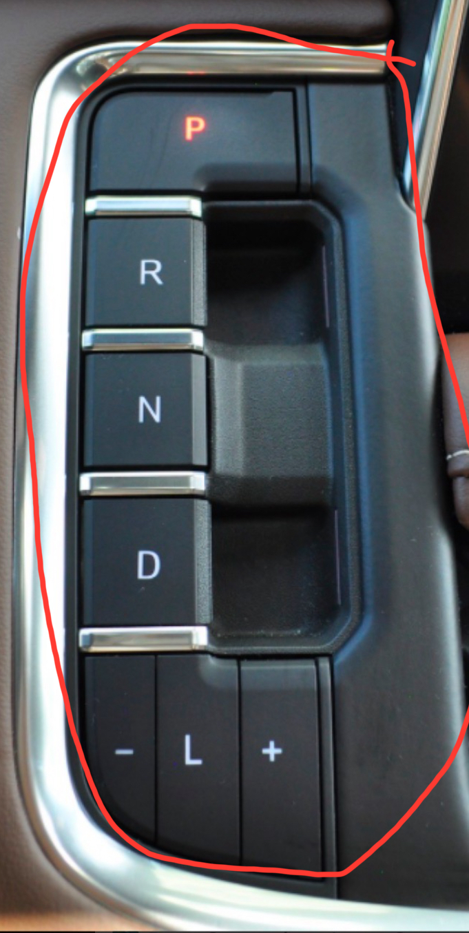

So my wife drives a 2021 Tahoe LT and one day while she was driving she got an alert saying to “service transmission may not shift soon” but it had cleared the next time she turned on the vehicle. We took it to a reliable transmission repair shop and they found nothing wrong. A month later she was driving and a bunch of other codes were thrown. We took it to the dealership and it was a bad battery, but there was also the transmission shifter module was sending a fault code. This was because her D button (pretty crappy after I researched) on her gear shifter had popped off and all we saw was the red light in its place. We never had any trouble shifting but we had to get a whole new part which was about $1100. Since then, no more shift codes. Of course I wanted to glue the old one back on but my wife had threw it away already. And after they replaced it the mechanic did say they had to perform some software update to the ecm.

When I test drove my 21 Suburban, last summer. The first time I used the shifter, the drive button popped off. The reverse also did that. After I bought the truck, I glued the buttons down, so they don't pop off anymore. I never had a problem when they came off, it was more of a nuisance. It has been fine ever since.
