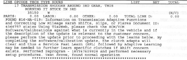

Update: finally got the Tahoe back with 653 MI after their test drive. Service advisor gave us a warning before handing the keys over. He said that the one two shift is going to be really hard for a little while, until everything settles, and the trans "relearns" how to shift again. I found that a bit odd, so I asked him why. he stated because it's a brand new electronic valve body and the transmission was completely flushed of fluid and refilled with "better" fluid. He said he was told by the troubleshooters that it is normal. Not sure I completely agree with that because we got the car with 20 miles on it, and it ran just fine, until it didn't. [emoji2363]

There will be some "relearning" but that is normal for most modern vehicles. The "learning" is based somewhat on the type of driving the driver does. It's a balance of driver input through the ECM and transmission control electronics. Not sure that technical names for all electronics involved. It will adjust the shift points. This should not really be noticeable in most cases.
I call BS on adding a "better Fluid". I would ask what the "better Fluid" is. As a lubricant engineer and owner of an oil analysis laboratory, I wold love to know what their idea of "better fluid" is.

It’s possible that it since it initially learned when it had a bad valve body, it was adding line pressure to compensate and now it has a valve body that’s doing its job properly so the added line pressure is causing a hard shift until it re-learns if that makes sense. I know on the older (4l60 etc) transmissions there was supposedly a way to reset the adaptive learning but plenty of times this wasn’t done so when you got a new trans to replace a worn-out one it would shift weird for a bit. Hope things work out, you shouldn’t have to be going through this.

Definitely will have to relearn but it usually doesn't take many miles for that to sort out (less than 50, more like 20). I had a Colorado with the 8sp issues and it went through a torque converter and had to relearn. Then it had to have the fluid swapped out for the better fluid to fight the shudder issues with the 8sp that it had originally. When GM changed spec to Mobil1 LV ATF HP it made the trans much better.
I never thought of it that way but it makes total sense that that's why it's shifting hard [emoji1417] thank you!!
