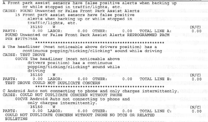

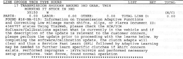

I'll be watching this thread. Just had my transmission "reprogrammed" on Friday per TSB 16-NA-019. Which I find odd because that TSB appears to be for model years 2016 - 2017, but that's what it shows on service report. Of course, I have no clue how TSBs work..
Below are some other items from Fridays service. They were able to fix my park assist by reprogramming the
PACM.
