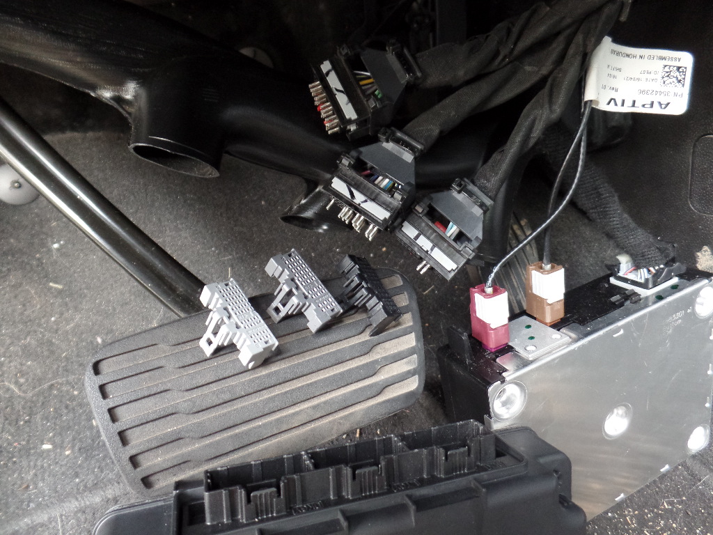

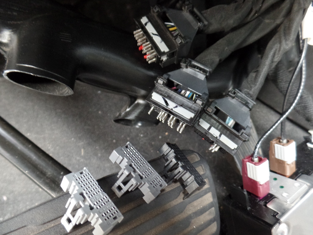

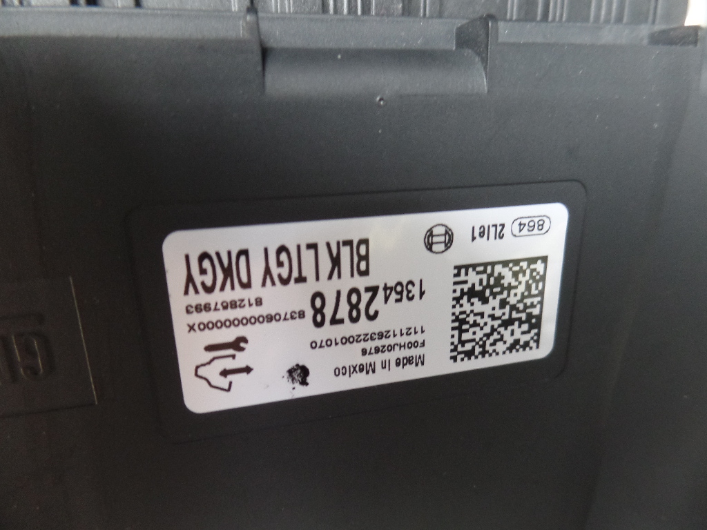

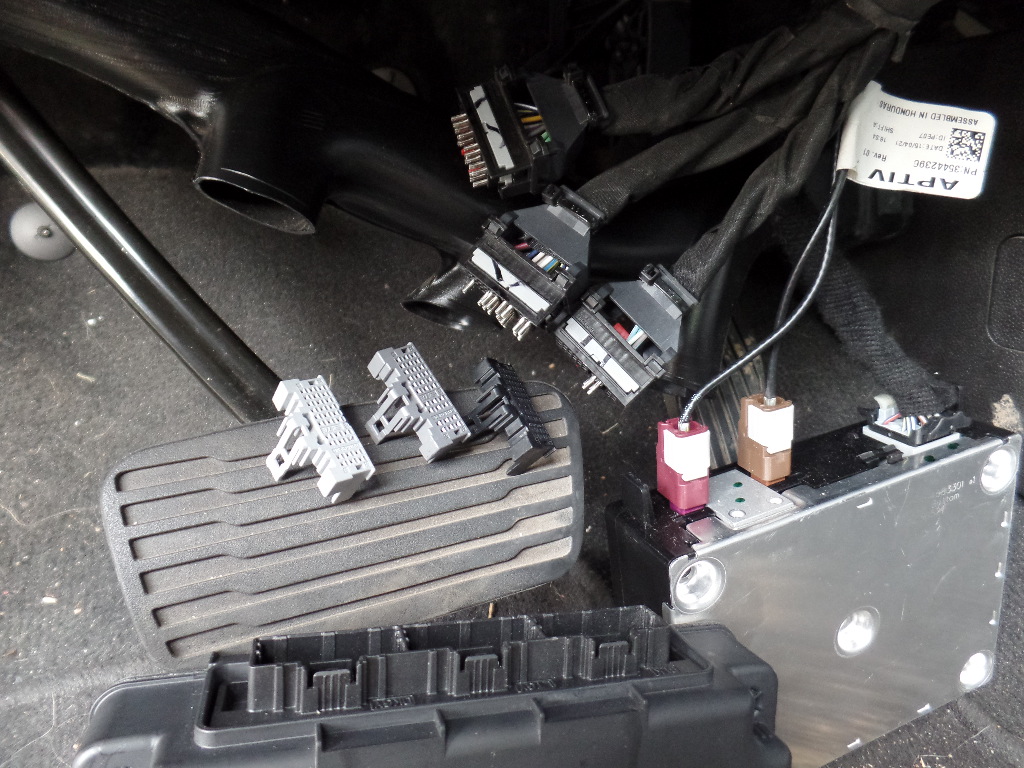

Hello, I need help, while working under the dash, I disconnected the 13542878 Network Gateway Control Module, unfortunately while doing so, the colored plastic guide for the connectors stayed in the module (separating from the actual connector plugs) and now I have no idea how to reattach them and connect them back in the module and possibly shorting the module out.
Does anyone have a close up view of the wiring harness connectors showing wires so I can identify the wires, match them with their respecting Plastic colored guide ( Black, dark grey, and light grey)
Thanks a lot to anyone that can help . That module is located under the dash on driver side.

those plastic clips are slotted to only fit in one slot, they should clip back on and then just re-attach.
no picture of the male end on the module so you'll have to make a self-determination of which one goes where

Thank you, that helped but now i have 2 plugs left to do. I have a 50/50 chance to get it right or maybe fry something :). I have found a 2021 at a wrecking yard and they said I could go Monday and look for myself, the only issue it's 45 miles away but I have no choice.

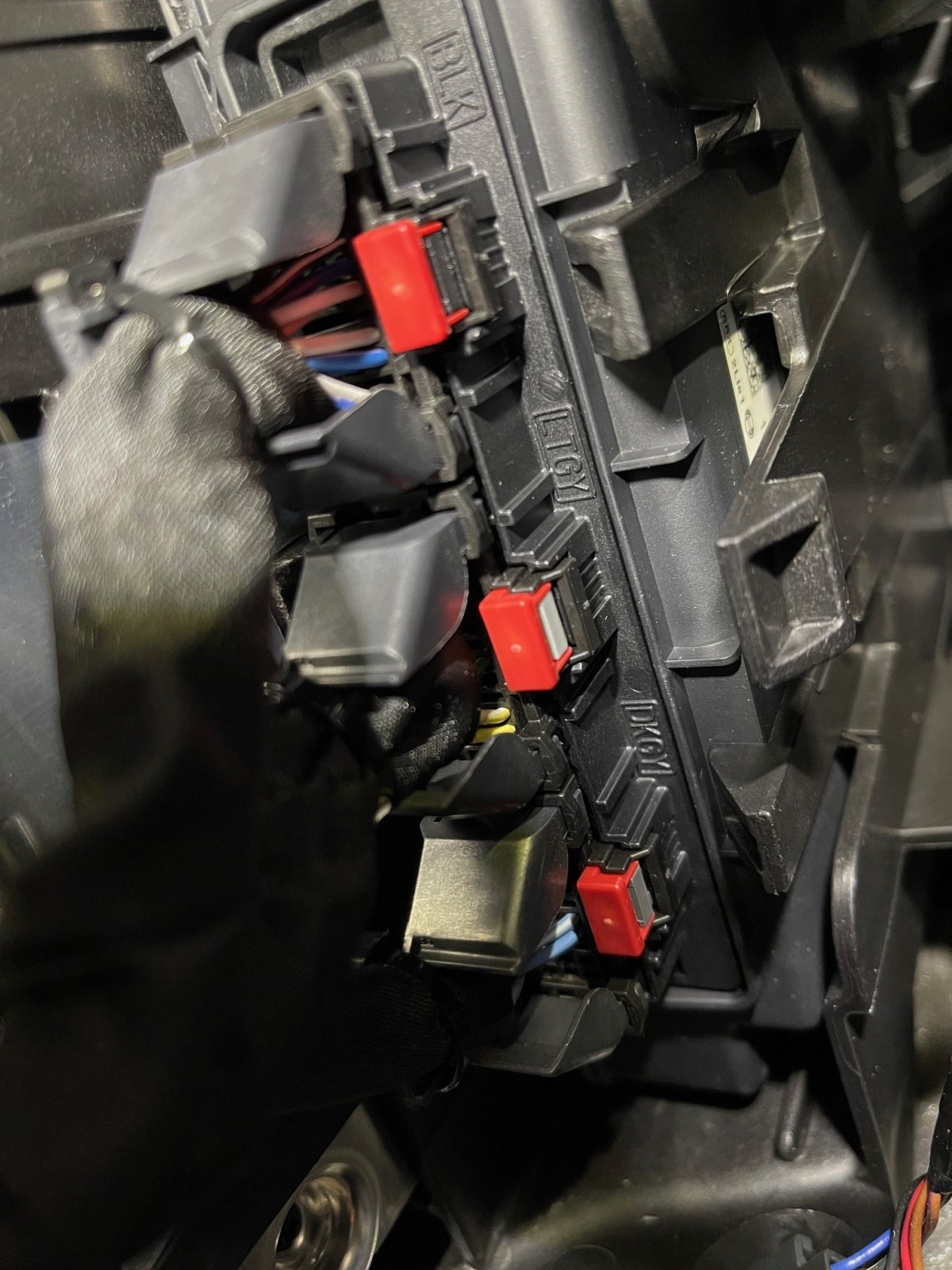

Here's the wiring in my '22 Yukon XL SLE - The module is labeled with "BLK" - "LTGY" - "DKGY" left to right for the different connector colors.
The LH ("BLK") looks to be the most populated pin count connector with the middle having less pins and the right has only about four pins.
Hope this helps you out.
