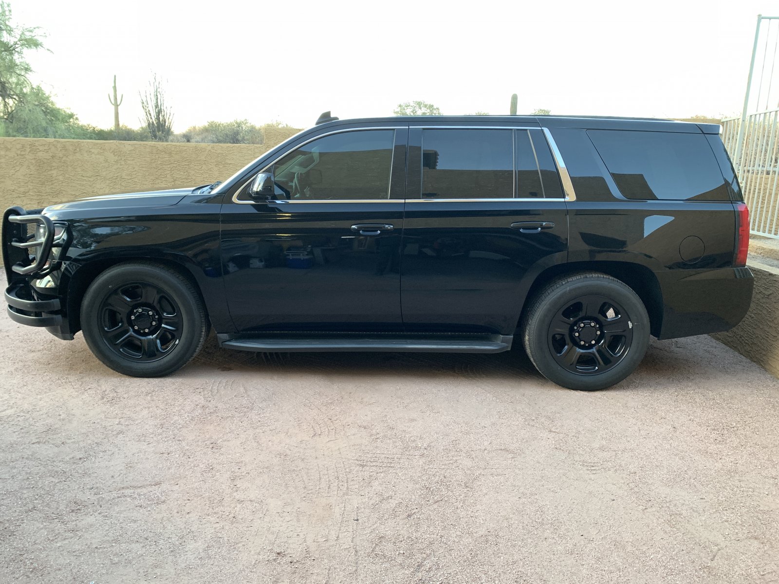

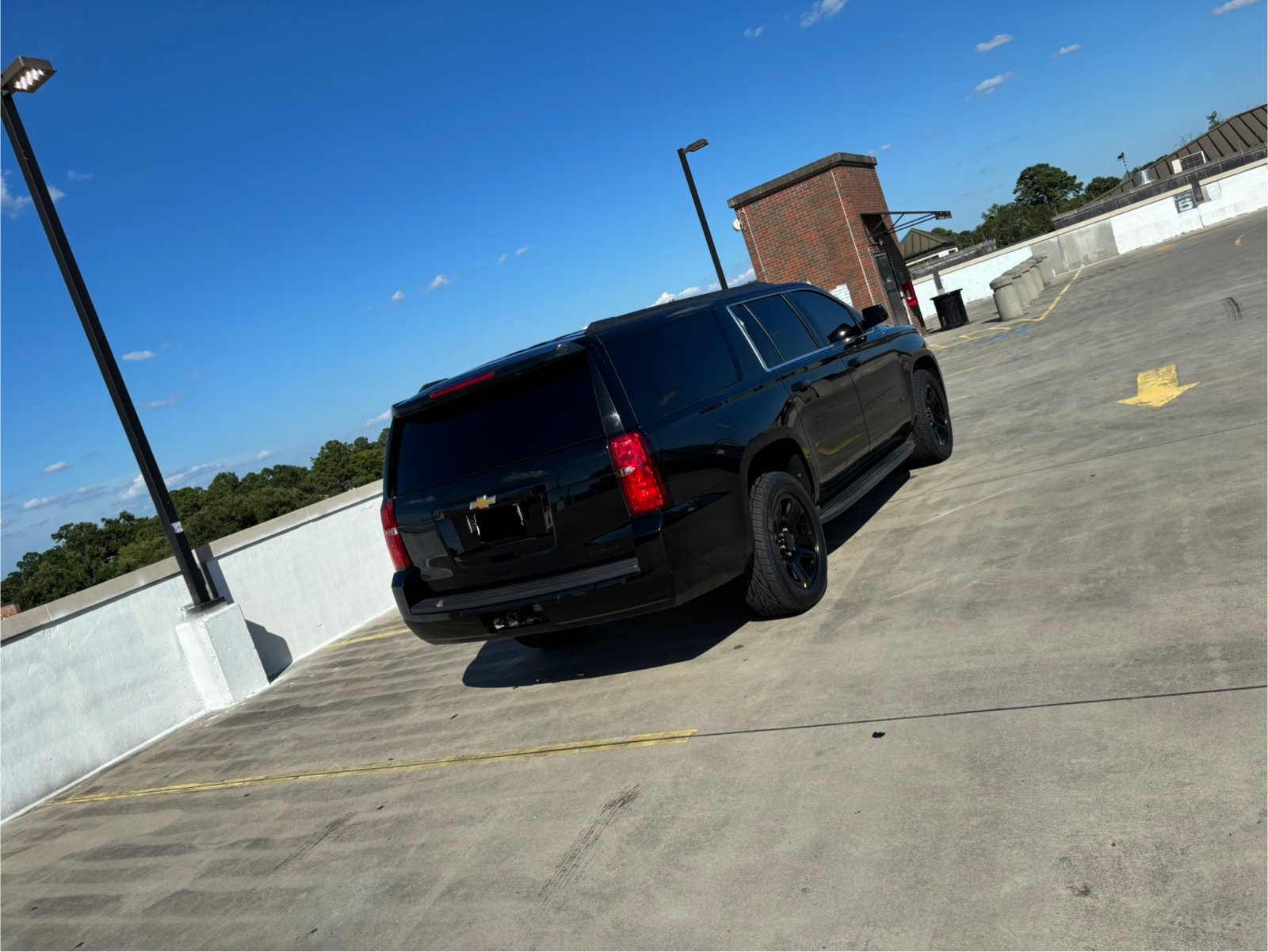

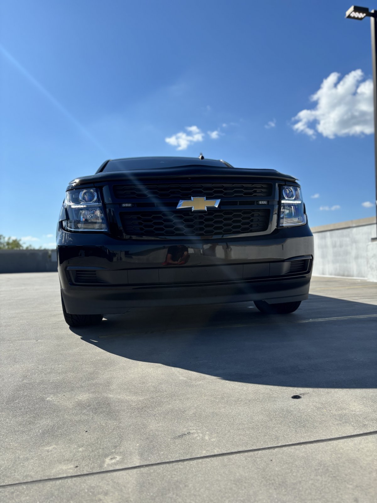

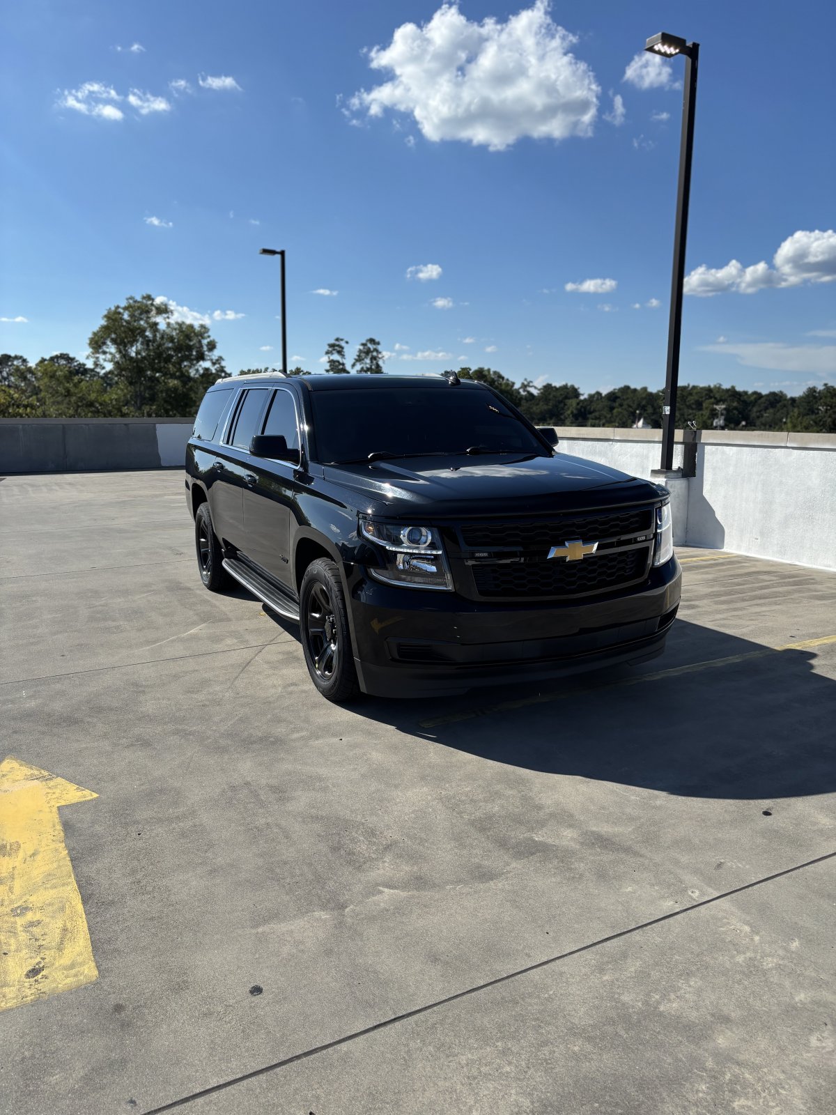

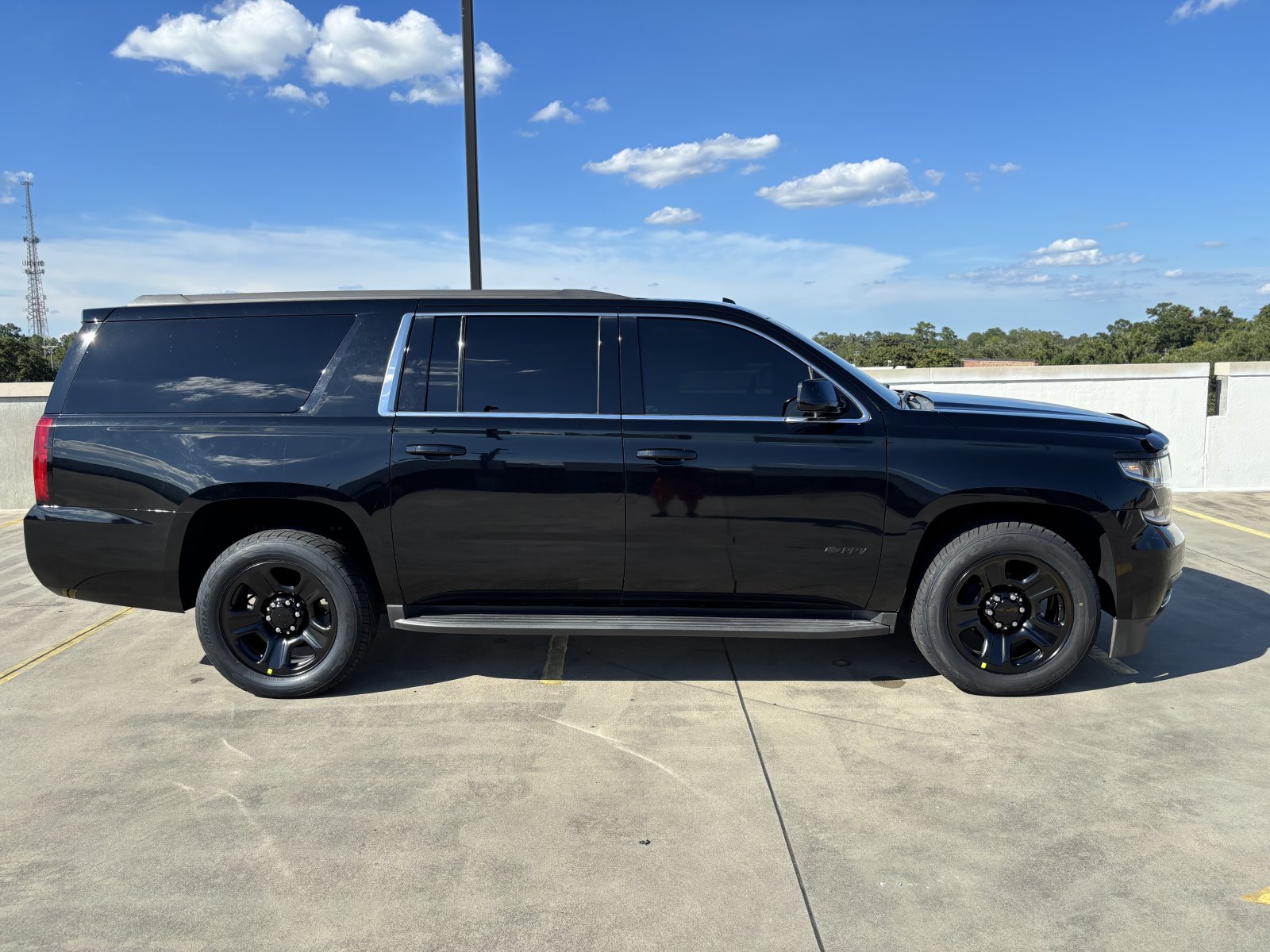

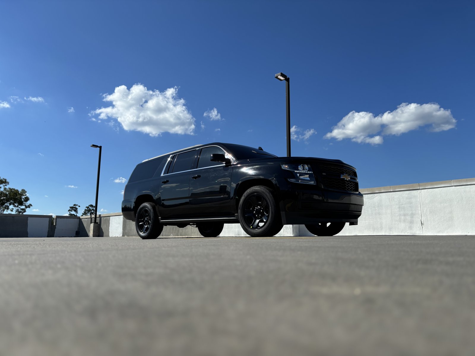

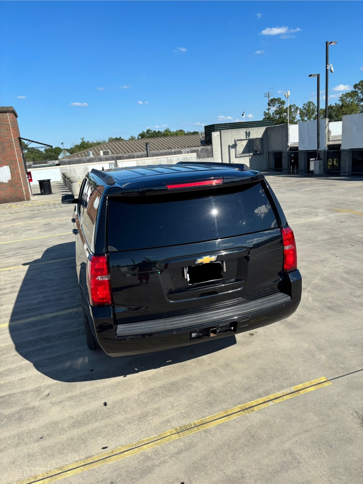

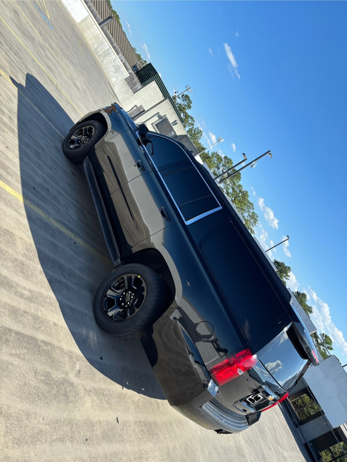

The 2021+ PPV tahoe rims will fit just fine on any previous 2020 and prior body style. They are 20 inch rims so it fills the gap up much better. Then with these rims on you can fit the 6 piston brembo PPV calipers with no fitmet issues.

That looks great! , I would def throw a set of winter tires on those wheels for myself

I want to do the drop myself but do not know which kit or parts to use. Can u list yours please.
I used the full Belltech lowering kit that contained the drop spindles, springs, shocks and the other hardware to perform the swap. At the same time I installed the factory Brembo 6 piston front calipers and rotors along with the ‘21+ factory ppv 20” steel wheels. With almost 26k miles are her since the install I am still happy with my decision.

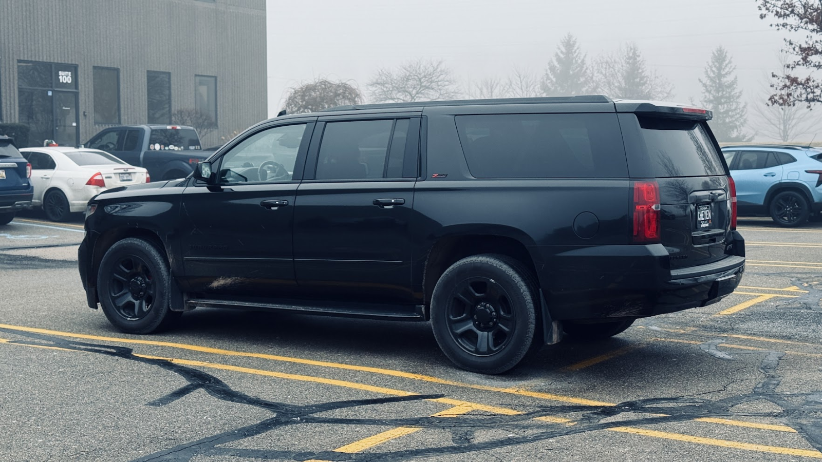

I was considering the 20" PPV steel wheels for my winter set on my 25 High Country. Just looking for feedback from previous owners with stock 22" wheels on how the vehicle handled or operated after dropping to the 20" steel wheels?
Any codes thrown or handling issues?

That does look nice. I am still amazed at the weight of the OEM 18" steelies. How to the 20's compare? We did the Beltech drop kit with just the spindles and rear springs. All is well and we didn't have to wrestle the front strut into submission.

They are silly heavy, even heavier than the 22" Premier wheels that came on my Suburban. I had them on for a few days just now and I just hated how slow they make the suburban feel, the braking feels like you are stopping on wet rotors and the steering is heavy as well, overall great for hitting curbs but not for anything else.
