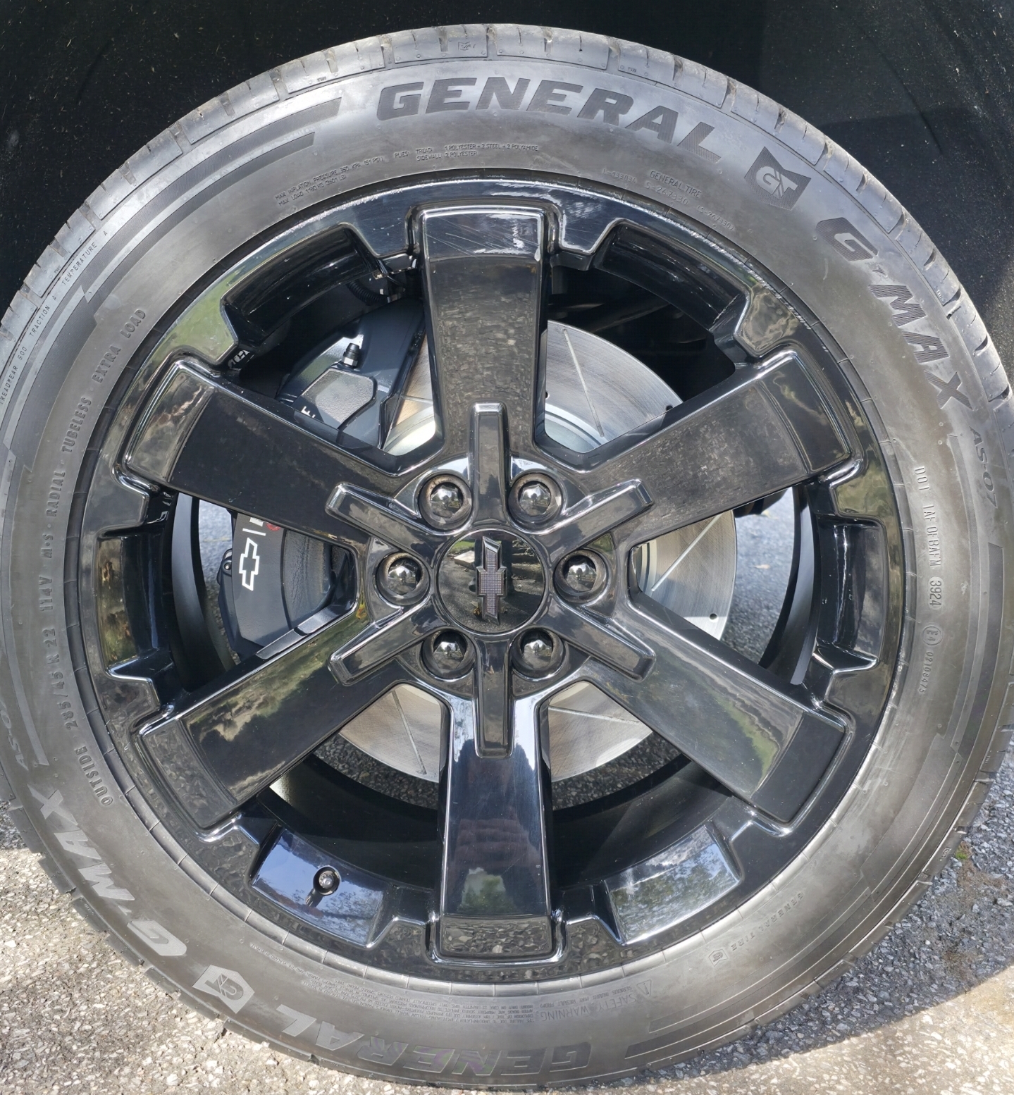

Idk why ppl are saying those rims clear thise calipers when I have those rims and they did not clear
