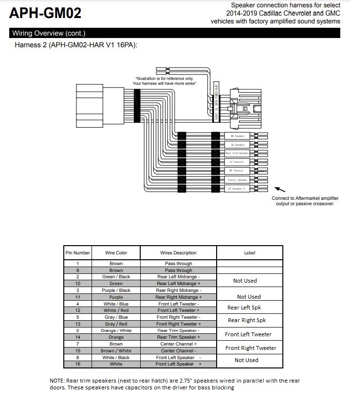

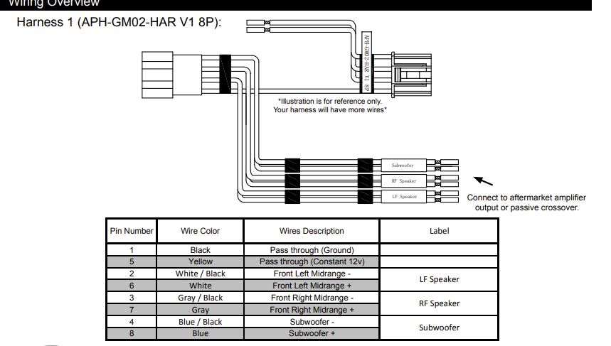

Today I decided to take a look at the Bose Wiring of my 2021 Z71 Tahoe. This vehicle is equipped with a 9 speaker audio system. (2 dash spk, 2 front door spk, 2 rear door speakers, 2 rear trim speakers, and a single 6.5" sub in the center arm rest). The amp is located on the rear left side fender well. If you remove the fuse/jack cover panel you will see it mounted to the fender well.
To there are three plugs that connect to the bottom of this amp. These will fit perfectly with the APH-GM02 harness offered by PACs. https://catalog.pac-audio.com/catalog/amplifier-integration-harness/aph-gm02
The wiring pinout listed for this harness is incorrect for this 2021 vehicle.
I tone generated the each of the speaker pairs and re-mapped the pinouts for anyone that would like to make their own harness to interface with this system. When an interface becomes available this would allow you to amplify your speakers without cutting factory wiring or give you a solid subwoofer output signal for an aftermarket sub. Please note you will need to disable ANC mics if you add a sub.

I did not need Harness 3. Please note the rear trim speakers are tied to the rear door speakers in parallel.

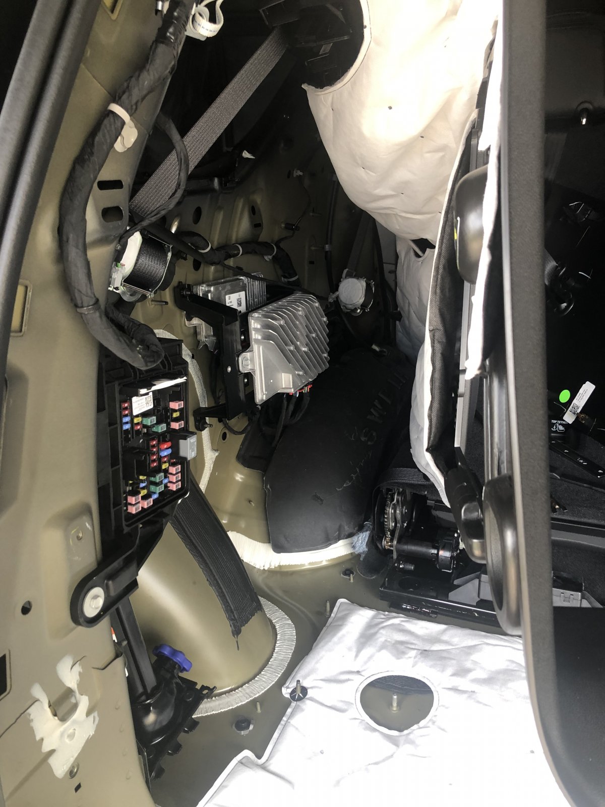

Question.....does anyone know what's behind the rear panel on the passenger side? I'm wondering if it's as open as the driver's side. JL just came out with a Stealthbox for the 21-up Tahoe's that fits next to the rear fuse box, but it's $1,100 and that's just the box and a 10" sub. If the passenger side is open, I'm looking to build something that I can tuck away in there. I know I can do it for less than a Grrr.
StephenPT
Jan 16, 2022
1,252
1,268
St. Helens, OR
Rear HVAC unit is back there along with parking sensor module and 110V inverter. Not nearly as much open space as on the LH side.

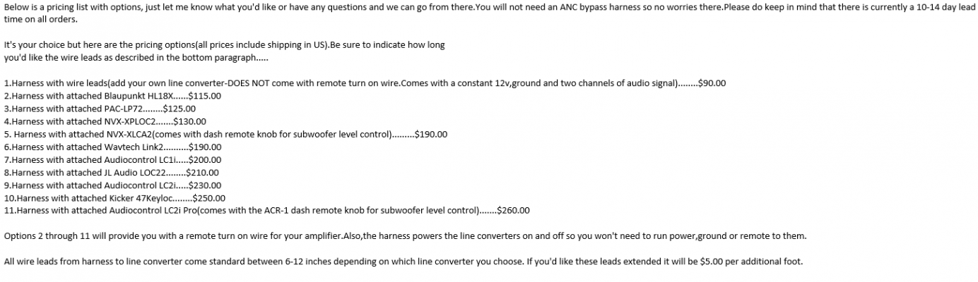

Reached out to John and just need to send him my RPO codes...will advise once more is known.
See the attached offered per my RPO codes. Just wanting to add on a monoblock Sundown amp and 1 X15 or ZV15"...so I think im going to go the #7 route.
