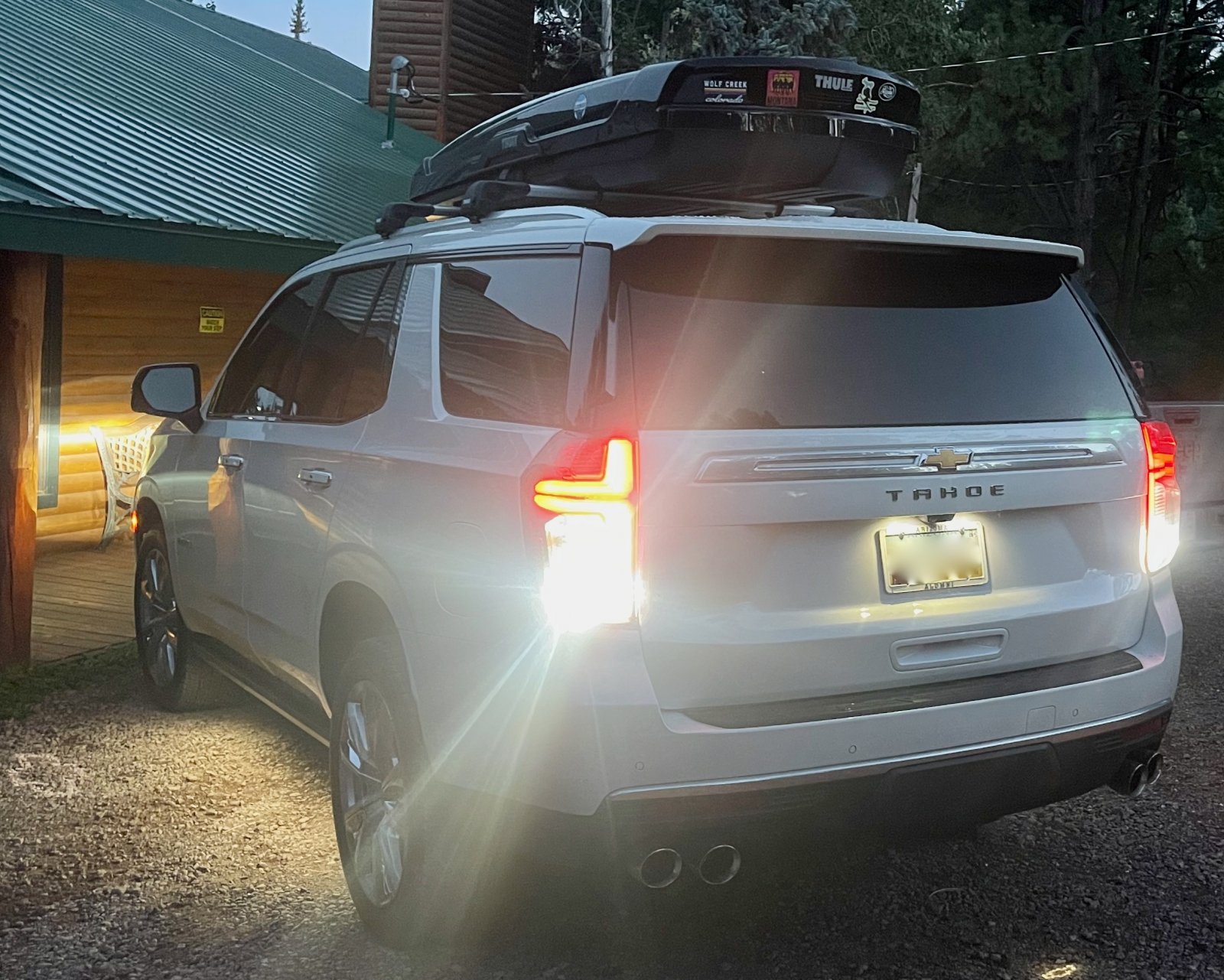

Hey guys, I made this video because I wasn't able to find much on replacing the crap filament bulbs. I ordered and tried a multitude of LEDs, this is what I found to be the best and cleanest. Hope this video helps cut down on your research and install time.

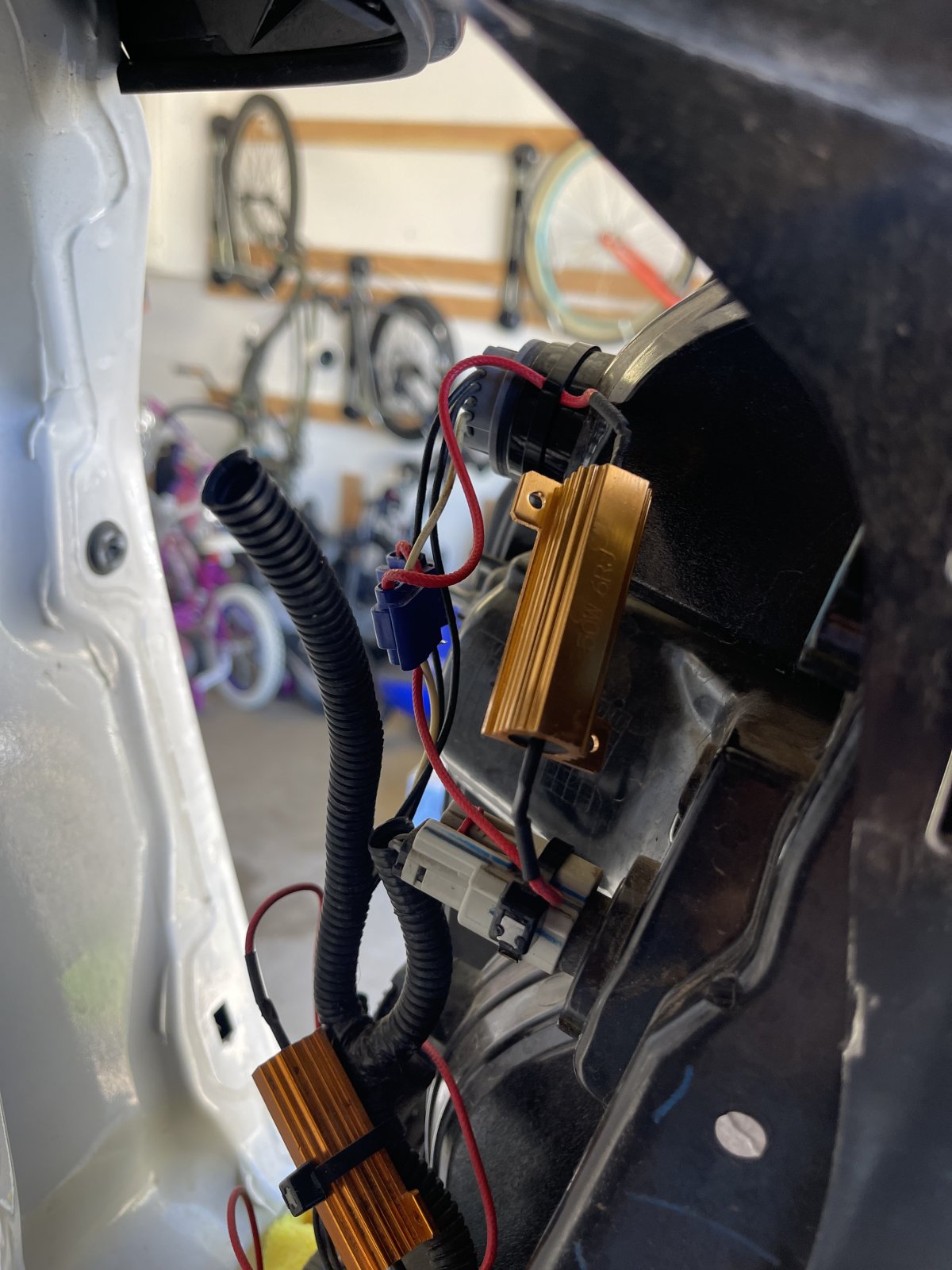

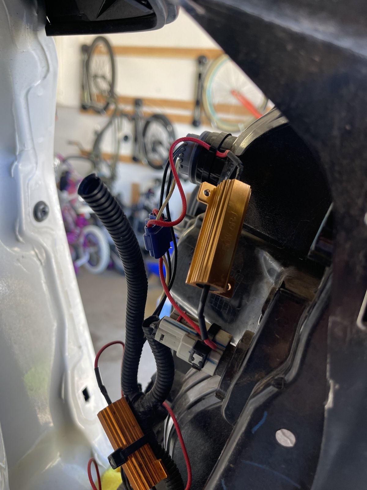

How hot do those resistors get. There is a forum member here that made a harness which direct connects to the harness outside of the vehicle. But as I understand it, the resistors get pretty hot

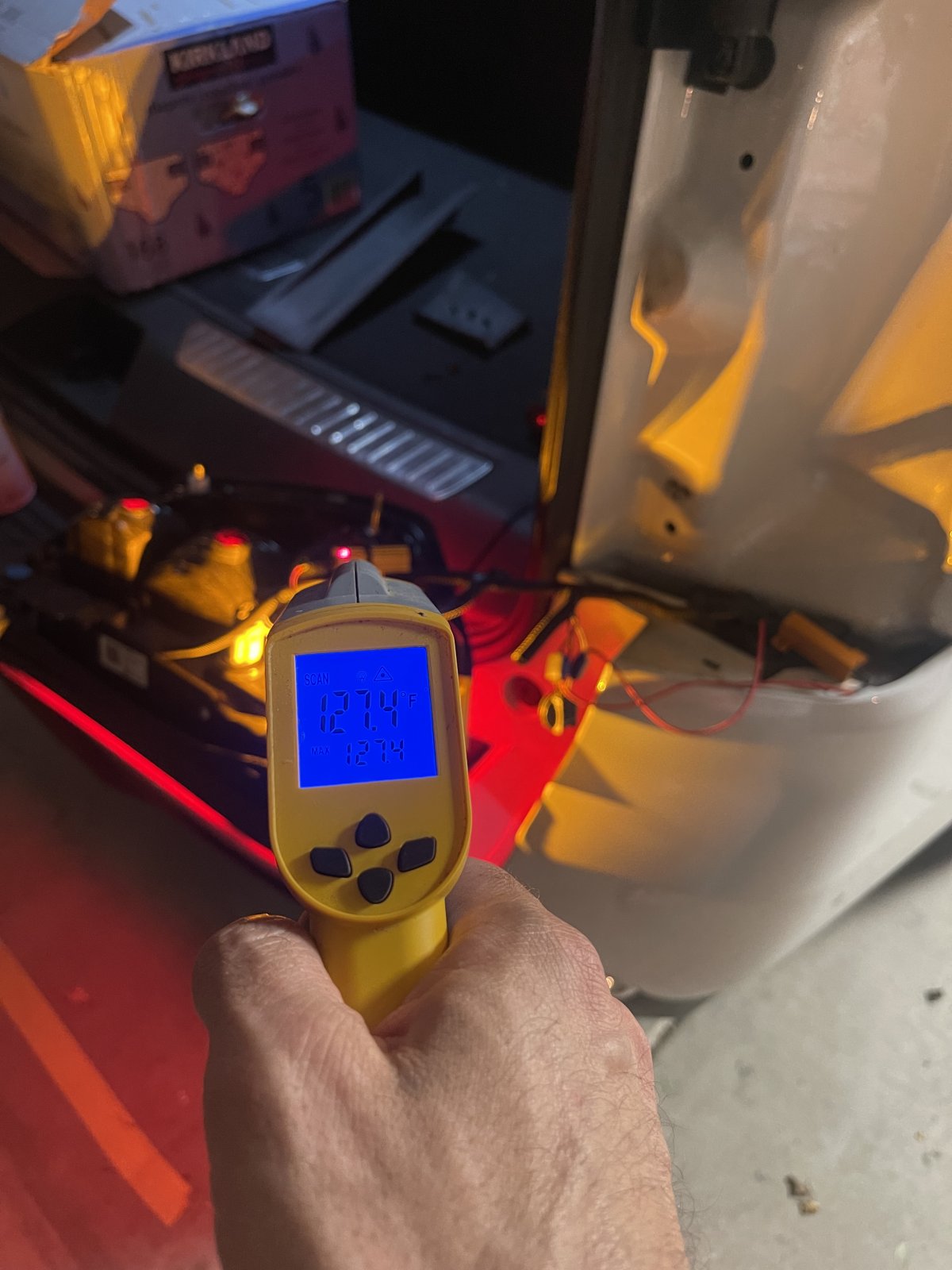

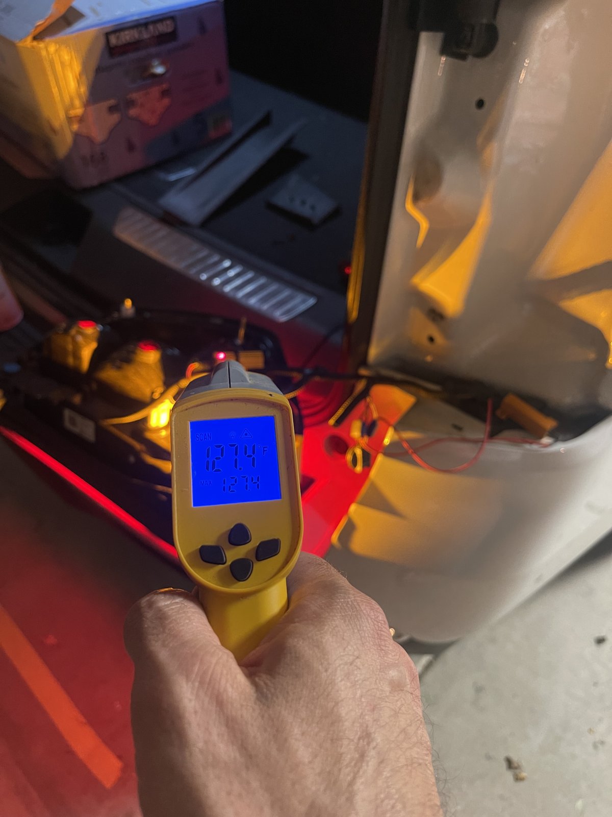

Ive seen these instances as well. Which is why I went with bulbs that have a heat sync built in. I used my temp gun and only got a 40 degree+ difference from Baseline after about 10 minutes of constant on use. My base was 110 (AZ) and when fired up the lights under heavy use it got to 160max average reading was 150.

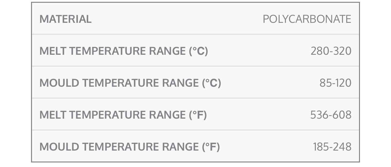

Just pulled it out and let the blinker run for a few mins, way longer than would happen in real driving. We are well bellow the mould point of the plastic used in the lights. Again my case is extreme. I live in a already very hot desert. See pics.

I would advise mounting the resistors on the body behind the housing, eventually they will melt the wiring, will take some time but eventually it will.
speaking from experience.
Floated the break resistor. Spent 1.5 hrs in bumper to bumper traffic. No melting… so far.
Takes time, it's not going to melt right away, might take a year. it was just a suggestion take it or leave it. I didn't think mine we're getting hot either but found out otherwise later on down the road
I’m taking it for sure. Thank you.
