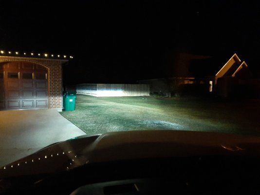

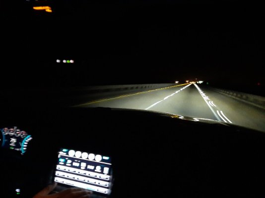

These are the Morimoto 2 Stroke 3.0 ( low beam mode)
Plug n play for a halogen replacement.
All fits within the factory rear cap as well.
I did adjust slightly and almost 1.5 yes and no complaints, Noone flashes

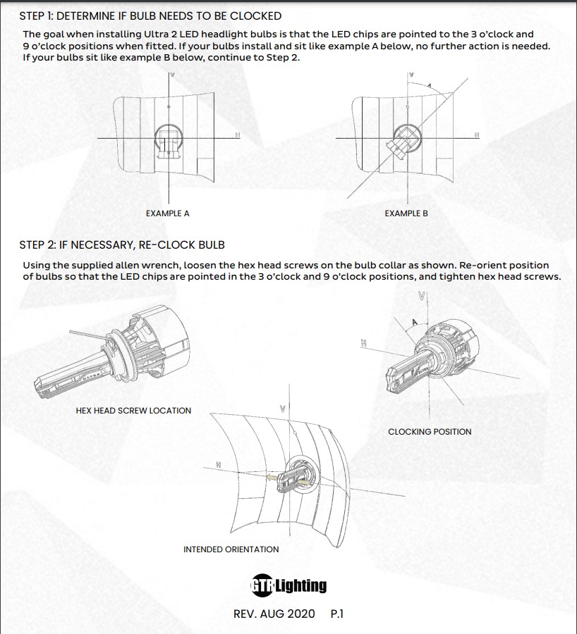

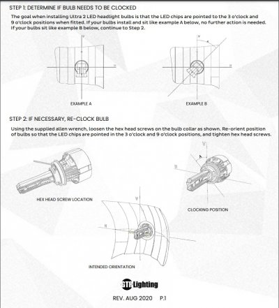

I bought GTR Ultra 2 LED headlights, after trying some others. Expensive, for sure, but it gives me the extra light beam distance and the light beam spread that I want.
Be sure to buy LEDs that are adjustable. The actual adjustment mechanism is different for different brands/models, but the instructions supplied with the LEDs (or an installation guide on their product web site) should guide you through the process.
Bottom line, the popsicle stick in the LED headlight holding the LED chips needs to be as close to vertical as possible, after installed and locked into place in the headlight housing, with the LED chips pointing to the 3 o'clock and 9 o'clock positions. The photo of the guide below, while maybe not for your specific brand/model, will give you a visual sense of how these LED headlights need to be positioned in a correct alignment within the headlight housing.
