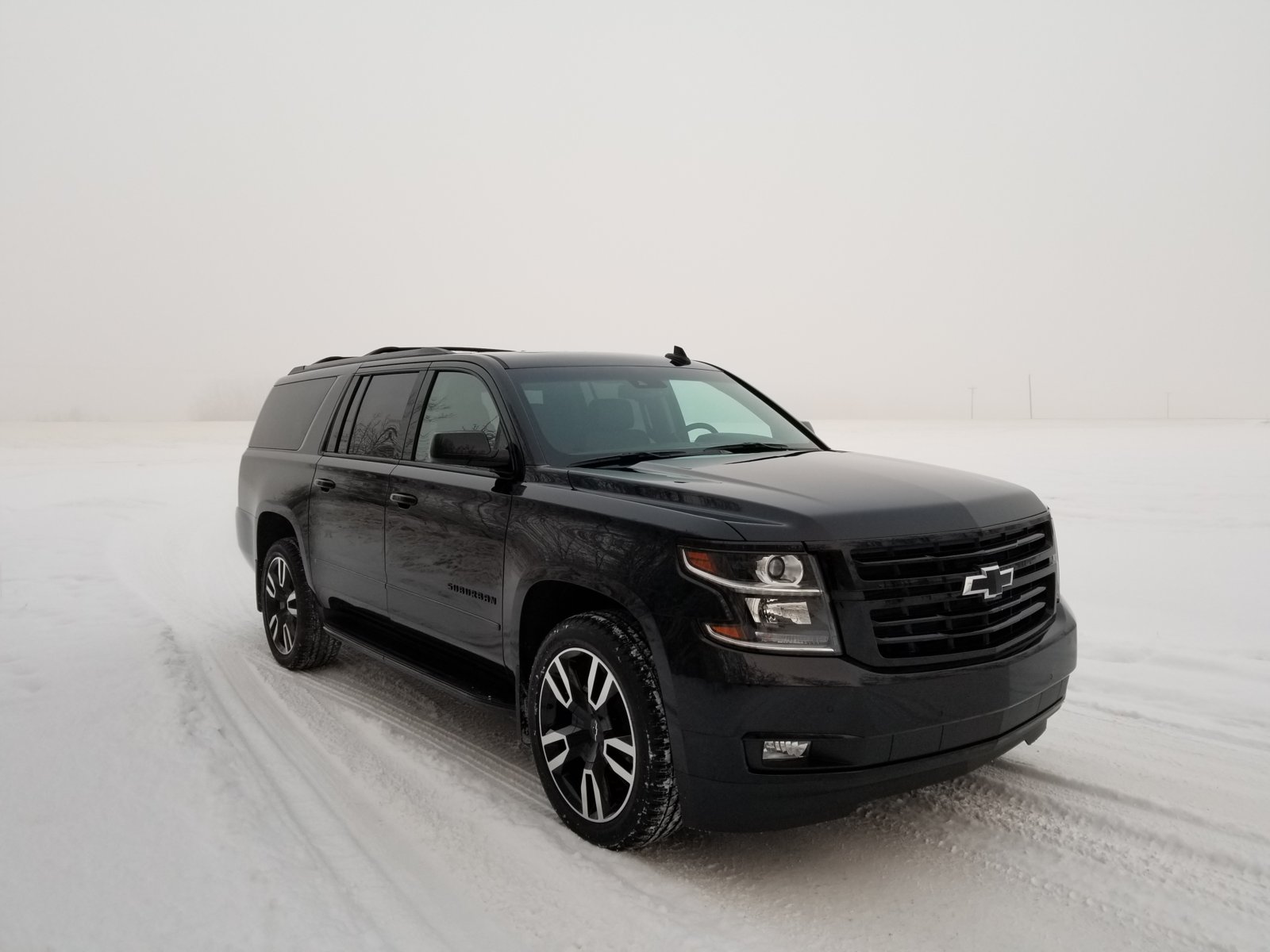

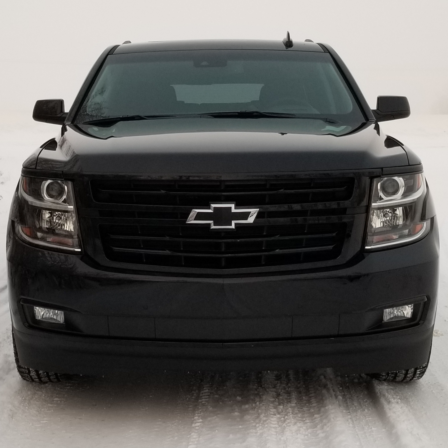

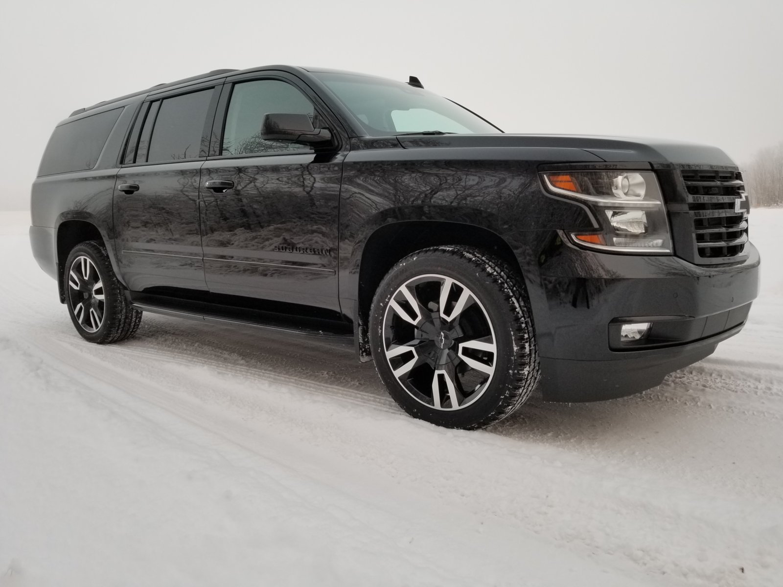

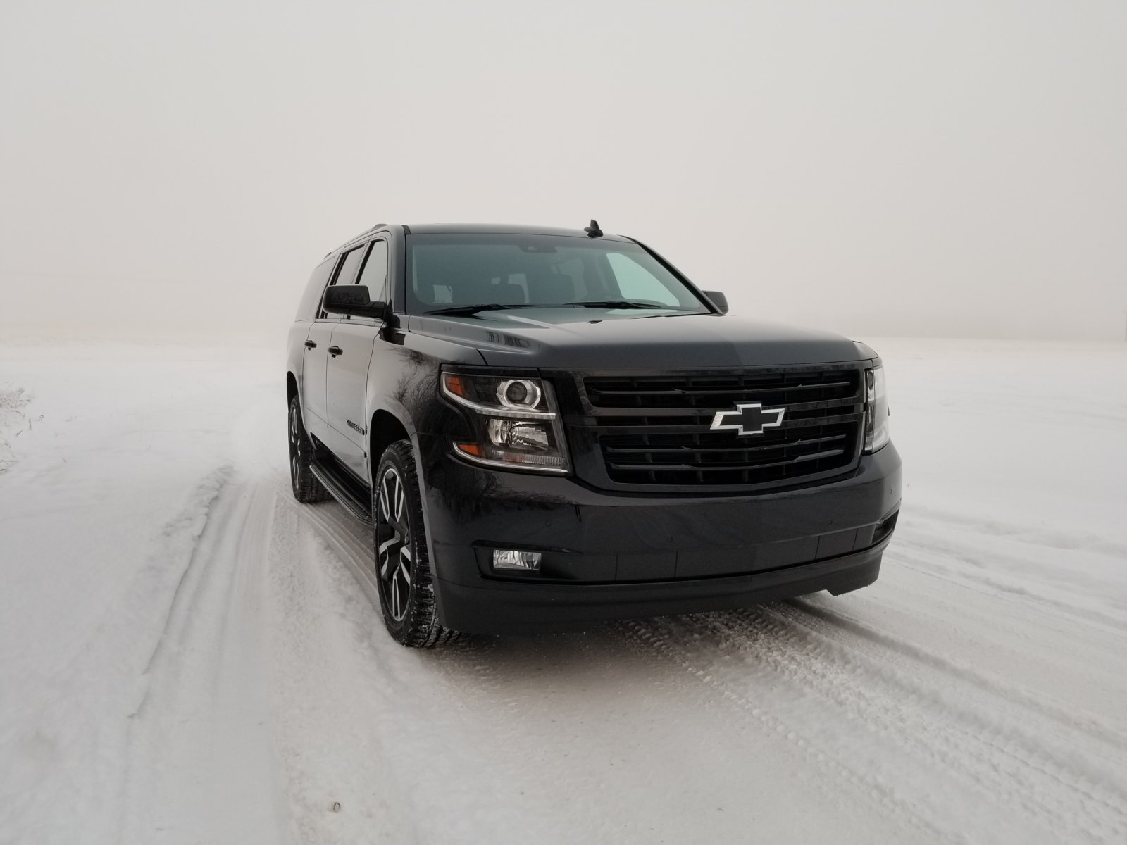

Finally picked up my RST. What a beauty! Rides like a dream compared to my lowered worn out Denali.
I'm waiting on OEM Black 20s and blizzaks before I put any miles on it. I'll be keeping the original wheels and tires for the summer.
It will be ceramic coated, tinted, LED Highs and Morimoto XB fogs and that's it. Xpel is installed Not to much you can do to these it seems. (Not that you would want to do anything.) Forums are dead regarding these models.
Any simple custom touches that are available?

Looks awesome. I like that picture, looks professional (assuming that’s yours).

Nice Looking rig for sure. Makes sense that you took the pics just after detailing it. I was looking at the pics feeling very confused. Thinking; Wait it's an all black truck looking clean as can be and there's a shit ton of snow on the ground, somethings not adding up here?!?!

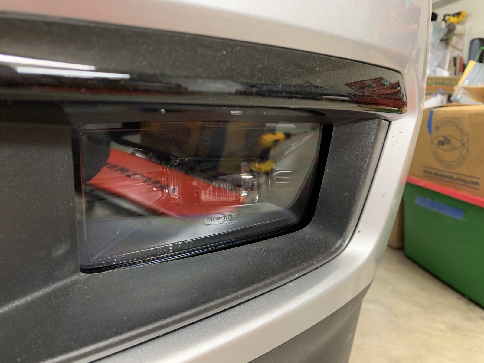

I see you're planning on the Morimoto fogs. Just a piece of advice here; I attempted to install them in my '19 Tahoe RST and the connectors that come with them do not work with our factory foglight connections. The connectors that are on the Morimoto is a PSX24 and our factory foglight bulbs are PSX26. There is enough of a difference between the two that they do not work. I contacted TheRetroFitSource and they told me to cut the splines on the Morimoto connector to make it fit which did not work. They've now asked me to trim all sides of the Morimoto and flip the connection to see if it's a polarity issue. I have not had time to do this but hopefully will this weekend. Another issue with these is that the Morimotos only have adjust at the bottom which is fine for aiming the light output but bad for fitment. When I had them installed for testing I noticed there was a significant gap all around the Morimoto fog.

Hmmmm, I ran into the same issue on my 13 Denali in terms of splicing the XBs. Do you have pics of lights installed? I never got around to installing mine yet.

Here's a pic. It's not terrible but definitely a bigger gap than the stock lights. (hopefully the pic is showing)
