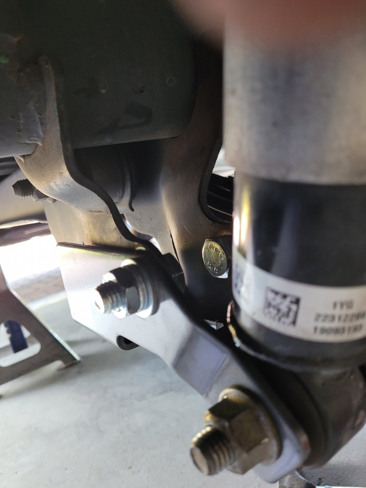

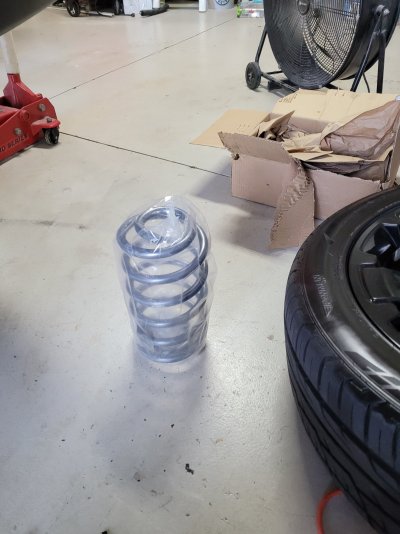

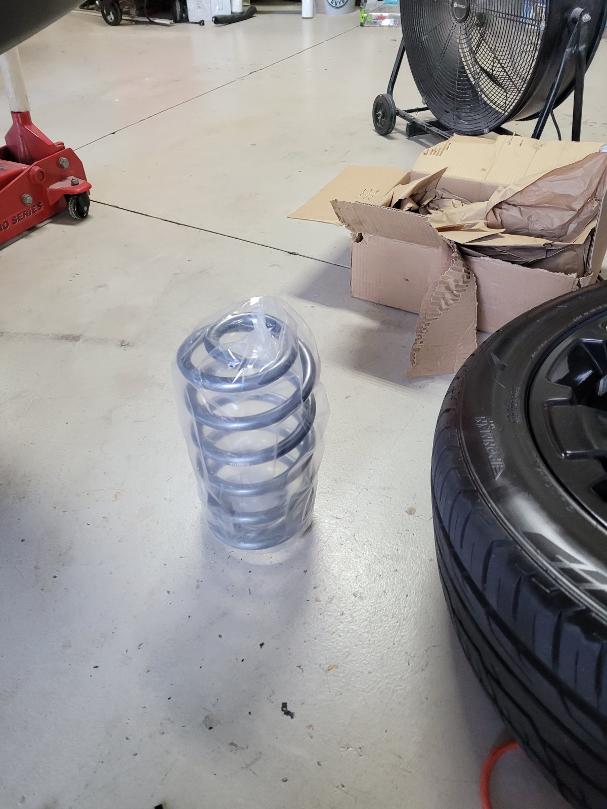

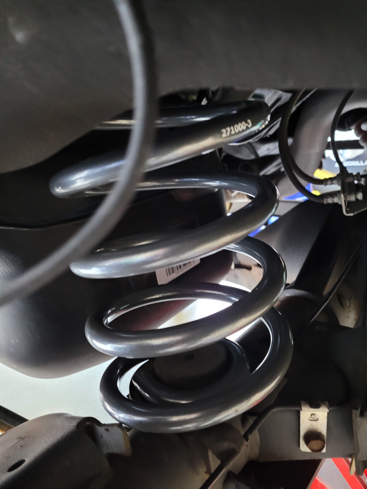

I leveled the Yukon this afternoon. I purchased a Maxtrac kit that came with springs, shock extenders and ride sensor arms. It took a few hours only because I had to remove the sway arm ends the get my old springs out. Installation was straight forward after removing the rear wheels.
Remove lower shock bolts
Remove sway bar bolts
Remove old sensor arms
Then lower the rear end down enough to get springs out. Be carful not to go to far or you might damage the ABS sensor wires.
You reuse the spring rubbers, so in with the new ones
Install new shock extenders
Reinstall shocks with old bolt
Reinstall sway bar bolts
Remove rubber 'eyes' on each end of sensor arm and install onto provided shorter arms.
Done
It dropped about an inch but I didn't drive far. I did have to adjust my mirrors and it used to squat and bounce a little when I jumped on it, that's gone.
Done
View attachment 352121View attachment 352122View attachment 352123View attachment 352121View attachment 352122View attachment 352123
