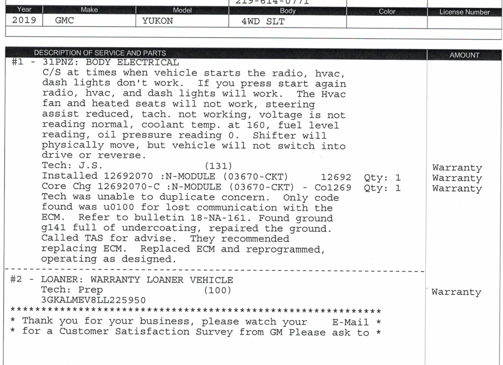

Today on Friday, the issue presented itself again. I was fortunately able gain control of the vehicle after multiple restarting attempts so that I could drive it to the same dealership that it was at on January 13th, rather than having to be towed in again. This just happened about an hour and a half ago. All of the symptoms that I described last time happened exactly the same again today, with the exception that after multiple restart attempts I was able to drive away just as if nothing happened.
Once again, they checked the codes and nothing was stored. However this time more people were involved at the service desk. A staff member was looking through the service history and noticed that it came in for some electrical issue in Missouri but that they didn't know what for and would look in to it further. I do know that this vehicle was from Missouri as I saw the Missouri title from Carmax when I bought on December 10th, 2019. I wish the dealership would have dug deeper at the service history the last time I was in.

I received a call from the GM service center today saying that a new ECM has been ordered. I inquired how they were able to determine that the ECM was the culprit but was told by the service adviser that they will have to get back to me on that. I will update again when I hear more.

I received a call back from the dealership about the ECM replacement and they told me that the technician coordinated with General Motors technical support and that replacing the ECM was at the suggestion of GM because "that's the only code they were getting." I don't know what code they were getting this time, however, the last time I had the vehicle towed in January, the three history codes that they said were present (according to the service invoice) were the following;
1) U0100 (Lost Communication With ECM/PCM "A")
2) U0121 (Lost Communication With Anti-Lock Brake System (ABS) Control Module)
3) U0422 (Invalid data received – body control module)
So basically this sounds like somewhat of a guess because they told me "we'll replace the ECM and go from there."

Got my Yukon back today after 17 days. The ECM was replaced as previously noted, but one additional item that was found was that ground #141 was found to be full of undercoating. I'm not exactly sure what that means or where that ground is but it was my understanding that the frames were waxed. Regardless, I'm not sure why they are still mentioning TSB 18-NA-161 which is what they supposedly completed the first time in January.
Still mentioning that the only code found was U0100 for "loss of communication with the ECM." It was from the advisement of GM TAS that the ECM be replaced, so that's what they did.
