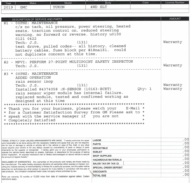

If anyone is curious, here is a screenshot of the service performed while I had it in the shop. There were 3 codes stored in "history" pertaining to loss of communication to the ECM, ABS, and BCM.

As mentioned the other 2019 user had both the negative cable and the fusable-link box on top of the battery replaced. Apparently the dealership did a test on the cables and it showed that the ground cable had high resistance or a voltage drop.
The TSB that I read that was apparently performed on my Yukon does say to test for voltage drop on all of the battery cables. I would assume if they complete a TSB that they do all of the steps? This is hard to interpret as in the service description on the invoice it only says that they cleaned battery connections. So did they follow the entirety of the TSB? Are they supposed to?
I attached TSB 18NA161. It is 7 pages long. I recall asking the service manager at the dealership what was done and he really didn't know, he was just reading off what notes the tech wrote on the invoice, which wasn't much.

It is still under warranty so I am not concerned about a charge. My question was, if a TSB tells them to check ten items, do they automatically go and check all ten? The TSB that they quoted as performing is 7 pages long and has them doing a variety of tests in different areas of the truck. Yet their descriptive text only said that they cleaned battery connections. It is very short, in comparison to what the full TSB says they are supposed to check.
For instance, they never physically mentioned doing a voltage drop or resistance check, yet it is clearly identified within the TSB. As is checking the starter connections, and infamous dashboard mounted grounding stud.
Like I said I asked the service manager and all they knew about what was done, was what was printed on the invoice. I was asking them about the G218 ground and they had no idea. Then again they didn't perform the work, and obviously didn't feel like questioning the technician.
