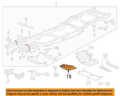

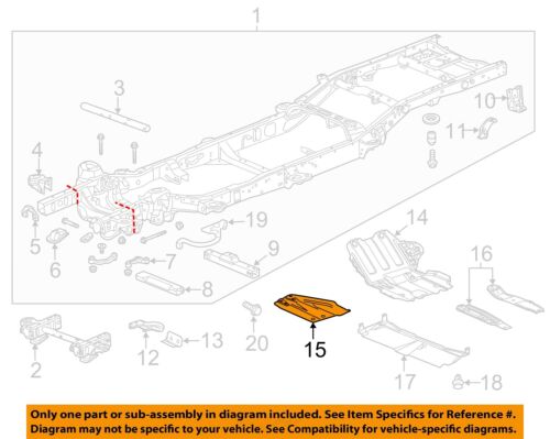

for what you are looking for these would work this guy sells them all the time, you would just need to get the self taping bolts, regular bolts will not fit right, when installing do not over tighten the bolts at all they will strip easy then you have to go with a larger bolt

those are it except for 1 for the transfer case which is a small one, they are often sold for the colorado but it will fit all from 00-20
this is about the cheapest one
