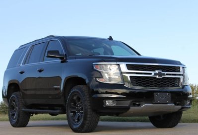

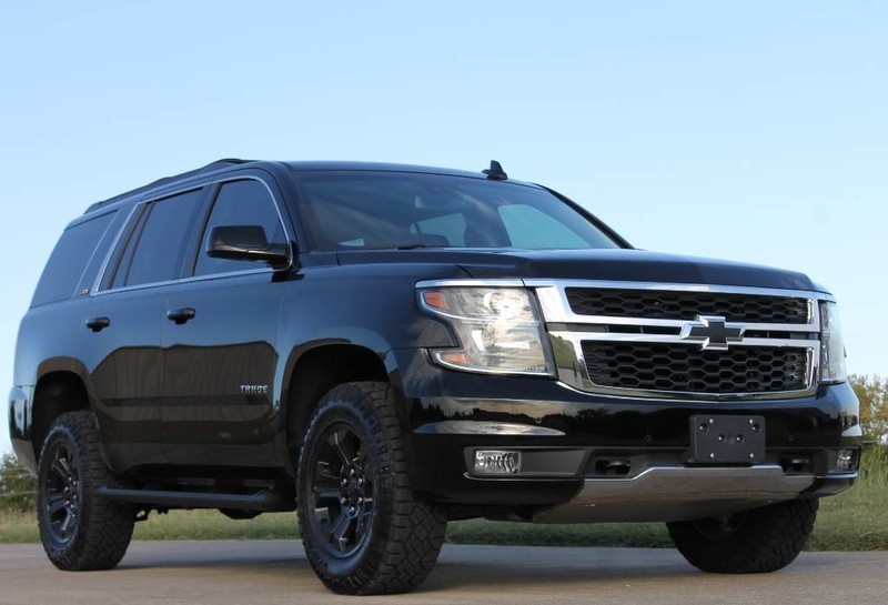

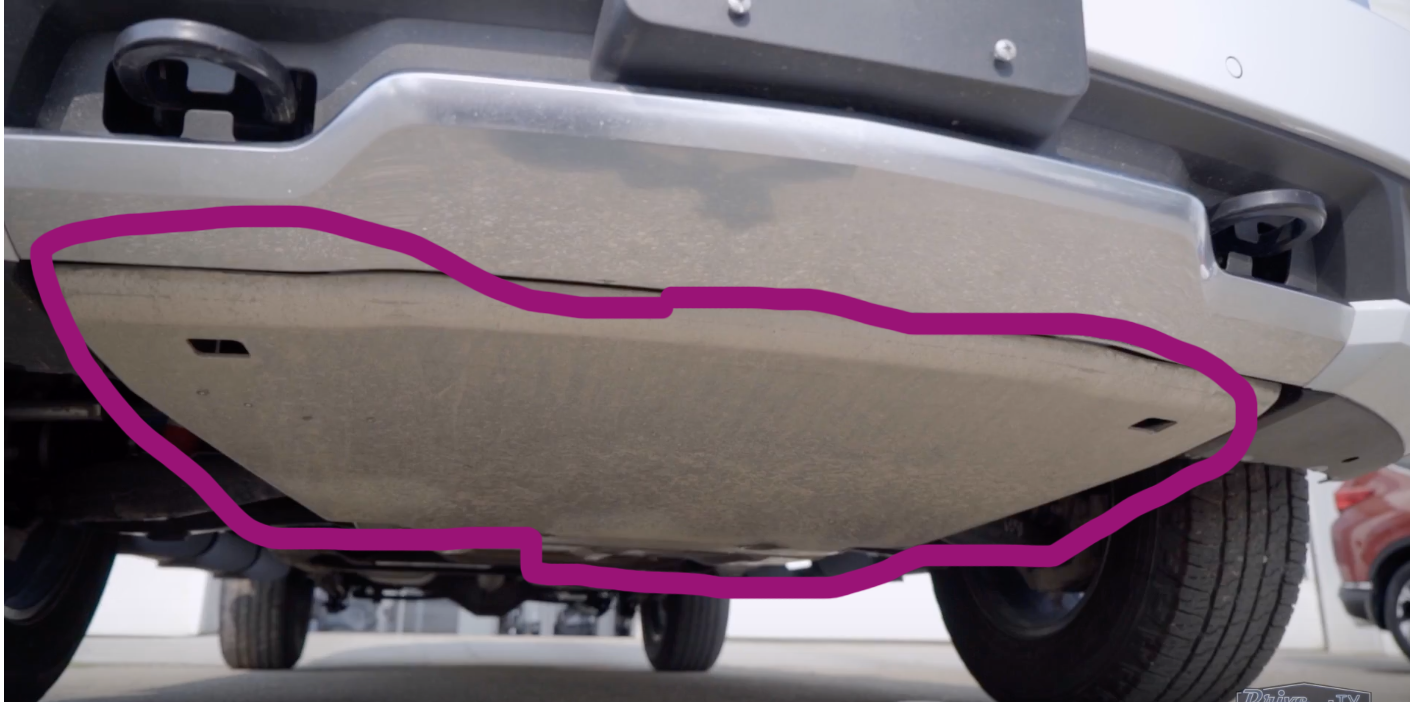

Does anyone know the name and part number of the skid plate in this photo?

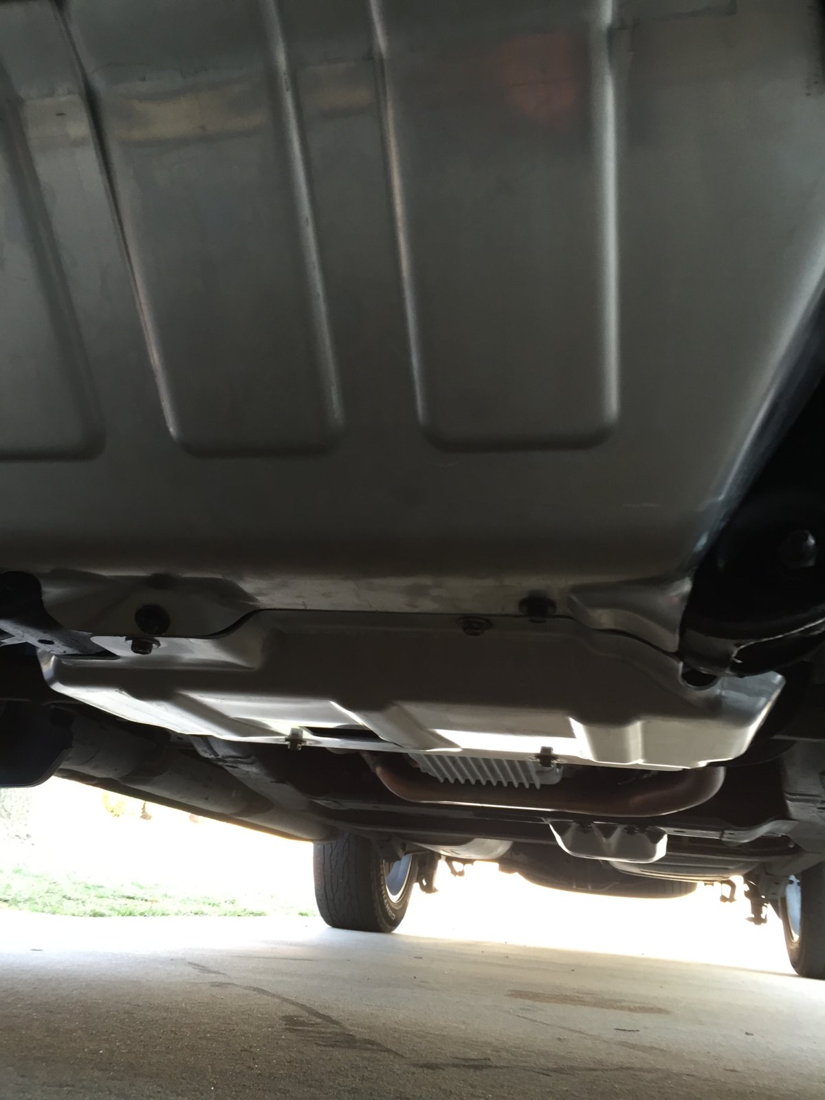

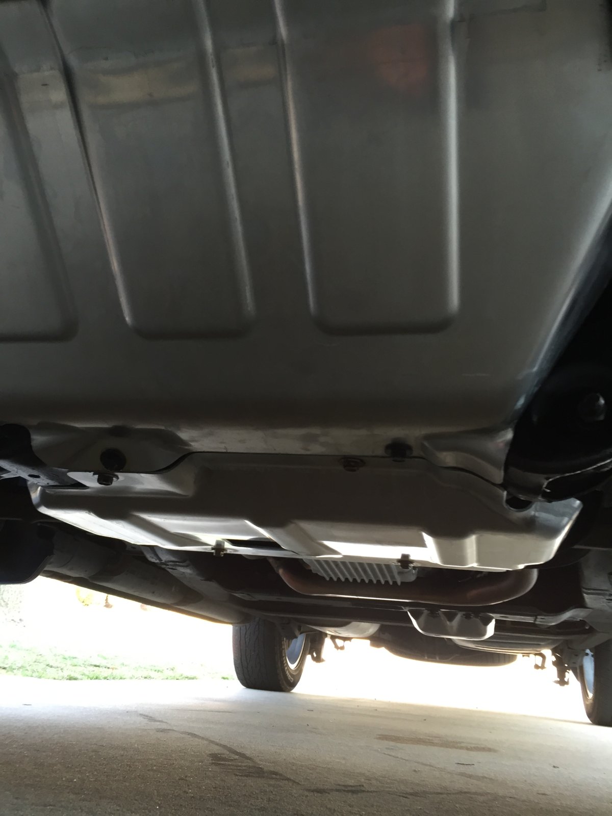

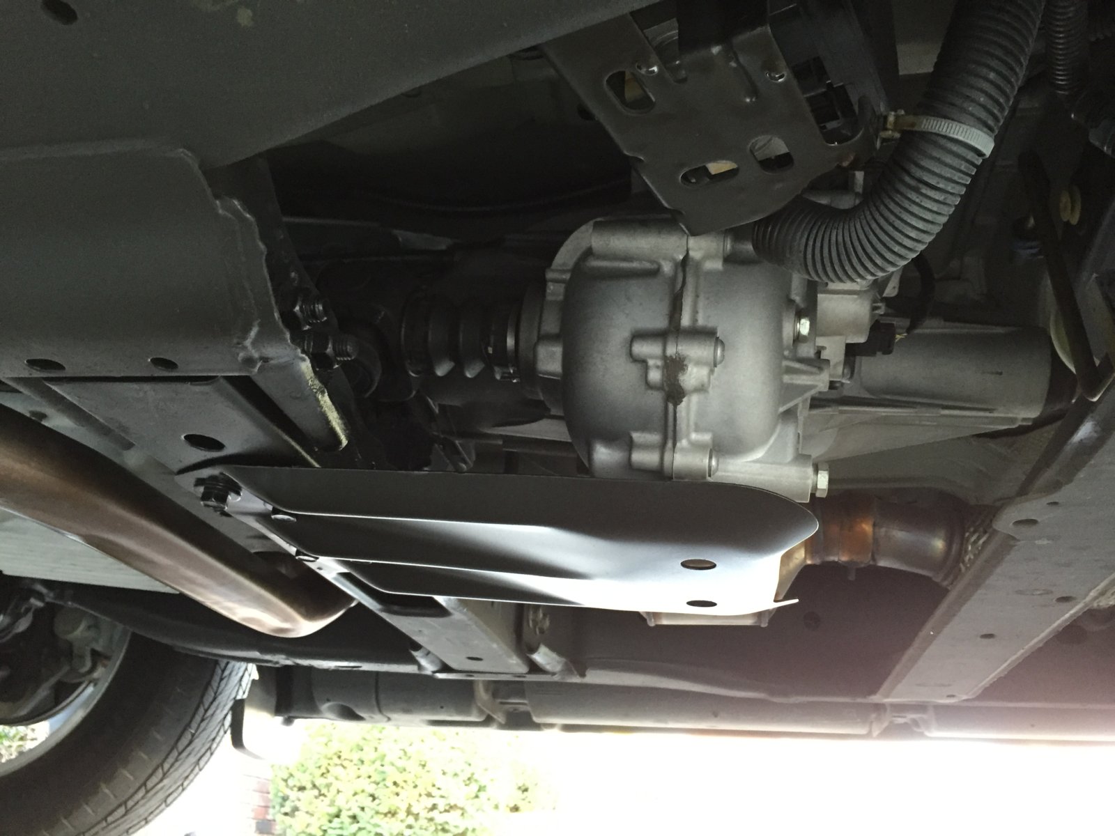

Not sure that is stock? I thought non-Z71 and Z-71 were the same and more like this...
File Jan 01, 4 09 43 PM.jpeg File Jan 01, 4 10 20 PM.jpeg File Jan 01, 4 13 06 PM.jpeg File Jan 01, 4 10 52 PM.jpeg

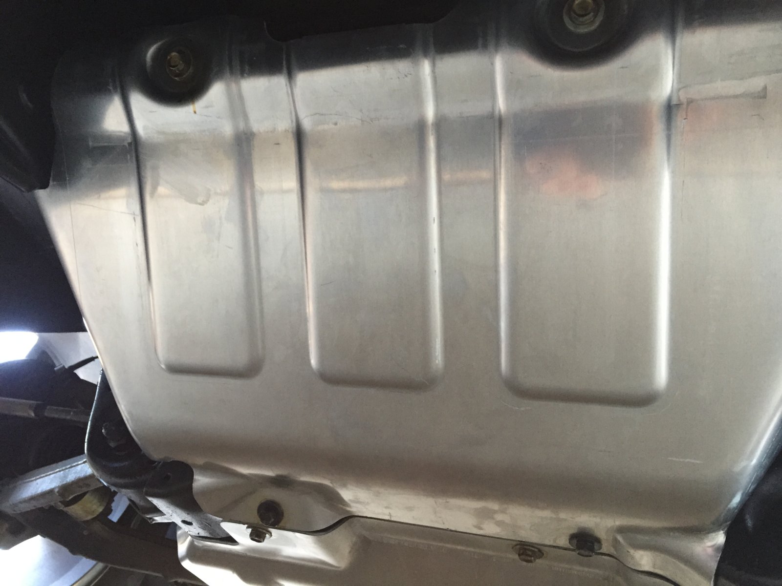

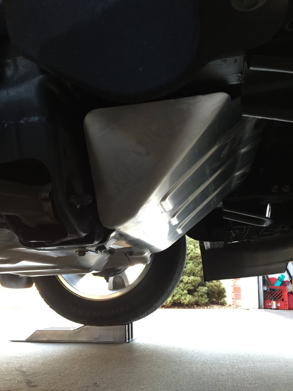

The pics I posted are from my LT retrofitted with aluminum GM skidplates instead of the plastic ones.

Thanks! I ended up ordering those. Just a lot easier and cheaper than having custom ones made.

Fw_800.jpg Here's a better shot of the Z71 skid plate on a midnight edition.

Hi, what was the Part # for the aluminum version?
This is the one I got. It's not the one in the #1 post. It is the part(s) in the #2 post.
Part # 23176881 - 2018 Tahoe Underbody Shield, V8 Engines

It showed up and the front skid plates are silver aluminum. The rear skid plate is black.

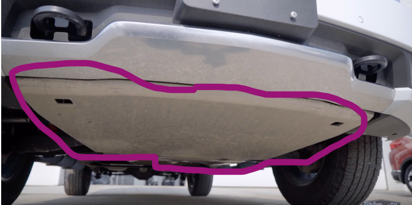

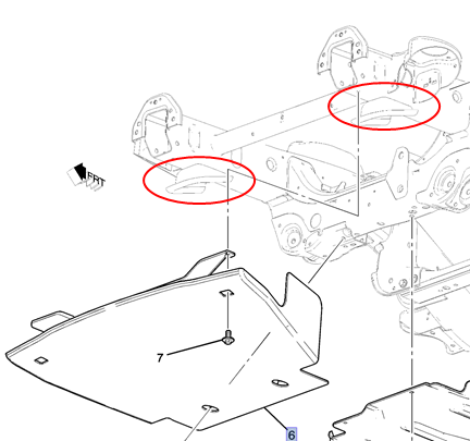

This is the schematic of the off-road skid plate part. I wish I would have stumbled on this post earlier. I purchased this part in May 2018 for my Tahoe LTZ.
YES, it comes ONLY in silver aluminum.
And YES, the dealer or any auto paint shop can paint the part to match your body color.
I have mine painted black to match. The z71 off-road skid plate stood up to the challenge last year for me. It took a couple dings up on the logging roads in northern Maine and the paint doesn't even look to be scratched up under there! Not that anyone can see...
That appears to be aftermarket. I purchased one like that for my Crew Cab. It's still sitting in a box where all of the mod items are staged and waiting their turn to get installed. It's made out of Aluminum. Nice piece.

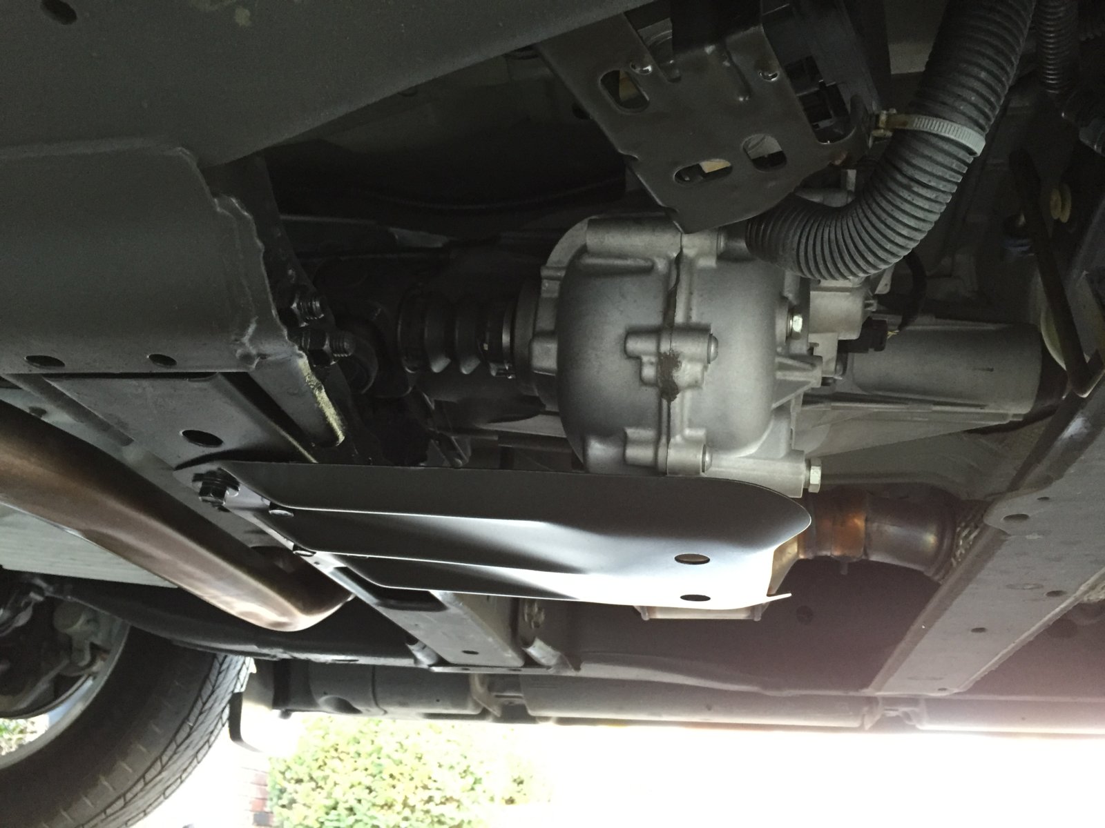

I did get a factory transfer case skid plate and it's about 1/2 to 1/3 the thickness of the ones that were on my '79 Jimmy and my 1990 (K-5) Blazer... bit of a joke. We'll see if that thing doesn't crush like a tin can. Damn holes aren't tapped for it I don't think, so more finagling to get that on.

PS - I think you can actually double up on the stock TC plate if you have enough sound deadening or goop to put between them to keep water and dirt out. It's an idea....
