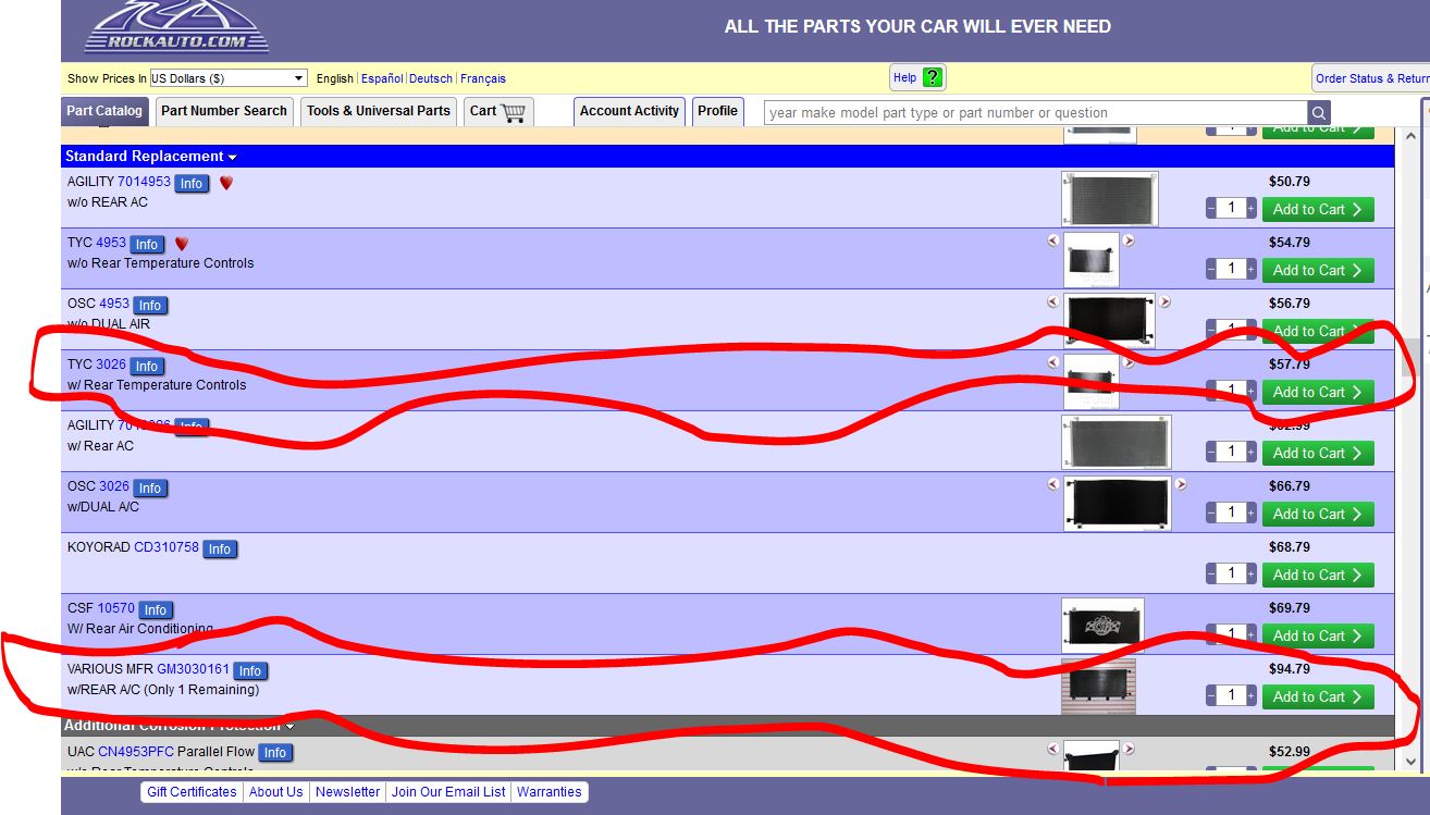

I am needing to replace the Ac Compressor. It has rear Ac. The controls for the rear Ac in the top headliner front of vehicle. Does anyone know what the correct part number would be from Rock Auto?
Ac compressor part #8008NK Four Seasons
Many thanks

Go to GMPartsDirect.com, enter your VIN, go to the Interior Cooling (AC) section, and look for the exploded diagram of the Compressor assembly. You should find what you are looking for along with the correct part number.
