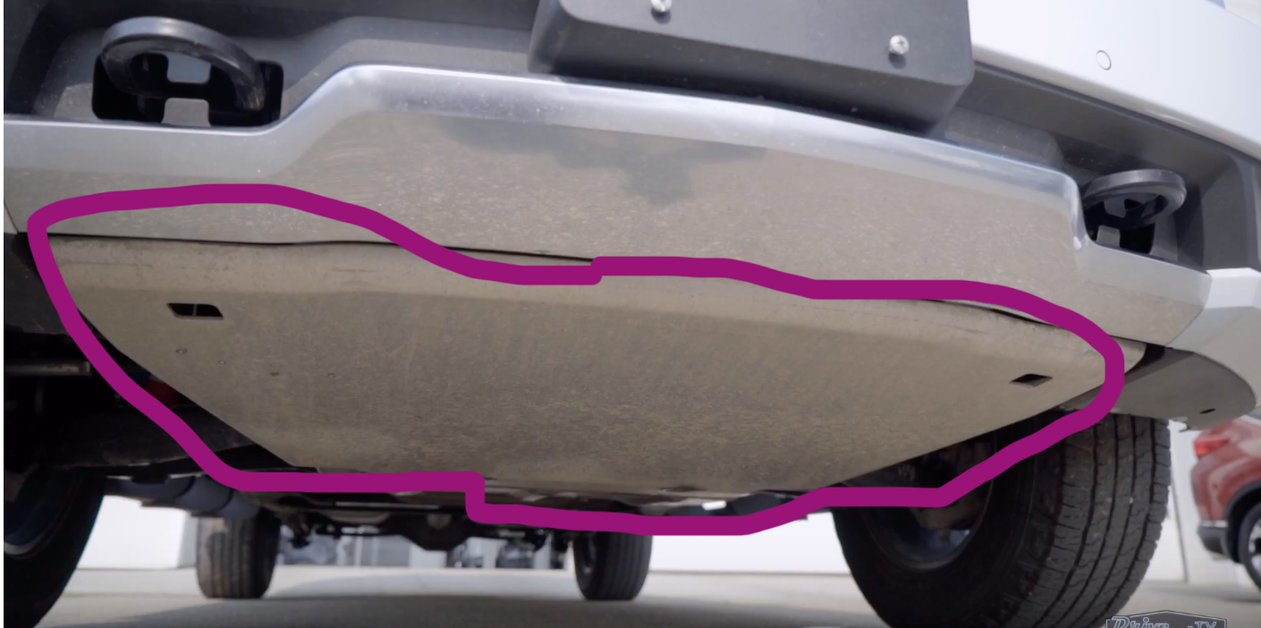

Thanks for checking back in. I'm still not sure about that front skid plate needing the z71 front fascia. I was up under there (truck not off the ground unfortunately) and I located the rear 2 connection points. Those connect to the main frame of the vehicle. For the front connections, I couldn't find the exact points. I'm not totally sure it does connect to the front bumper fascia because I had my hand up there and a good 1-2" of space seems to be between the front bumper/fascia and the edge of the plate. Grabbed some photos: see below.
I also dug up a PDF file I had from quite a while back regarding the z71 front skid plate. There's 2 different front skid plates out there. Sounds like you have the right one; one I believe is only made of "heavy duty" plastic. Take a look at the schematic below. I think it's a bit tough to make out but it seems that the 2 front connection points are through the front of the skid and attaching to the front of the vehicle frame. It sounds like you know what you're doing so I bet you can take a second look.

Photo 1: Rear connection points (upside-down steel "V" with bolt and washer visible; center of photo)
Photo 2: My hand in the open are between front of skid and front fascia

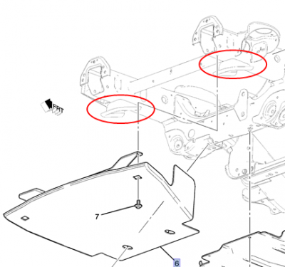

z71 Skid Plate Schematic (Chevy Tahoe 2015-2020)
30,751
48,442
what is the part number for that forward skid plate # 6 ?? searched that same vin and it only shows the plastic one or the optional aluminum ones neither of which are that one.
**also that referenced vin code in the pdf photo does not appear to be a valid vin #

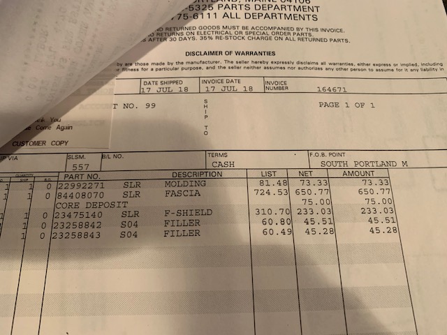

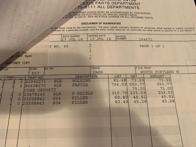

It has taken me some digging and "remembering" my own research to find you an answer to this one. For some reason, Chevy was a real pain in providing me a straight answer. when I was working to source this part. I actually ended up ordering 2 of those plastic skid plates before I got the correct part. A guy that worked in the body shop of a local dealer was the one that actually figured out the correct part. He's the one that supplied that PDF printout (with the weird VIN# from previous post). Really great guy but now works at Dodge - bummer!
I think it's pretty safe to say that if you are seeing the front skid plate for less than $150, it's the plastic one. I paid $233.03 + dealer labor (install) + sales tax.
I purchased GM Part# 23475140
Examples of some online purchase options I found today for this part#:
a) https://www.wholesalegmpartsonline....-Skid-Plate-Skid-plate/12475427/23475140.html
b) https://parts.courtesychev.com/oem-parts/gm-skid-plate-23475140
Here's a copy of my receipt & invoice from Chevy dealer:
Hope this helps!
Totally agree that finding your way through the maze to locate this part is confusing.

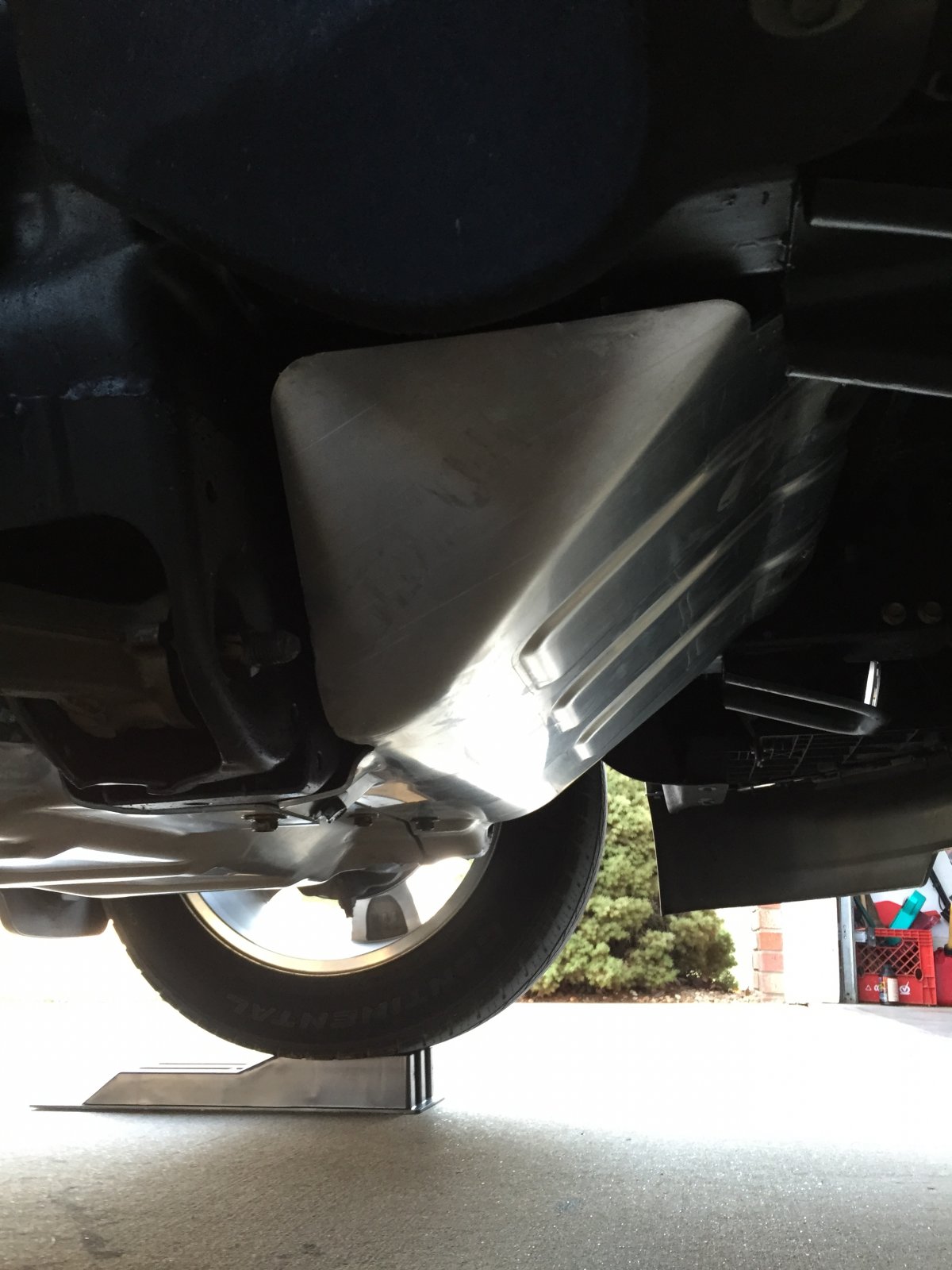

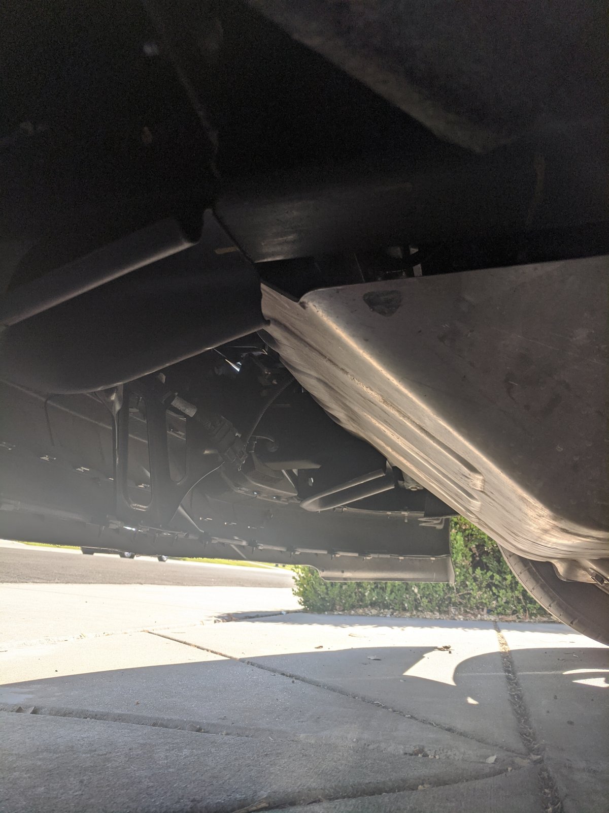

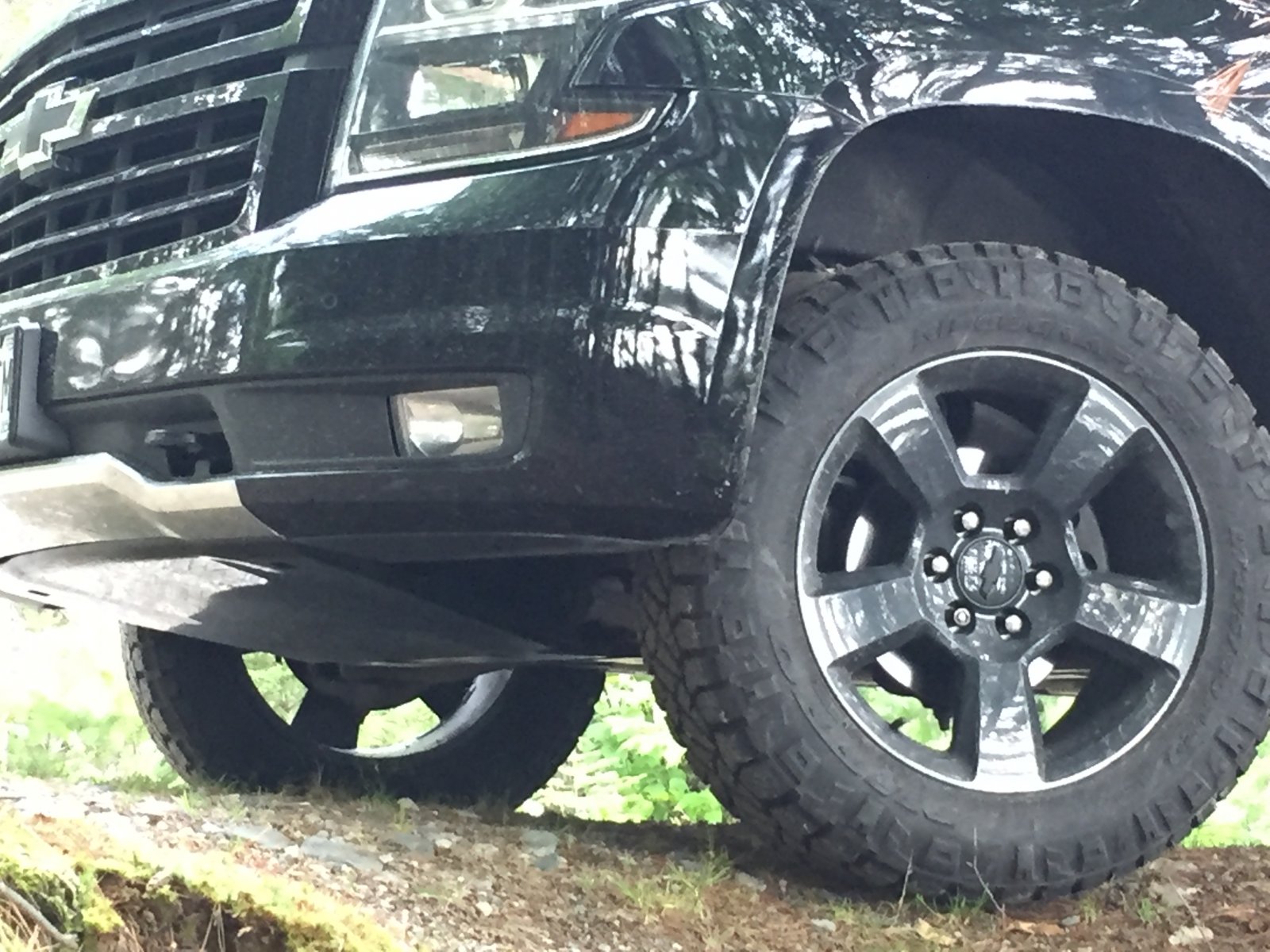

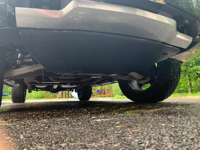

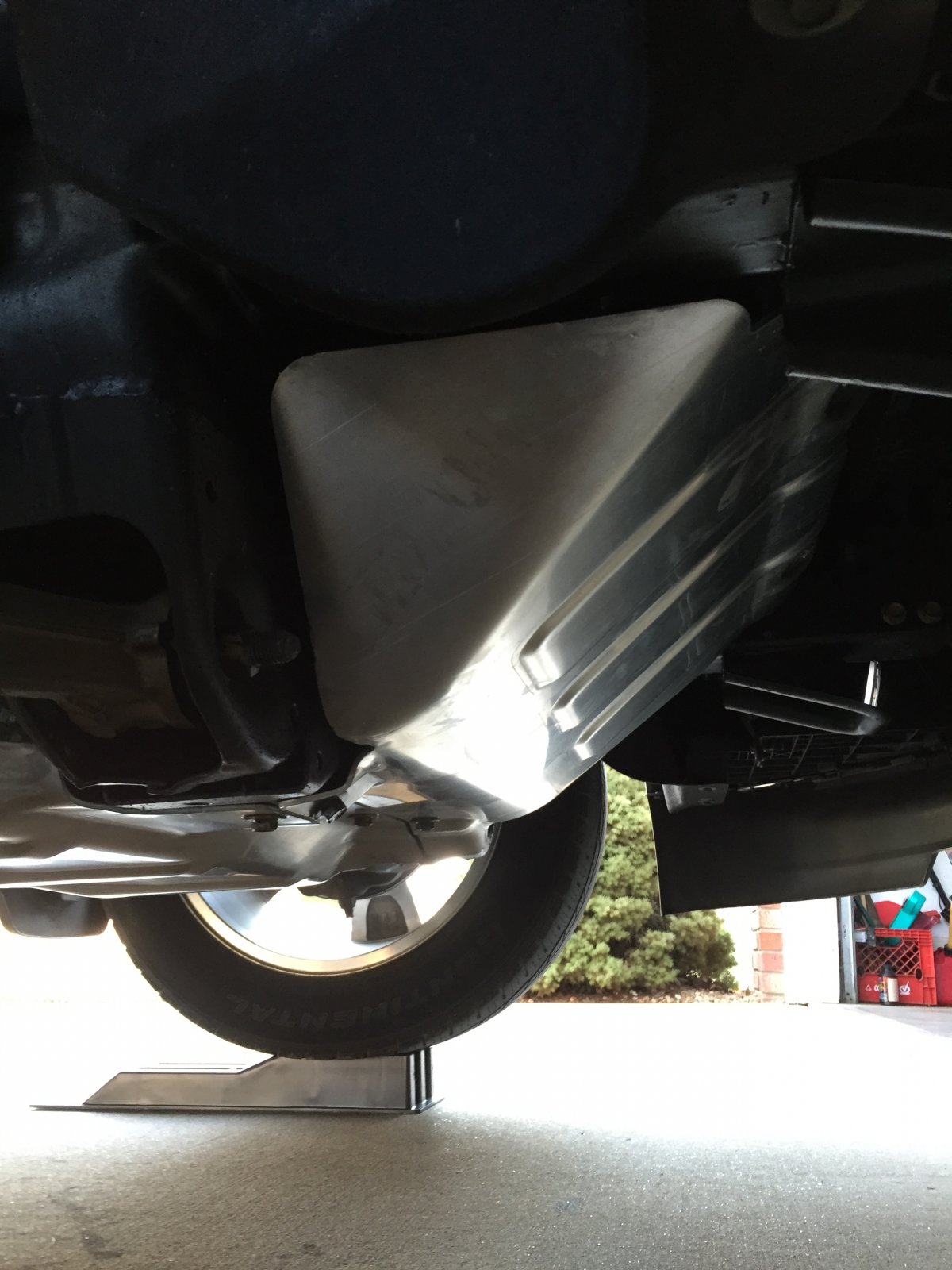

Maybe a photo of my front skid plate would help too...
Looking back at the earlier posts on this thread; it seems we have the plastic front skid plate and 2 different AL (aluminum) front skids in the mix. This is the one that I'm running and I DID purchase through the dealership and it was GM Part# 23475140

and yours looks like the one in the original post in this thread?
because when I search that part number you just provided the generic part photo looks just like part # 23135960

So yours goes around the little cups on the front of the frame? I don't see a bolt hole in front of them did you have to drill holes for the bolts?

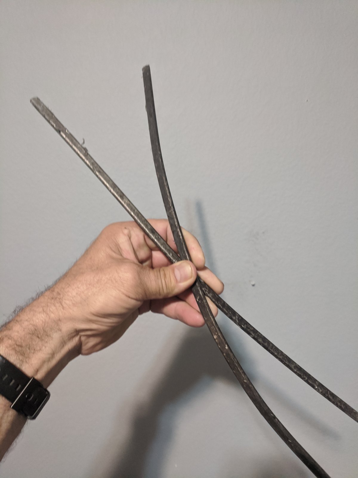

True but some road debris like this can ********* your vehicle, I hit these at about 60mph maybe slightly more, one punctured the tread of a tire entered the tire and then exited the tire ripping the splash guard in half, one went thru the running board and another went thru and lodged into the wheel well luckily that was just the right rear wheel area if it had been the drivers side it could have punctured the gas tank, if it had been up front hopefully the skid plates would have done there job, not sure though somehow the rear ac lines were missed

I am not sure what those are but, I don't think you would be hitting them on a trail.. It does go to show there is no telling.. lol I once hit a 10 mm Craftsmen wrench we found it inside the tire... That was a surprise.. Good part is I still have it in my tool box today...

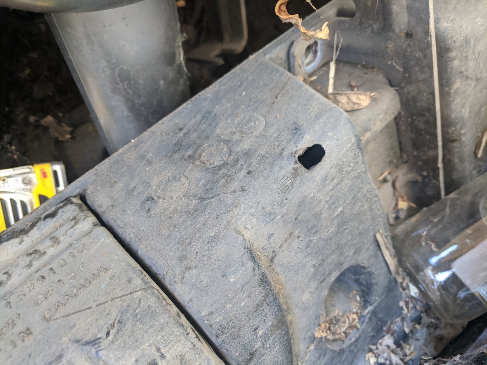

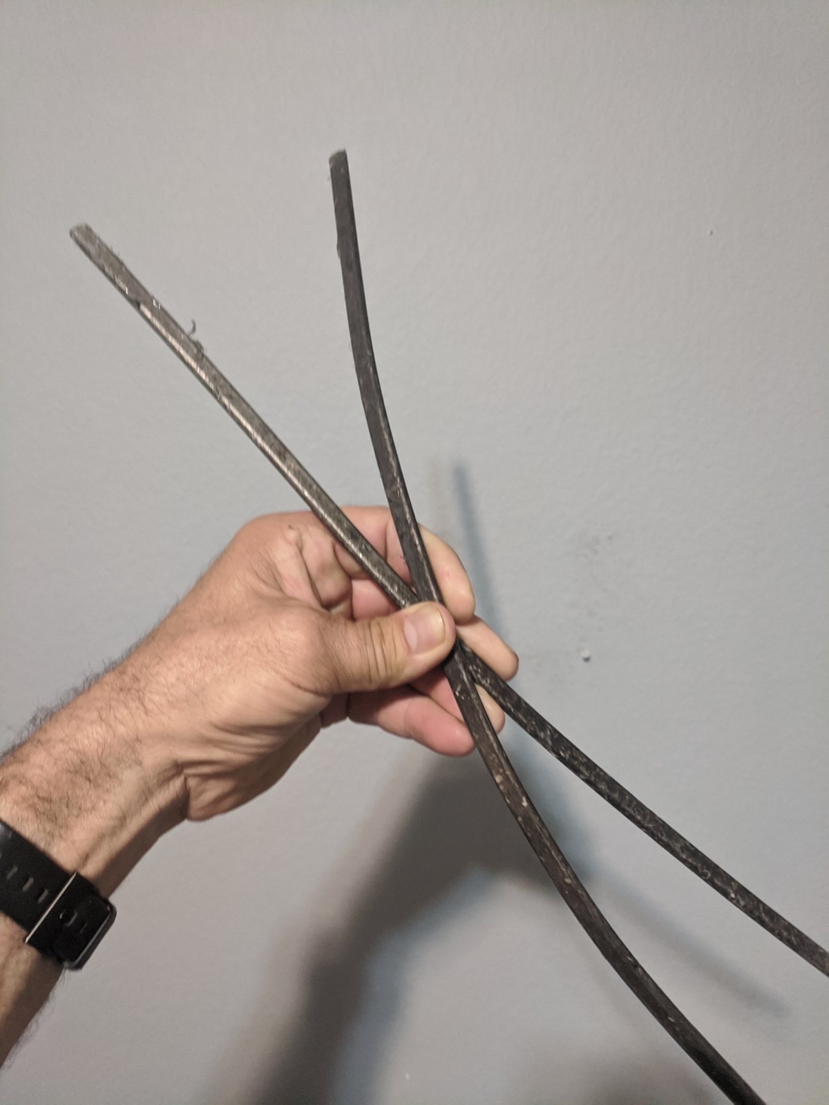

Those are 2 pieces of rebar that were laying in the road, there were more scattered in the road since they were virtually the same color as the road I didn't even see them until it was too late all I head was thunk thunk thunk from under the truck as I passed over them this was about a mile from home as soon as I pulled in the driveway I heard a grinding noise got out looked and the truck was harpooned and the tire was hissing air, luckily there is a tire shop about a mile and half from me so I jumped back in the truck and managed to make it there before it went completely flat, one entered the tire and ripped the wheel shroud, another entered the running board and went up thru the shroud and become wedged and another was up higher but had entered thru a gap in the body and then punctured I don't what can't see it beyond the outside somehow it missed the rear ac stuff

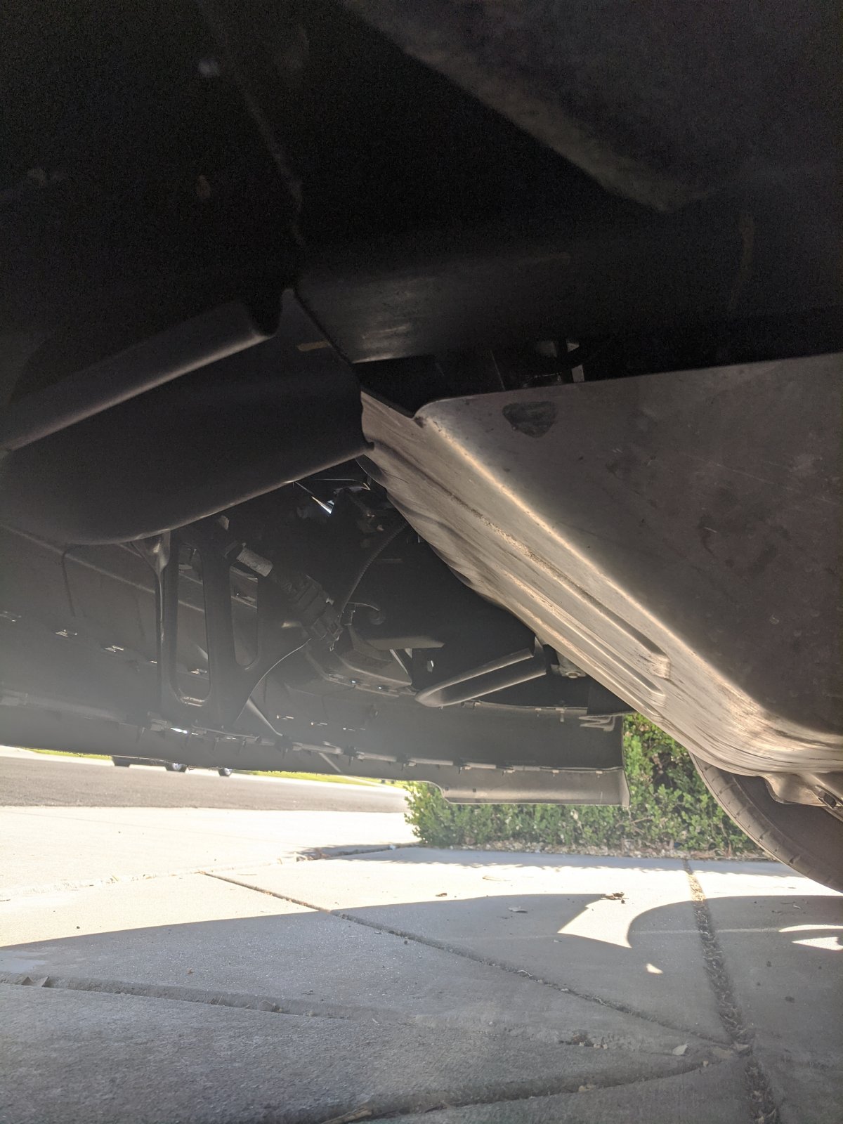

FD842490-2FE3-4395-8C0F-6C1B1E5D62D3.jpeg 91ED536E-F6ED-4A4D-9AF6-BA0382776C89.jpeg

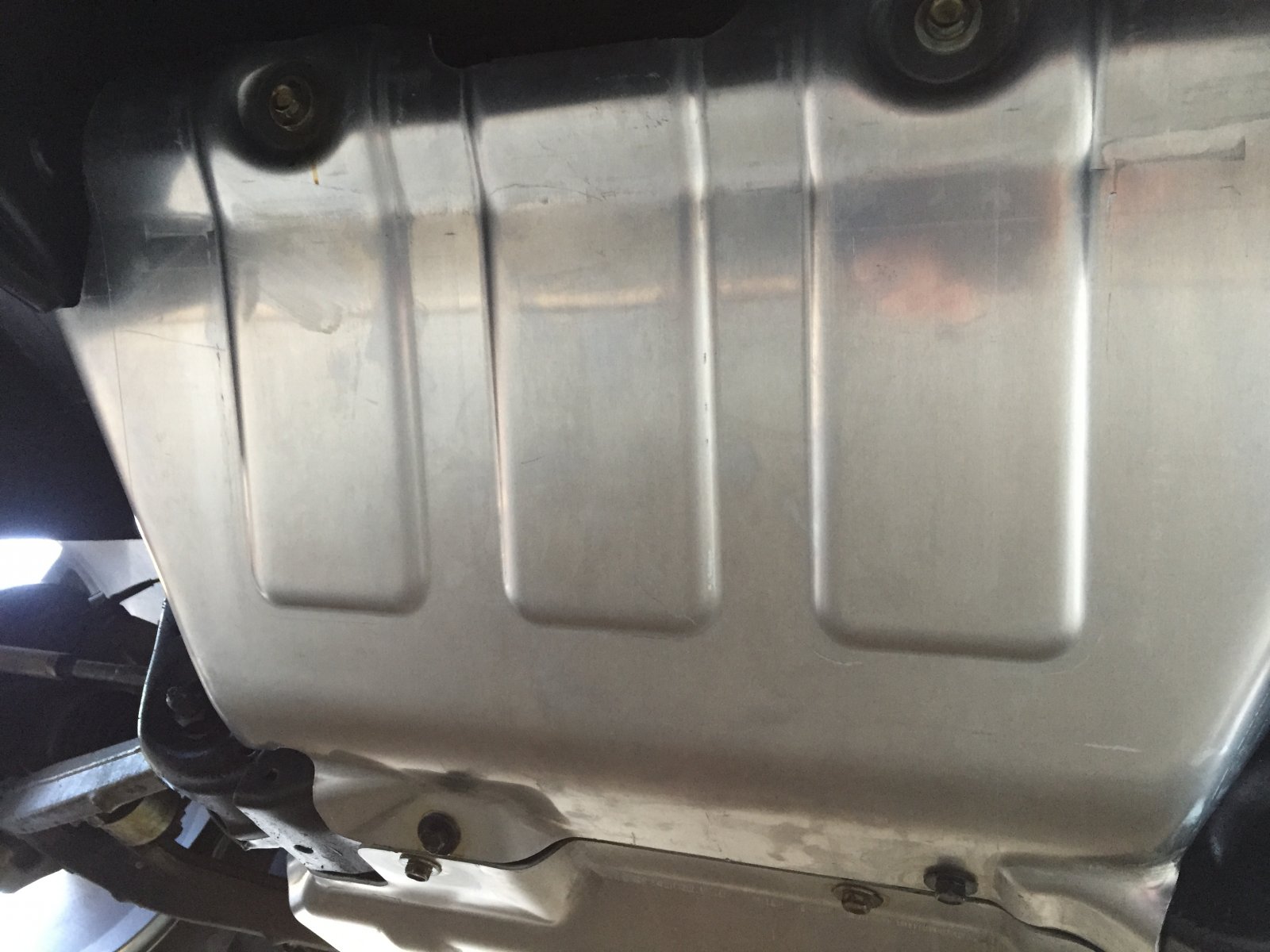

The front non-Z71 skid plate attaches to the round tubular crossmember at the front of the frame. Same place the plastic piece attaches. It does go around/behind the frame cups.
Whoever attached the plastic piece from the factory decided to do a superior job-aka tighten until it strips and then tighten some more! I ended up drilling out the holes and put a couple of rivnuts in there.
I ended up running over a blown semi-truck tire on its side. Following a moron in a Honda Odyssey who just cut me off to closely. They swerved and I didn’t have time. Truck just went whucka-whucka. Glad I had the skid plates! (Why do Honda Odyssey drivers think they are driving a race car? Most drive like idiots...)

Robert's skid plate is different, I know how these mount up I have the same ones

Same frames, same holes.... just not threaded. They are all there. :)
