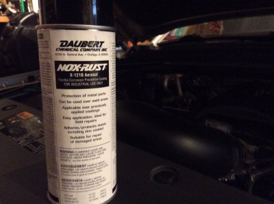

image.jpg Daubert Nox-Rust x-121B is the recommended replacement. I use it all the time. Works great.

View attachment 228566 Daubert Nox-Rust x-121B is the recommended replacement. I use it all the time. Works great.
Hi any tips to using this? Do I need to clean the area first before applying? I just got a new 2019 Tahoe and noticed some areas where no wax coating was applied from manufacturer and I want to be proactive and coat these areas. Some of very small pieces, was thinking of spraying into a small bowl and applying with a brush.
I just spray on areas the undercoat has been taken off—like by jacks, jack stands, lifts, rubbing, etc. works very well. No prep needed? It stays wet for some time so I am not sure if you sprayed it on a part in a bowl you wouldn’t take most of it back off reinstalling the part?

Happy with the nox-rust on my 2018. I had accidentally pressure washed a bunch of the factory coating off. Also noticed some areas missed by the factory. This stuff is awesome. Blends right in with factory coating. Easy to spray on, but it is a bit messy. Wear glasses when you do it, especially if you are laying upside down underneath the vehicle like I was.
