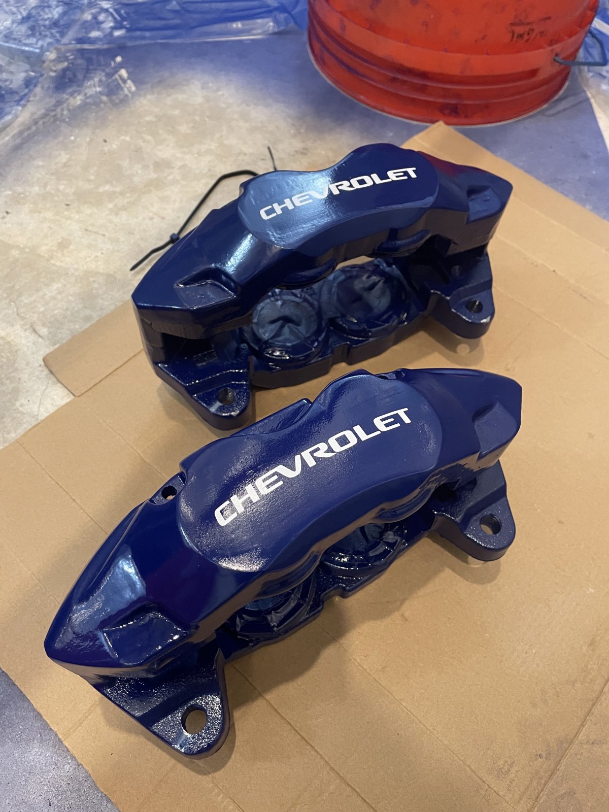

I'm actually in the middle of getting the Silverado calipers and rotors on my 17 Tahoe. Getting painted as I type this

rgr, thanks for replying. another question, so the suv's computer will work with the silverado brake hardware. referring to antilock.... i will have to research the silverado upgrade and or PPV....
The computer/ABS WON'T be affected by a change in caliper.
If you want a better upgrade over the Silverado or PPV calipers, I recommend the Wilwoods. They grab like nothing I've ever tried before. Even my sister's Esky with the GM Brembo upgrades doesn't stop like my truck. If you go that route just be sure to get the dyno-bedded rotors and pads. But as @GranPrix stated, you need 20" wheels or bigger.

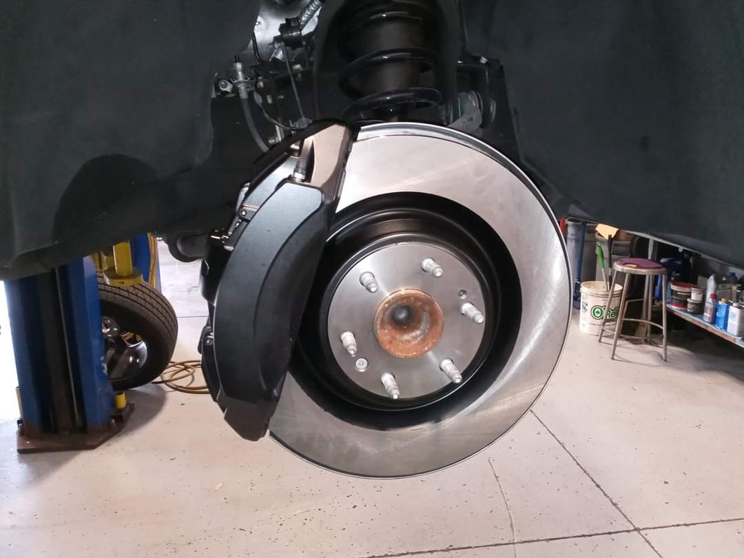

I just did the PPV fronts on my 2018 RST. AWESOME Upgrade. Simple, and inexpensive. Big difference towing even with 4 wheel trailer brakes.

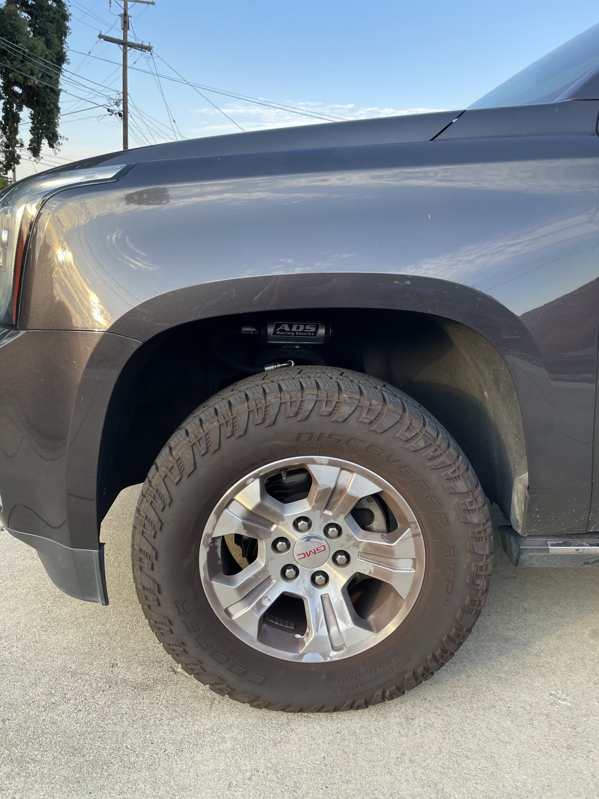

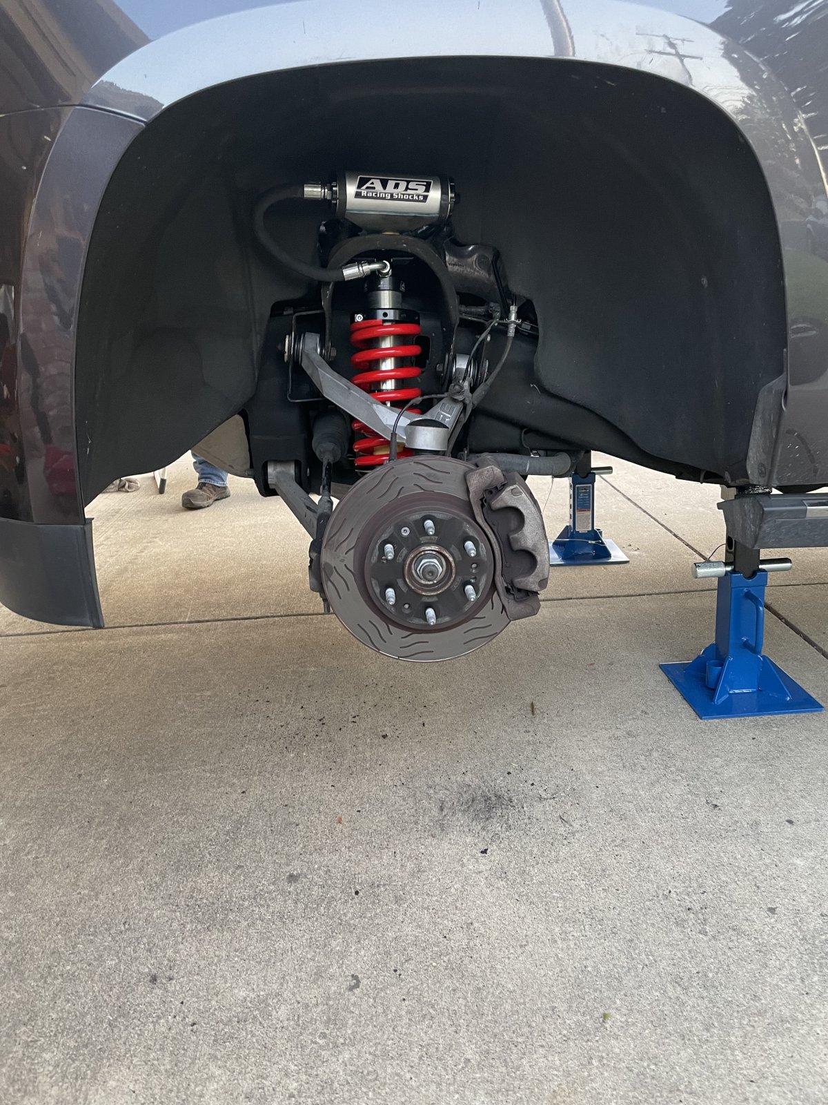

I am running the 18” wheels on my 2015i Yukon xl (6.2l)
It’s time to update the brakes but I want to keep the 18’s for off-road camping (overland camping etc)
the ppv brakes (black 6 piston) set up needs 20” wheels?
So that leaves me with the 2020+ regular brakes (the 4 piston calipers)?
Is it just calipers, rotors and then a spacer to space the caliper out?
Or should we get a new knuckle so it’s spaced correct? Or is it the splash shield on the unit bearing?
I don’t mind doing a spacer. But knuckles are often really cheap, about $80 each. So swapping knuckles isn’t s big deal to do it right.
I just need to make sure I can fit everything under 18’s
