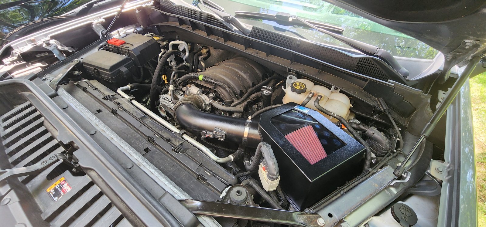

Just installed the K&N CAI and it’s much louder than expected. I had one on a previous (smaller) V8 and you had to get into the gas to hear much of anything. On my 6.2, anything more than slight pedal pressure results in a growl and getting on it just roars. Just checking if this is normal and considering going back to factory air box with upgraded filter. Maybe just add the tube. Planning ahead as my wife hasn’t driven it yet since I made the change. Was also considering a mild muffler swap, but went with CAI first.

Thanks. Not sure what the issue was, but that was 100% the intake. Everything seemed to be clamped on tightly so not sure why so loud. I changed it back to stock for now and everything is normal and quiet. I’ll probably just look at the filter exchange for now. My daughter thought it sounded “cool”, but knew it would get old quick.

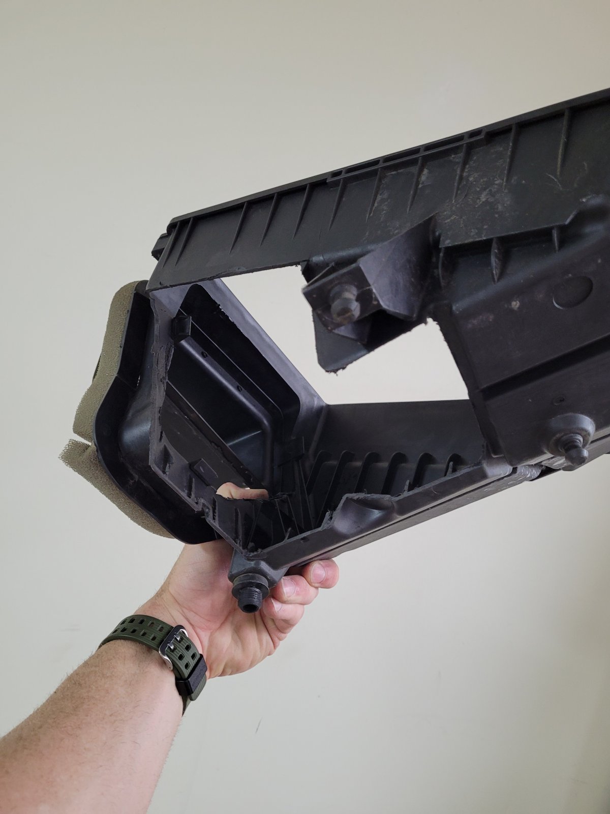

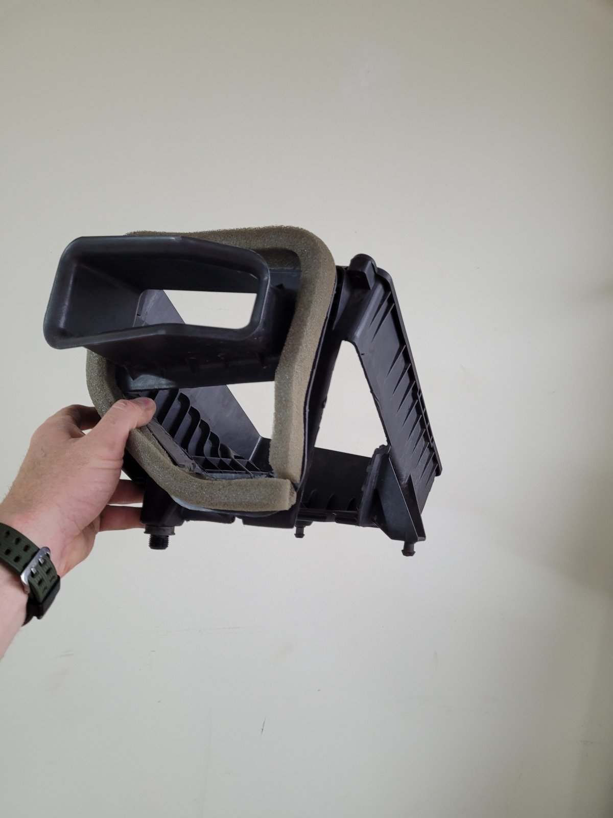

i disagree with most statements above...all reports i have ever read, or even experienced from CAi is that the sound is very noticeable.
perfect example is my current rig...i have opened up the factory box, below the filter...AGAIN, VERY NOTICEABLE CHANGE IN SOUND. the grumble of the motor when you have any throttle input is noticeable and even the exhaust tone has changed slightly.
i am considering a AIRAID JR TUBE, but not sure i want it to be any more noticeable as it currently has a great sound. the stock piping and silencer box make the engine sounds barely noticeable.

Based upon what I can see, unless I am missing something, your cutting away mod on the plastic housing basically eliminated your OEM CAI setup.
STORMIN08
Nov 21, 2011
974
464
and that may possibly be, which at idle is irrelevant (actually probably better for emissions). once rolling, that is not the case...the area removed is still well contained by other items that block most heat.
highway mileage, throttle response and drivability all had noticeable changes.
current mileage on long trips (with lift and larger tires) has stayed the same as when original tire size was installed (it had slight gains with original tire size)
throttle response and drivability, both showed effects.
they was affected in a matter that this created a small dead spot in the pedal at off idle, low speed, low throttle input (you needed to use more pedal to drive through it)
never said this mod was an improvement, nor is it for every one...this was a trial that i have done to most of my vehicles...i actually took small windows at a time, most having no change to low speed drivability...but there was a sound and mileage change with all.
it wasnt until the majority of the lower box was removed that the dead spot appeared. but again, i knew this was a possibility, but was looking for the gain at higher speeds as we perform long road trips regularly. since having the vehicle tuned (i have a diablo intune3) the dead spot is gone. either by the tune itself or the pedal sensitivity input changes.
the whole point of my post here was to inform that there probably isnt anything wrong the OP vehicle...but that the open flowing elements do create a louder engine noise when throttling...even the posts of swapping to the L83 to L86 intakes on a 5.3 increase sound.
my end game is to have a better flowing, much nicer appearing intake, this was all just a trial...but i can assure you, what ever route i do go...a K&N will NOT be my filter of choice. filtering and flow are 2 very different topics.

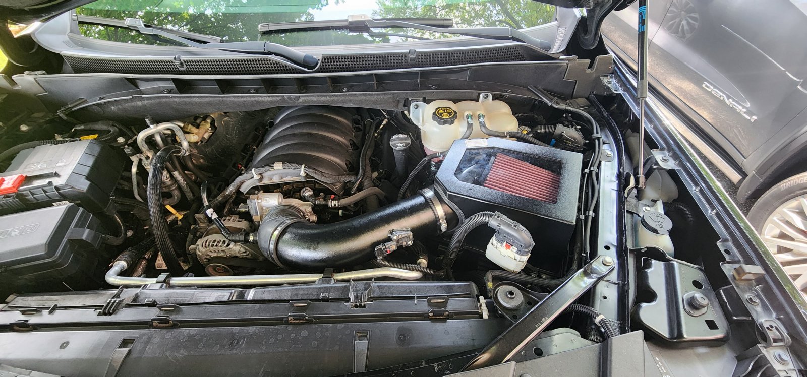

So, we are a two Danali family. I have a 2019 Sierra Denali with the 6.2, Borla catback, and a CAI brand CAI. The difference between the factory air box and the cai is phenomenal in not only the sound, but performance and MPG as well. Pushing 440hp or more. Gained almost 2 mpg on average. My wife has the 21 Yukon with a 6.2, stock exhaust, and a CAI cai as well. With the stock exhaust sound is nomi al at idle, but in accelaeration, yeah it sounds awesome. Performance increase is noticable. And the same for mpg as the Sierra. Bottom line I would say a cai is a good investment.
