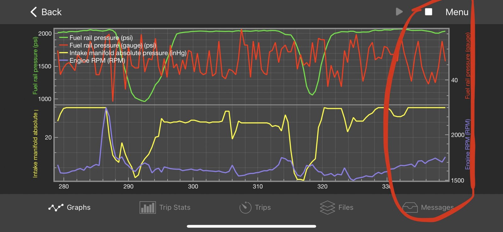

This really acts like a low fuel pressure problem from experience diagnosing other vehicles, but I am not really sure.
I have attached an image of my most recent graph recording of some PIDs while this issue occurred. Note the circled area since the screenshot was taken while the problem was recreated.
Anybody else have this issue or know what to check for? I included the MAP sensor reading on the graph since I saw one person with this issue reported a faulty MAP sensor being the issue.

Over the weekend, I did the following per the instructions in the video. I had to have a helper to control the throttle though.
It cleaned up all the hesitation on mine. It used to act like it was falling on its face when NORMALLY accelerating from a stop. Now it's smooth.
