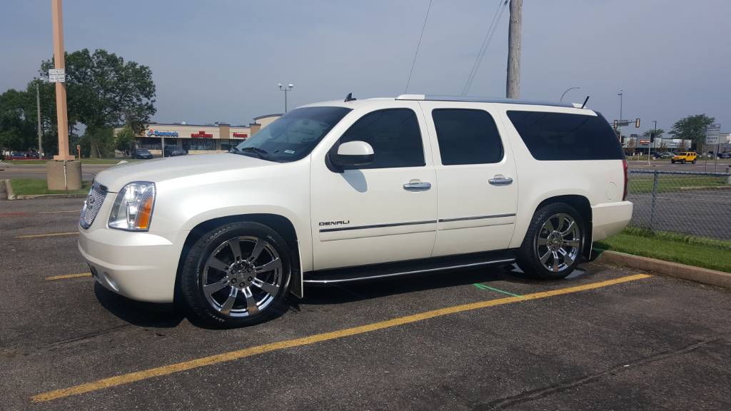

I've rode 24, 26 and 28,s on my Yukon and have never changed any suspension parts. Unforotanally it gets worse.. I've tried balance multiple times, no good...then it starts really bad asy 60mph.... someone told me to try very expensve tires since I had such big wheels

I'm in mounds view mn I a have a 2/3 drop on my awd yukon xl denali on 22" will be going 24 eventually I have no vibrations or bumpsteer alignment came without a problem still running factory air ride in the rear. like others have mentioned could be the tires
