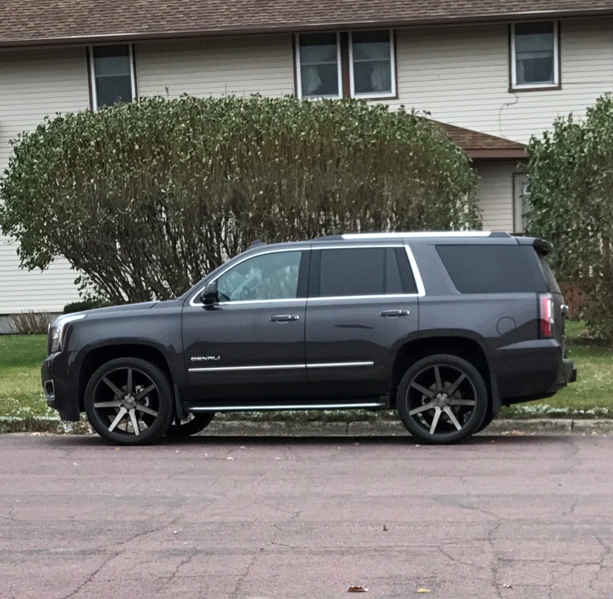

Whats up fellas - don't really post on these forums much but looking for some input on a few things. And appreciate ahead of time all of the responses.
First thing i did was drop the stock rims and throw on some 24s -
DUBS Future 24x10 +30 offset
Pirelli 305/35R24
This is where I started getting the bump steer like symptoms with vibration at 70-85mph. Before with stock rims it rode like a dream. I went back to place where I got rims installed- balanced and got an alignment. Helped the vibration a little bit but still have the bump steer like symptoms. Any ideas on this? I read other threads and some people recommended hub centric rings. So i will give those a shot.
But wondering if I need to upgrade sway bar or steering stabilizer?
Also looking to level out my ride just thinking dropping the back 2"? I live in Minnesota so don't want to get too aggressive but get a better look. Any suggestions on which leveling kit to get?
And if i were to upgrade sway bar & steering stabalizer any suggestions on that?
Thanks really appreciate all the help!

I'm not familiar with bump steer, but typically vibrations in the steering wheel come for improperly balanced wheels/tires. Some brands so built so poorly, that no matter what amount of weights are used, they are never 100%, and will vibrate at higher speeds.
As far as tracking the road, I noticed when I went to 24 inch wheels with 305/35/24 inch tires, the car would "follow" any imperfection in the road fairly easily. Same thing happened when I changed the wheels on the Escalade, G35 and rode a GTR with 22's.

Never even heard of “bump steer” but the vibration is a balancing issue in one of your front wheels. If they can’t get it balanced then one (or both) wheels are junk. I’d take care of it fairly quickly because the manufacturer will exchange it, or they should. That’s been my experience anyways with a few different brands. I’m not sure of DUB’s rep/quality.
I don’t understand how replacing the stabilizer bars can make a “big difference”. Possibly just me, but it seems a lot like the placebo affect going on. Change a part out, and you’re feeling what you want to feel when you test it.

You may want to have the hub bore on the wheels checked. If the hub bore on the new wheels does not match with the car (78mm) you will get vibrations. If your hub bore is higher than 78, then you will need hub rings.
Also would not hurt to check how tight the wheels are torqued to. Should be anywhere between 120-140 lbs.
Modded
That Guy
May 3, 2009
6,942
109
I did my own research on the Dub Future in the GM bolt pattern and +30 offset. It has a 78mm hub so that is not your issue.
The only other thing I can think that will cause vibrations is a bad balance, torque values on the wheels, or the rotor clips that I remember from back in the day.
I am not sure if yours has them or not, but previously GM would put these little washer like clips on the rotors to stop them from moving doing production.
The stock wheels have an indention on the back to go around the clip so that the wheel can still hug the rotor pad surface.
Aftermarket wheels may or may not have that indention. If they do not, then the wheel does not sit flat on the rotor and will cause vibrations. All you have to do it take off the little clip.
It will be around one of the lug studs on each corner. Sometimes they are only on the rear axle.

Normally I would have gone with a bad tire(s) but you're not running a cheap/off brand tire so I'm going to have to agree with what others have said and go with a bad balance. Also it might be worth it to take the truck to a shop that specializes in mounting and balancing large diameter wheels and tires. On a previous vehicle that ultimately ended up being the solution to my vibration issue.... I just took my truck to a shop that knew what they were doing. 24's are not that uncommon anymore but there are still plenty of tire shops in my area that won't touch them because the shops do volume work and don't have the time to invest in getting a custom wheel & tire combo balanced correctly.

I'm getting ready to install front/rear sway bars and dropping the rear 2" so when I'm working on that i will take off the wheels check for those clips, rotate & torque all the rims to see if that makes a difference. If i still get the vibration after that i will find a shop who has a more precise balancing machine and see where that takes me.

Find someone with a road force balancer.

This is gonna sound weird. I have a problem with the same pirellis. I tried to have them road forced balanced with a reputable tire shop this morning. The manager called me back into the shop and showed me the tires had a problem. The wheels were spinning true and I could see the tread on the tires all over the place. He told me he sees it happen occasionally but to see two was something he had never seen. After the front two tires, I had him stop and told him I’d have the original shop take a look at them. Told me to take them back to the place I bought them to warranty them. He told me if I had a problem with the original shop that he would jump in and help me out. Maybe we got a bad batch? Something to look at. Hopefully you just need a proper balance. Goodluck

FWIW, my BMW had Pirellis, and they were junk. Vibration and right pull. Thankfully they went bald at 12k miles. Albeit, a way different tire but same brand.

I have vibrations also, But mine are intermittent, above 70 mile an hour it’ll shake a little bit but go away within five minutes, I was thinking maybe the mrc??
