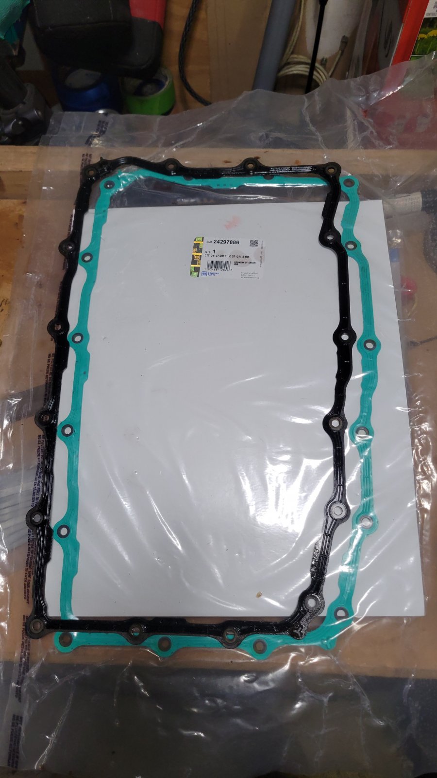

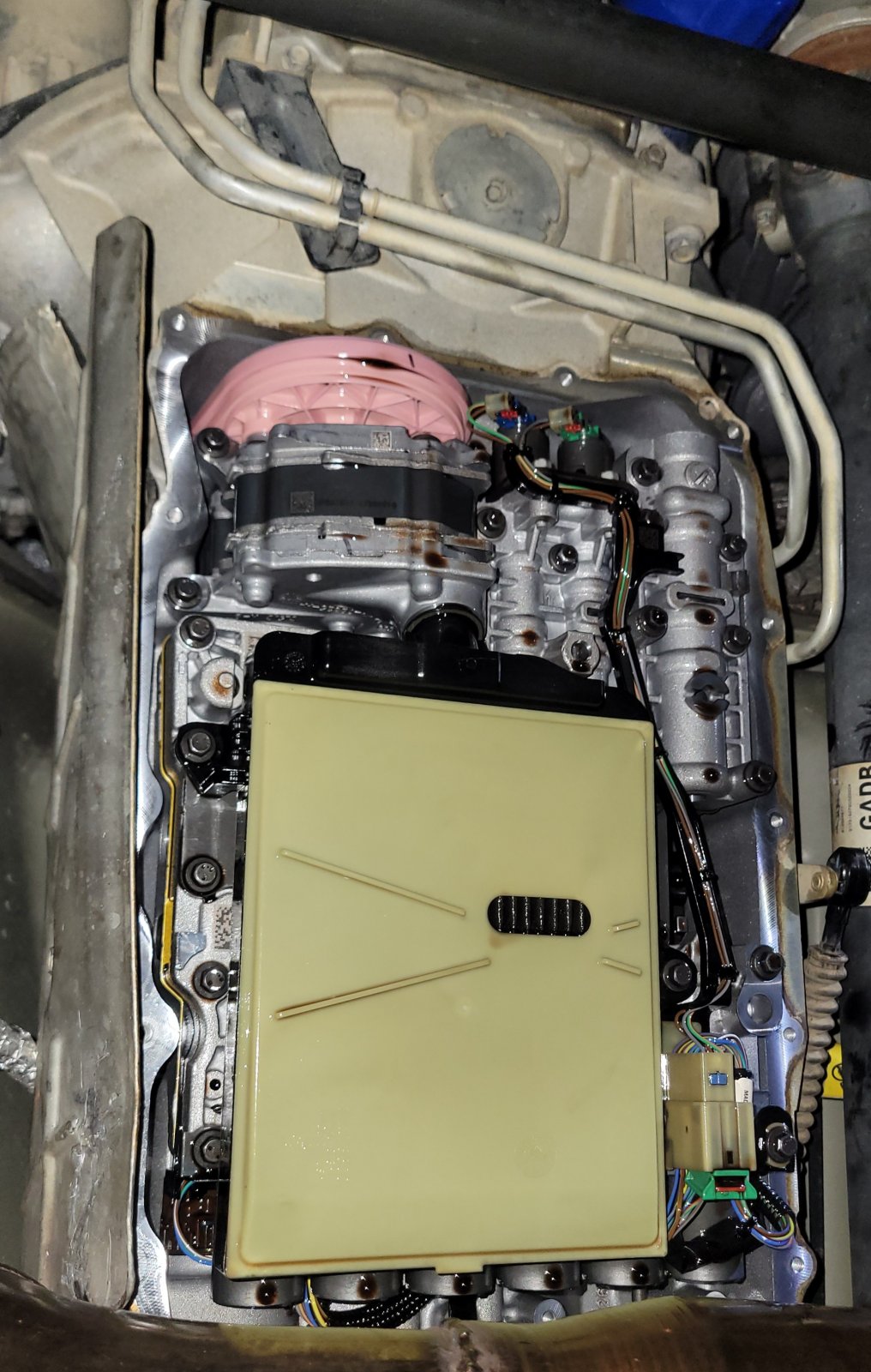

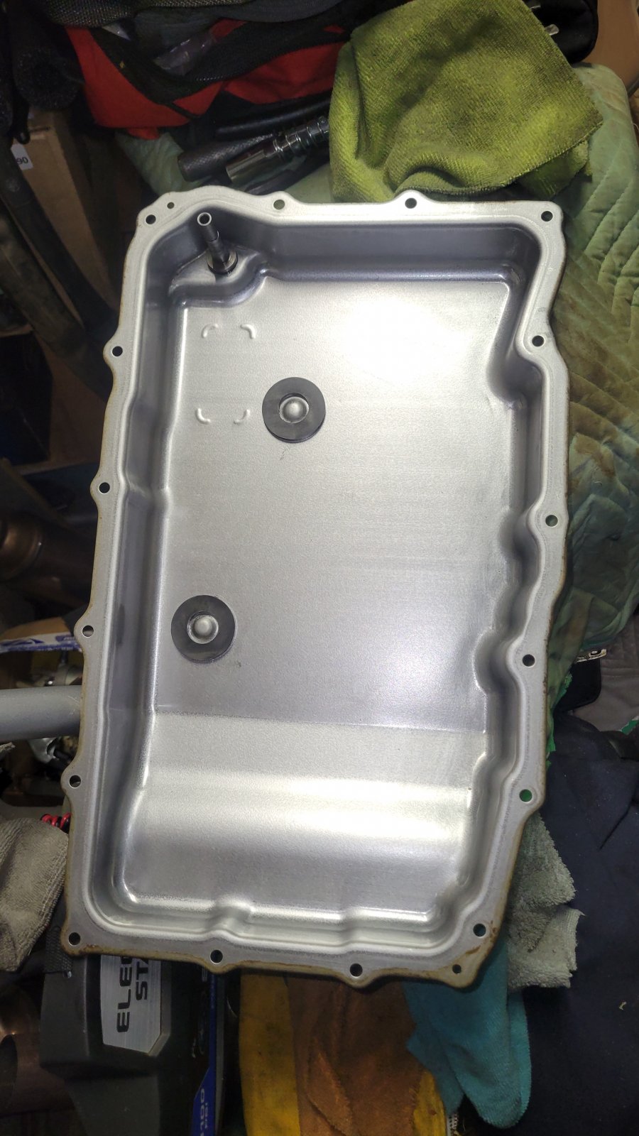

Just finished changing my 10L80 fluid, pan gasket, and filter last night. Shifting immediately improved. I was seeing slight hesitations becoming more and more frequent, but now it's shifting smooth and sharp at the same time, if that makes sense. Various videos on YouTube that helped me through the process. Didn't require any special tools, except a pump to get the new fluid in(which you can find at home depot)
