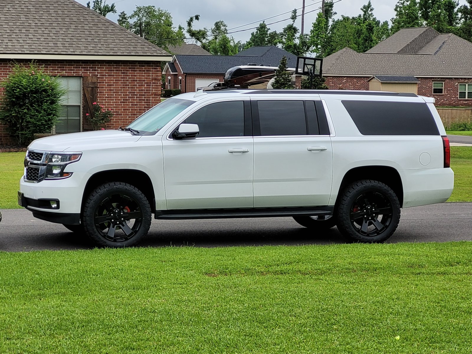

similar boat here...i wanted a certain size, look and upgraded parts. the trouble i found was most replacement arms mention a lesser offset wheel or spacer...that was a no go for me.
i currently run a 2.5 front spacer on new front assemblies, with readylift upper arms ( these clear stock wheels just fine), and a 1.5 rear spacer and bilstein 5100.
i am looking to move to a full 4", but want a lower arm relocation and knuckle to maintain stock travel and angles. 2017 Suburban 2.5-1.5-285-55-22.jpg

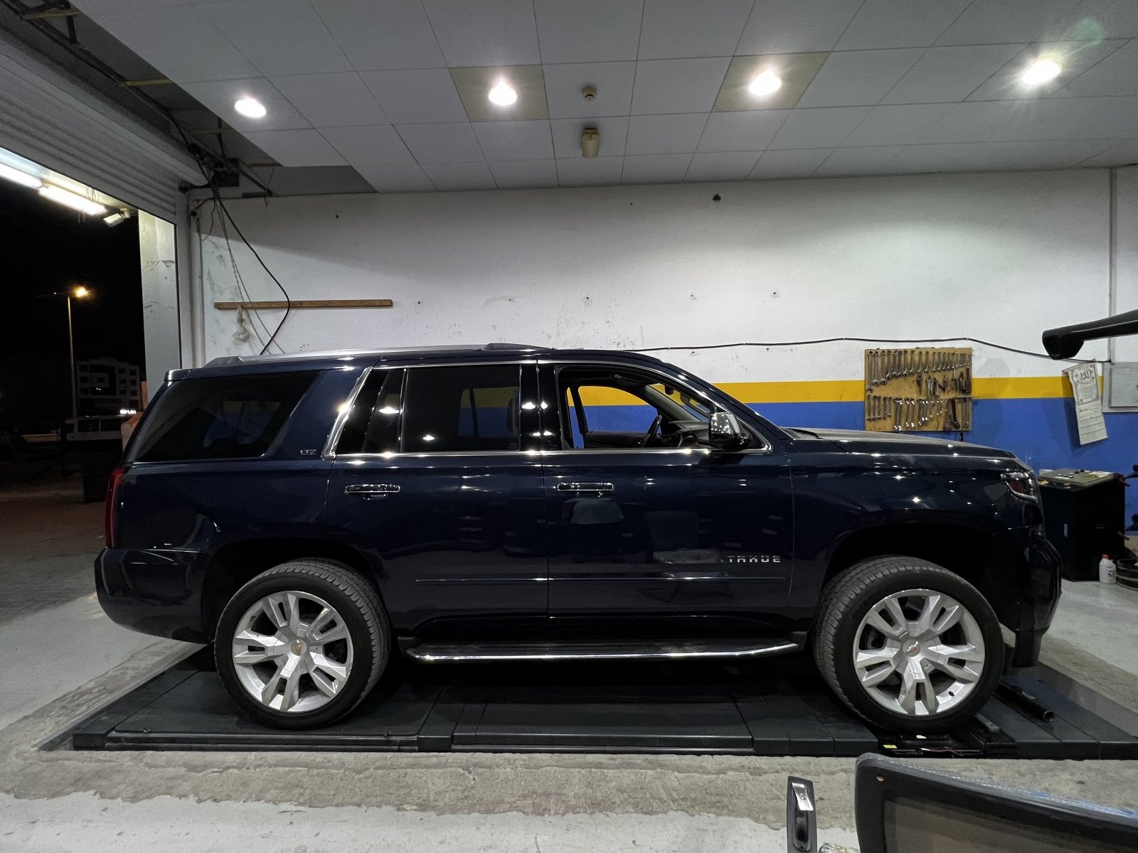

I have tried max settings and it was a beast offroaf, then i lowered it again and it rides judt like stock. Still takes s beating offroad but the front is way more bouncy . Exposed threads 18.5 but am gonna take it up an inch & add suburban z71 springs in the rear which should maintain factory level (nose down) but a more suitable offroad drive. Before and after photos below 2017 LTZ mrc delete 22in wheels no rubbing
Current Level ground to fender 37.75in Rear
34.75in Front
Plush & Soft ride on road
Average ride offroad
Previous:
36 5/16in rear
38 3/4in front
Exposed threads on Coilover 46 out of 50
Harsh firm onride but tight handling
Superb Off Road performance like a jeep or toy remote control car feel
