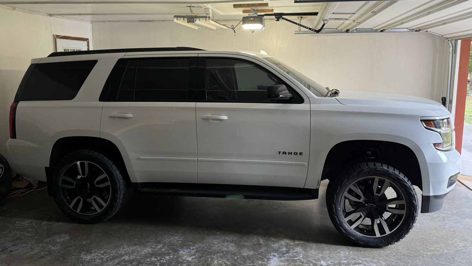

Hey everyone, I'm new on here so I am unsure if anything has been posted about this, but I haven't found much about it. I have a 2018 Tahoe Premier and I have just had the Cognito 3" level kit put on with the Fox 2.0 coilovers. This was supposed to be a leveling kit, but after it was installed, my front end is about 2" higher in the front than the back. I know the coilovers are adjustable, but with the 33x12.50r22 tires, I don't think I can go much lower and not rub. The coilovers are set to the factory preload. So my question is, should I try to adjust them or just install some 2" blocks in the rear?

Hi Jerry, what did you ended up doing? I have the same exact truck with the same setup.

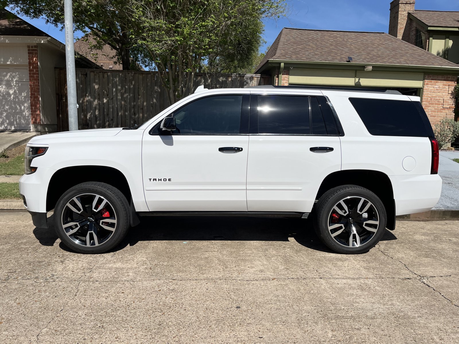

I added a 1” block in the rear. It levels out the truck but now it is making a bumping sound when I go over bumps. Researching what I can do to eliminate it.

You can lower the coil overs down some but you would want to get your alignment checked afterwards
You can get a 2” puck for the rear spring for like 30$ that would be way easier and you wouldn’t have to spend the extra money on another alignment

A bumping sound? What do you mean by that? That could be a number of different things
