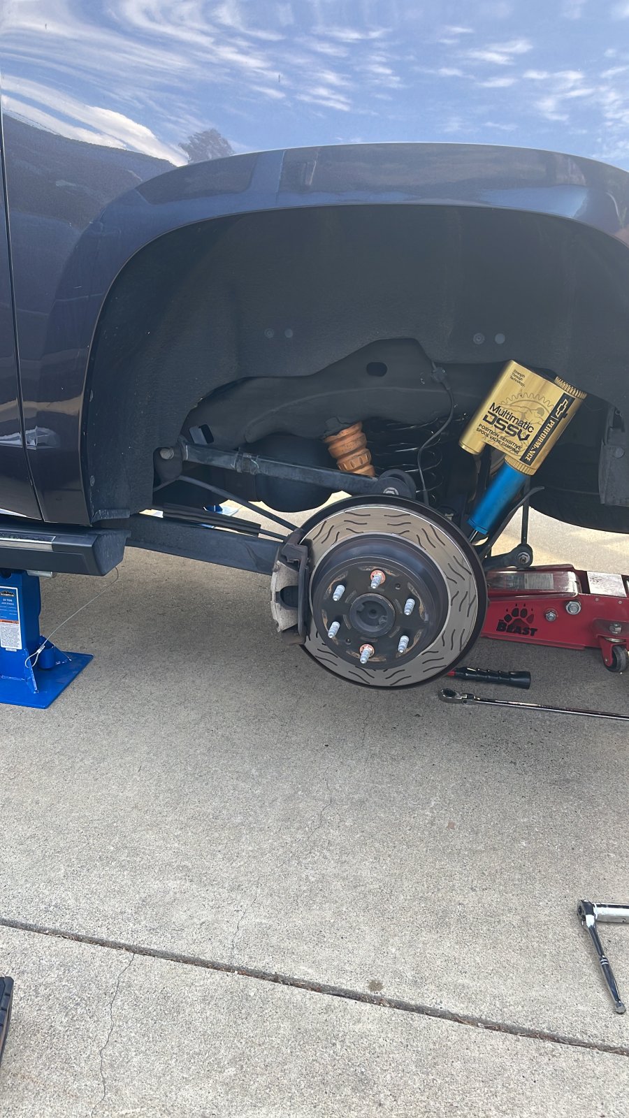

Fifty
Jun 26, 2015
844
239
These are the proper rear shocks for the Yukon. I run the border patrol suburban rear springs and z71 suburban bump stops.
Front are the rough country forged arms. Yes I know they have a bad rep but the uca they make are awesome and about $220 for the pair.
Hard to tell in these shocks but the reservoir is clocked for better fitment for the Yukon frame. The Gm of the company has a 2007 Yukon I think that he puts through the paces.
A lot of testing hence the low port reservoir vs high port like most shocks.
