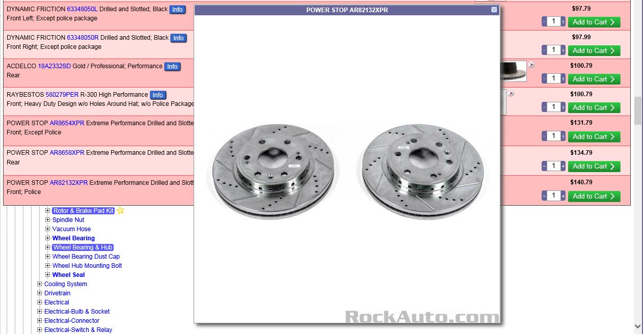

I bought these rotor's for my 2018 and have been very happy with them, the hat is drilled as well the rotor surface
you will find they are only marketed for the 2010-2011 police tahoe but they fit and work on 07-20
