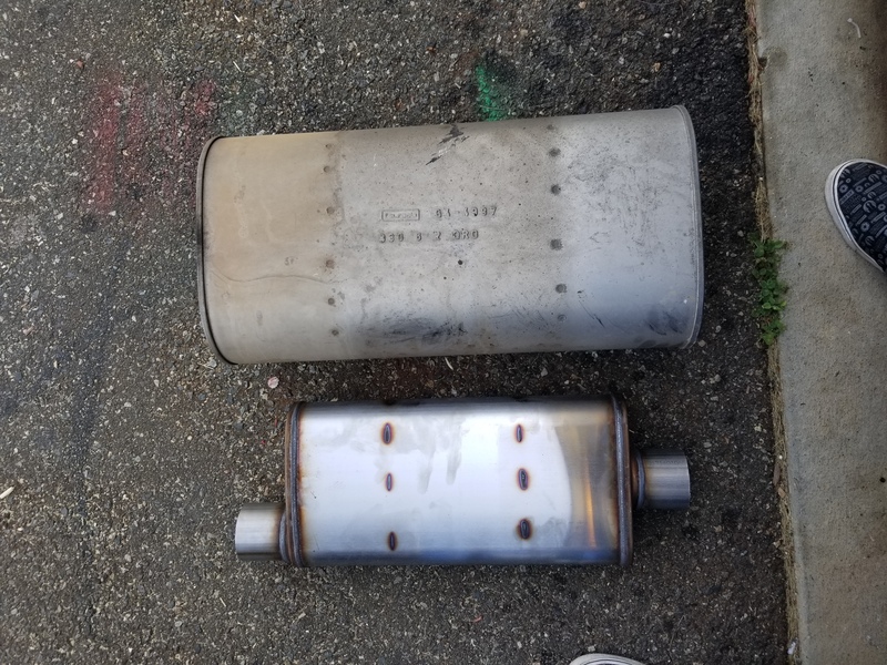

Magnaflow #13259 Muffler
3" ID tips
18" body length
24" tip to tip
OEM Muffler is 24" long as well. I had 6" of 3" ID pipe laying around from another project. So used it to install. Left the stupid flapper valve in. It will be getting cut off soon. Can hear it squeaking in V-4 mode
Really like this muffler. It lets you know there is a V-8 under the hood. But it isn't annoying with windows up. Well worth $75
Side note, the OEM pipe is 2.75" OD. Not 3" OD as I've read in previous posts here on the site.

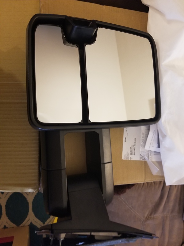

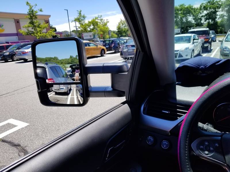

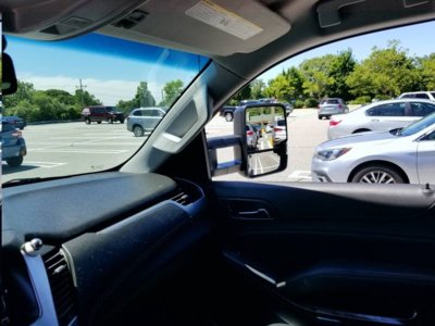

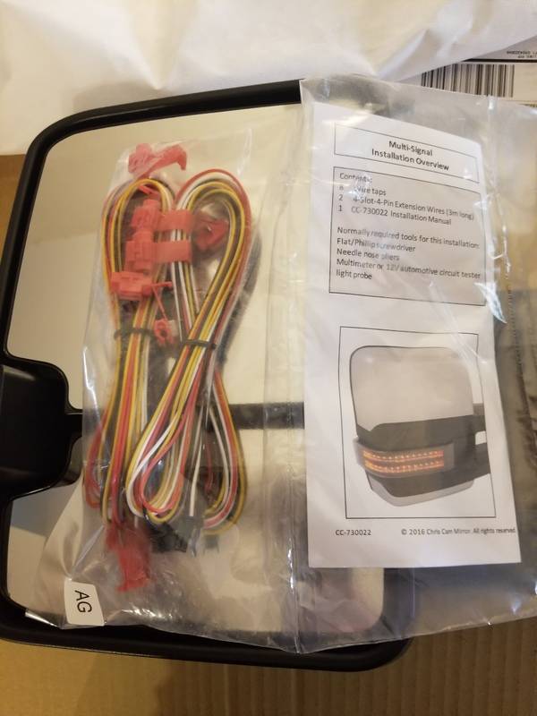

2014+ Silverado Style Tow Mirrors
These are NICE! The bolt right up, electronics clip right in. I have to go back and wire in the running lights and turn signals. The door is wired from factory. But the wire harness in body doesn't have the pin-outs.
I'll get it figured out and post a solution

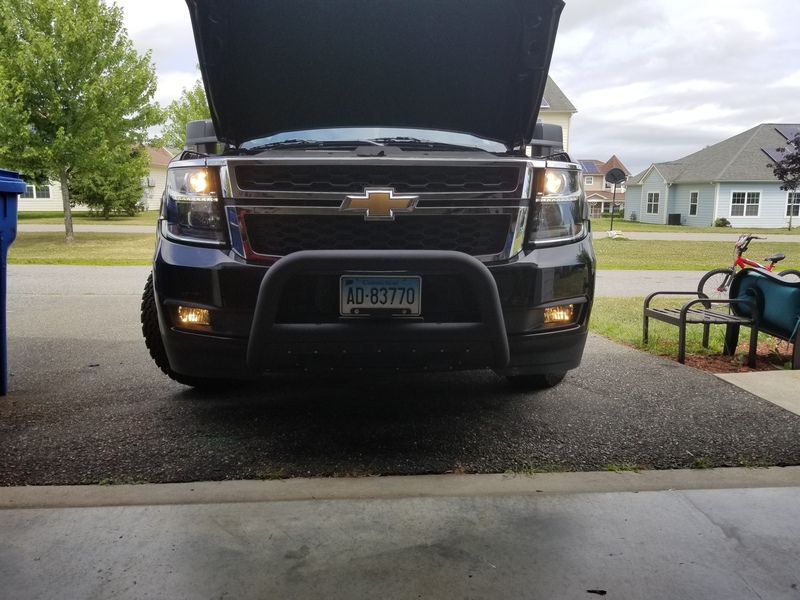

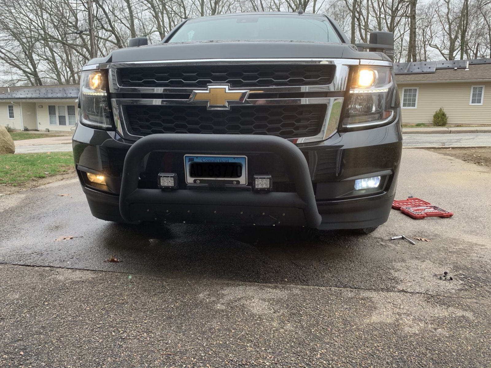

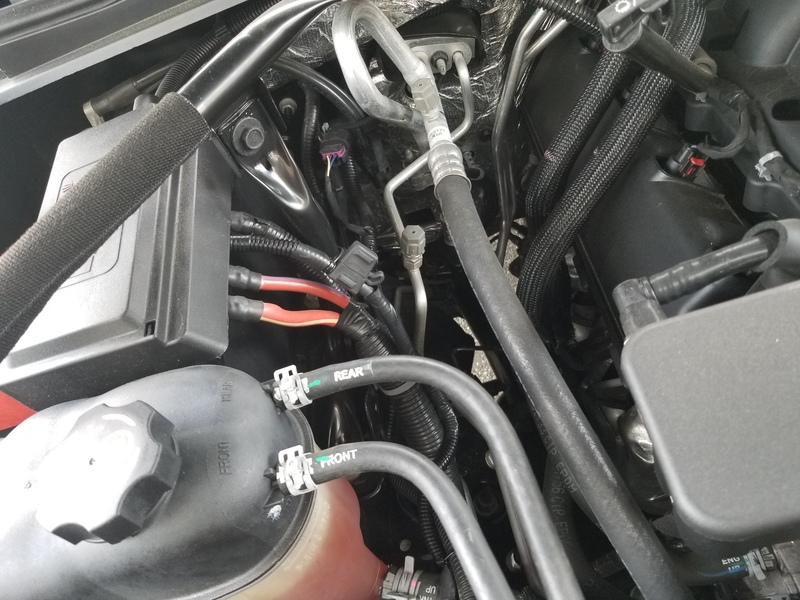

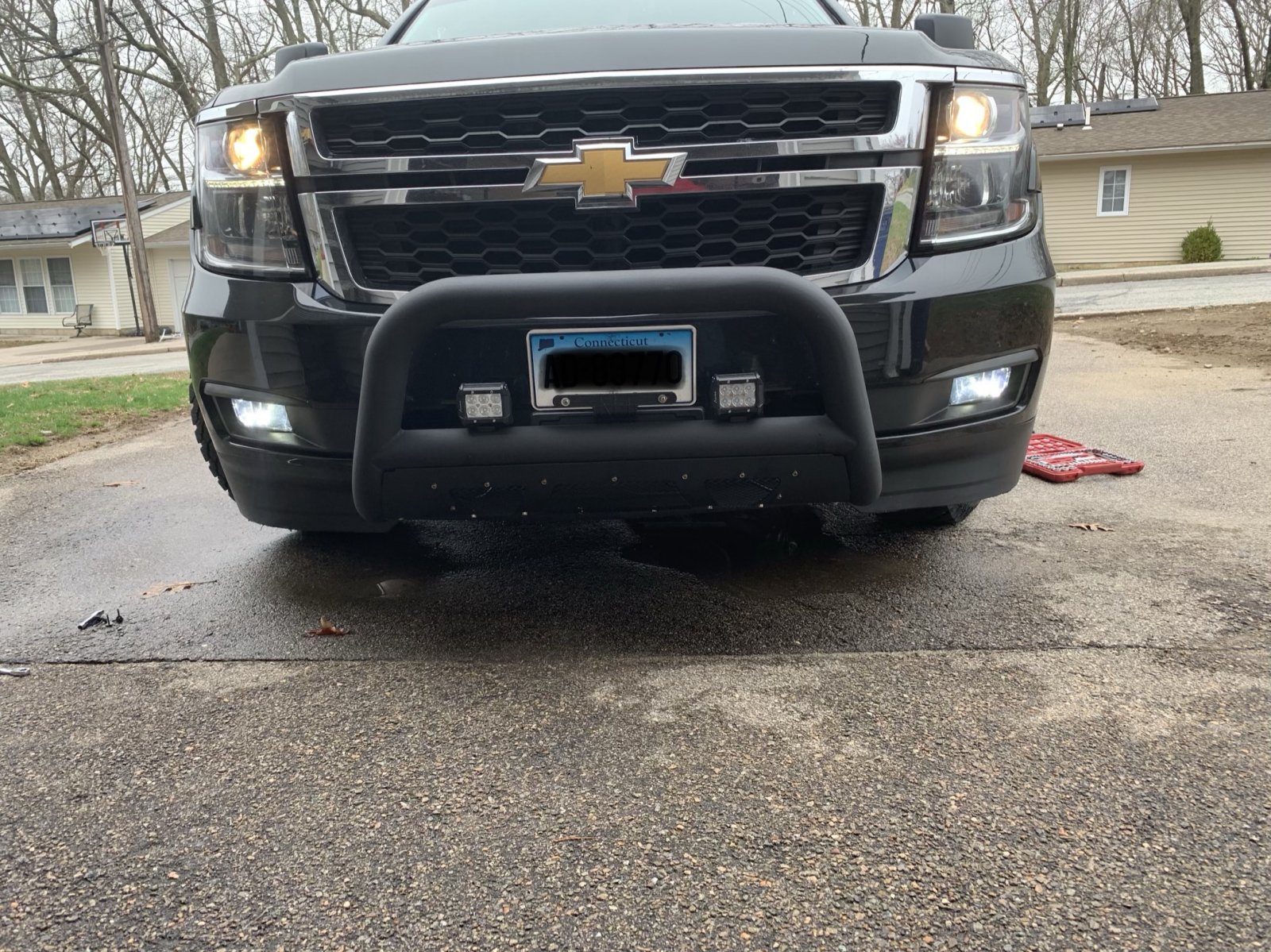

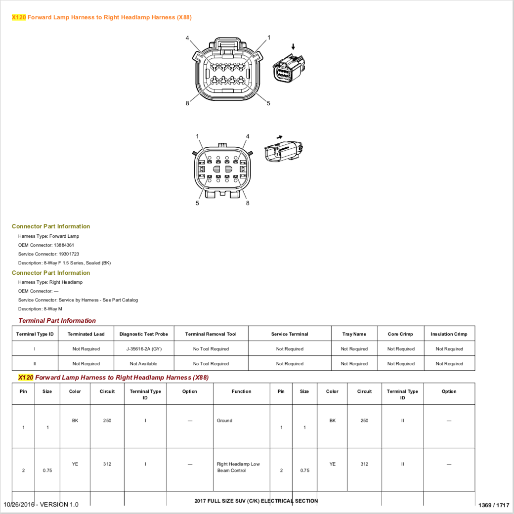

Fog Lights
Came with harness and a switch. I instead wired to the headlight low beams using a relay. So anytime the low beams come on, these come on. Pretty nice. Had same set on my Tahoe for 4yrs, good quality.
The only indication they aren't OEM is the fuse at the battery. I used a stud off the battery to install. Made for nice/clean setup.
Included is the wire diagram for headlights
Screen Shot 2018-07-14 at 14.52.37.png Screen Shot 2018-07-14 at 14.52.29.png 3.jpeg 2.jpeg 1.jpeg

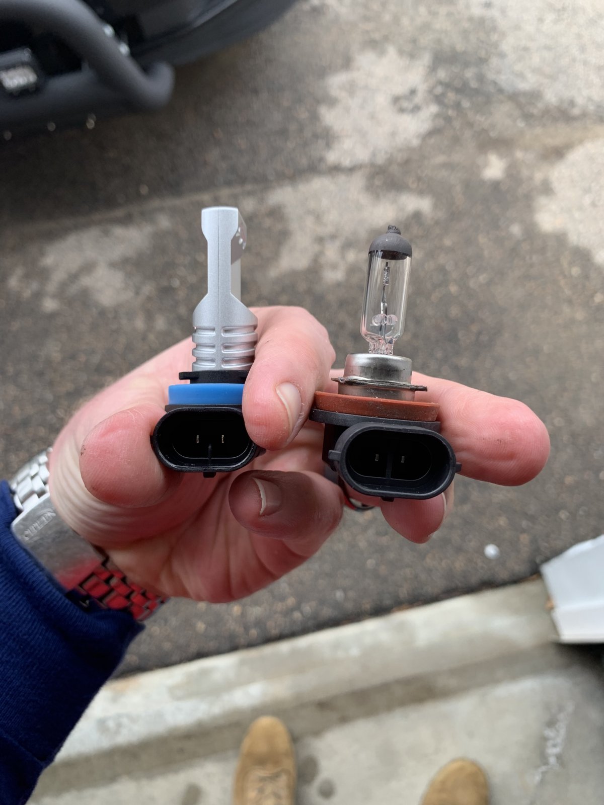

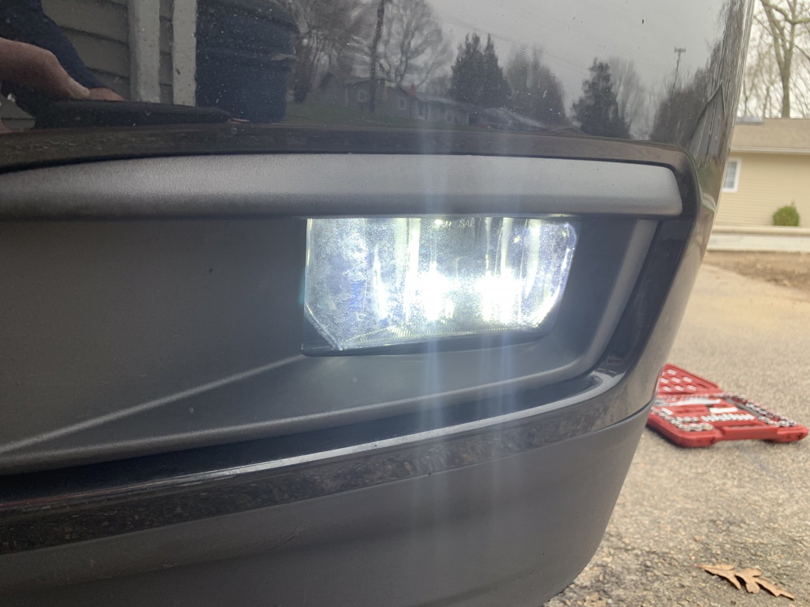

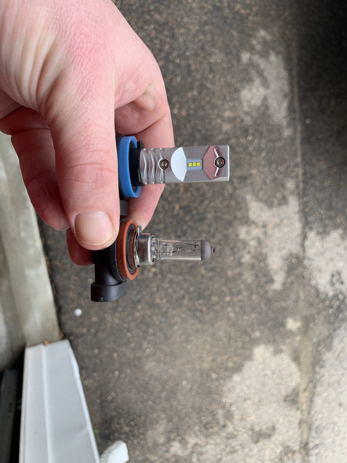

Fixed my fog lights. Had a bulb go bad. So some LED H8 to the rescue
Will be swapping to LED heads at some point

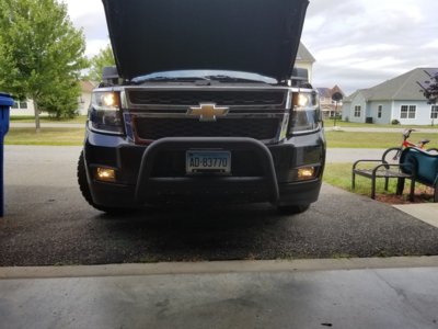

Installed some LED low beams. Waiting until dark out to check new beam. But in daylight they made me see stars lol

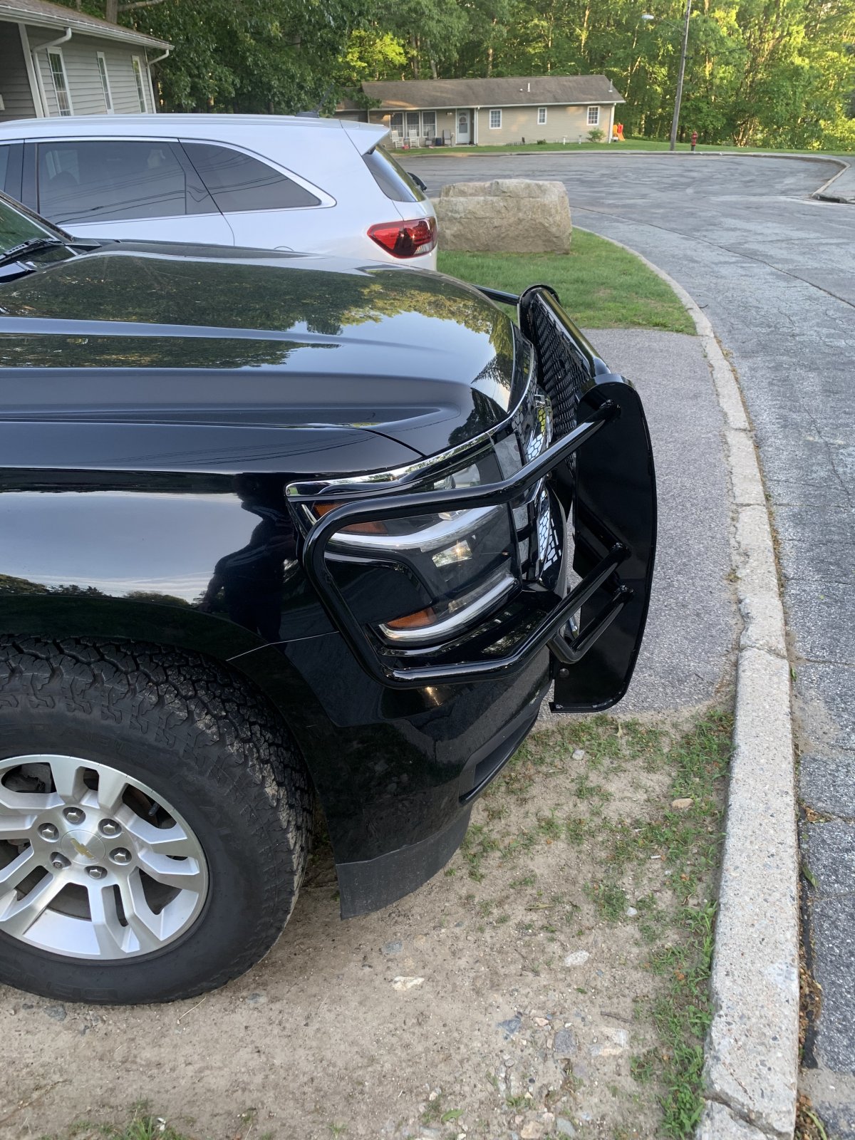

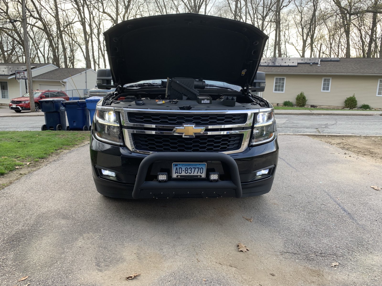

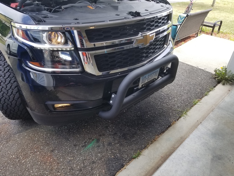

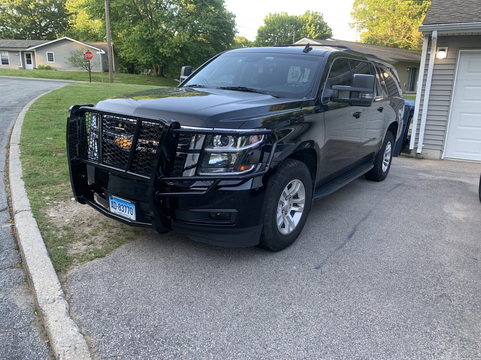

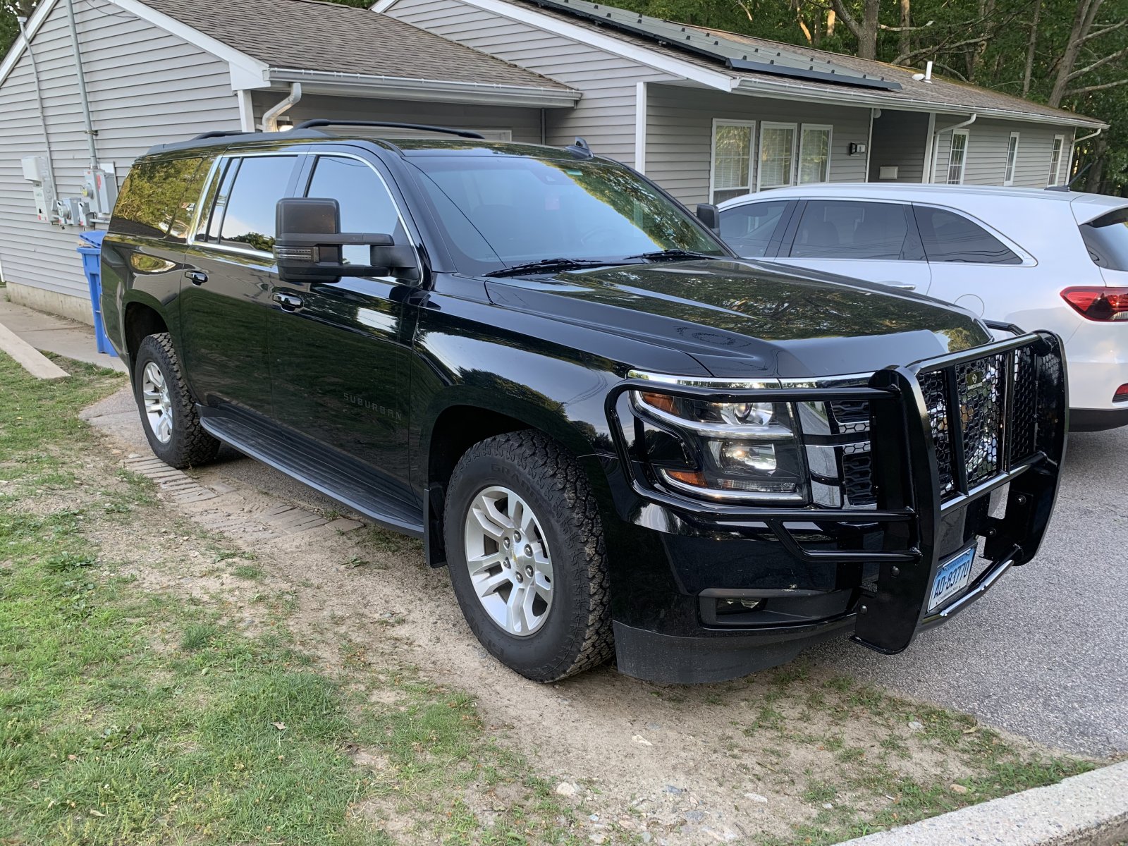

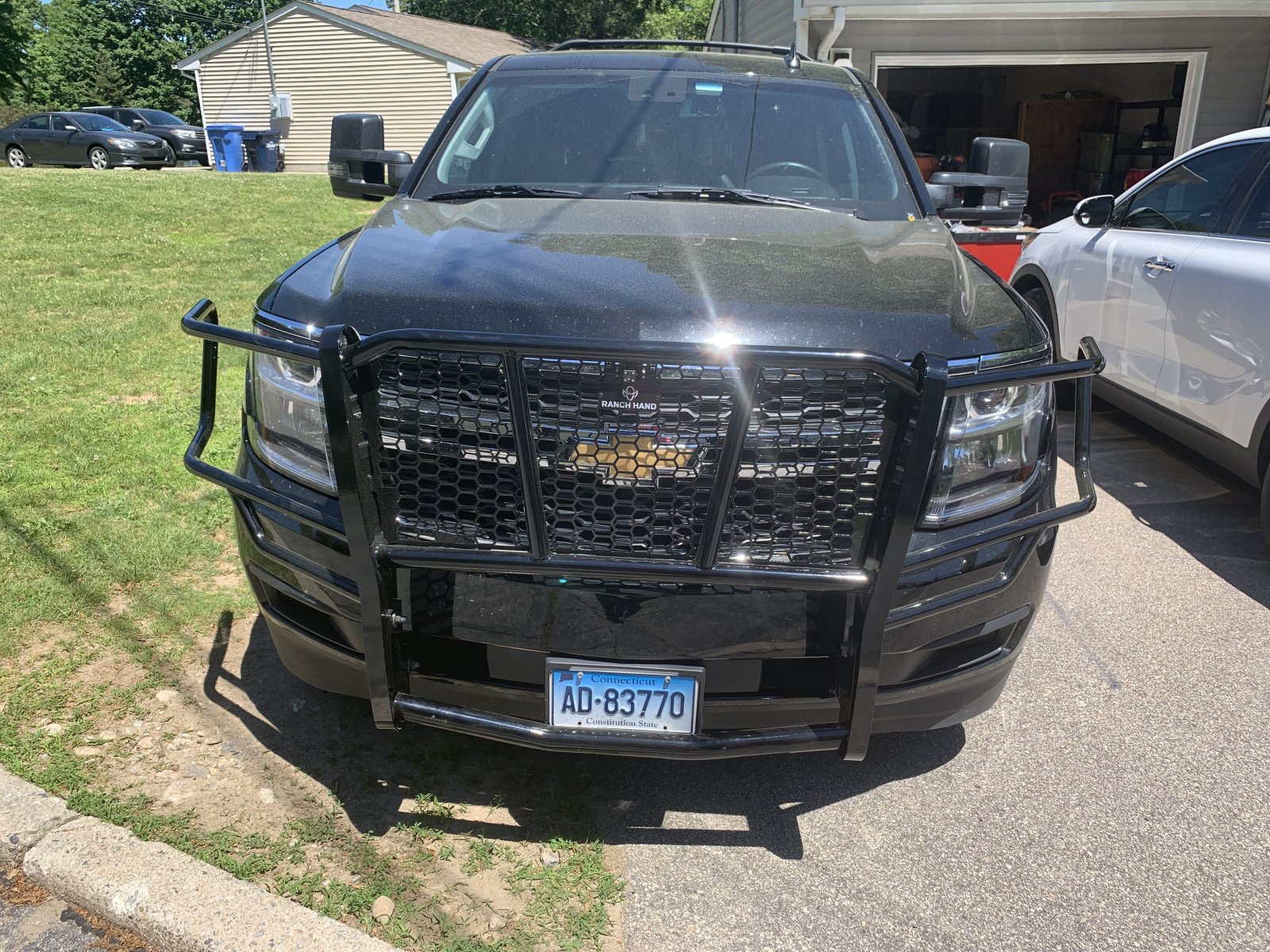

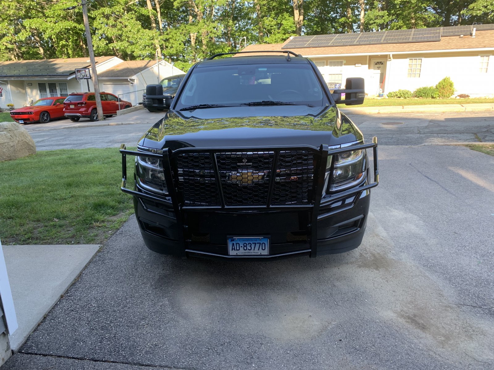

i like the ranch hand over the bull bar
Absolutely. Lol
The bull bar was to keep New England drivers off my bumper in parking lots. I can’t tell you the number of times I had to reset the position because some ****** bumped it

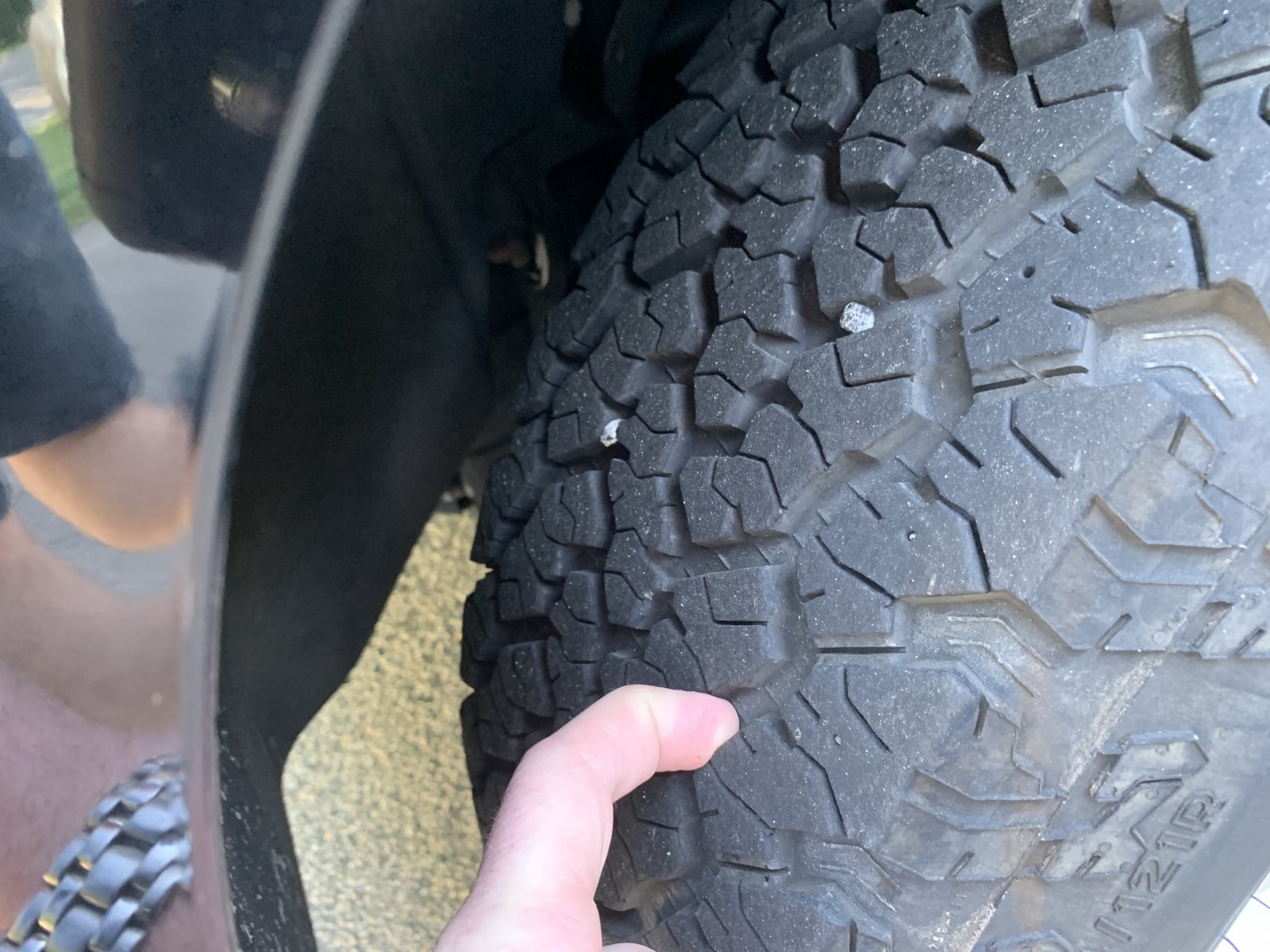

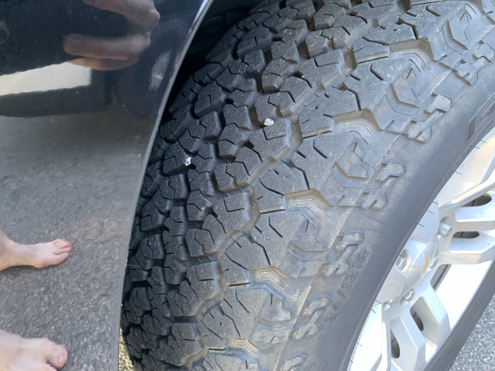

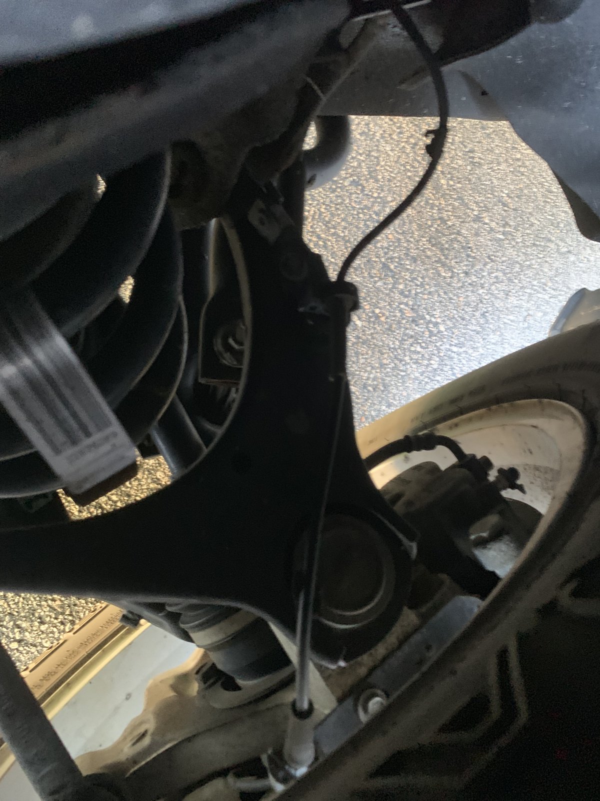

How much clearance do you have on your tire at full turn (UCA)?
Tylus
Tylus
Dec 24, 2013
373
151
South GA
265/70R18 General Grabber AT/2 tires
since I kept the same width, it's the same clearance to UCA as the original 265/65R18 tires. On paper the new size is 0.5" taller. But the tires I bought are E rated and super deep tread. Ended up over 1" taller overall. Speedo is off by 2 mph at highway speeds
YukonXLMan
May 21, 2019
86
89
Would you buy them again? How is the road noise at highway speed? Any howling? MPG take a hit?
Tylus
Tylus
Dec 24, 2013
373
151
South GA
They do have a “hum” at 60+ mph when newer. As they wear it quiets down significantly . It isn’t loud at all. Windows up and can’t hear at all. I’ve always ran Mud tires, so these are quite nice.
I may have taken a mpg hit. But she still pulls 23-24 mpg on the long trips. City is somewhere around 15 mpg. Not shabby
I will buy them again. Here they are with about 25k miles of wear. My only complaint is they pick up pea gravel that gets stuck in the treads. We drive 99% paved though, so not really a detractor. But could be if I lived down a dirt/gravel road.
Here is a shot of the UCA clearance
D6DA8284-A3E0-4EA9-BF25-574843E00569.jpeg 9D22C7E1-8091-41D1-A314-F846EF23CC32.jpeg EF65785F-A384-4CDF-A5EF-FA81904A589A.jpeg

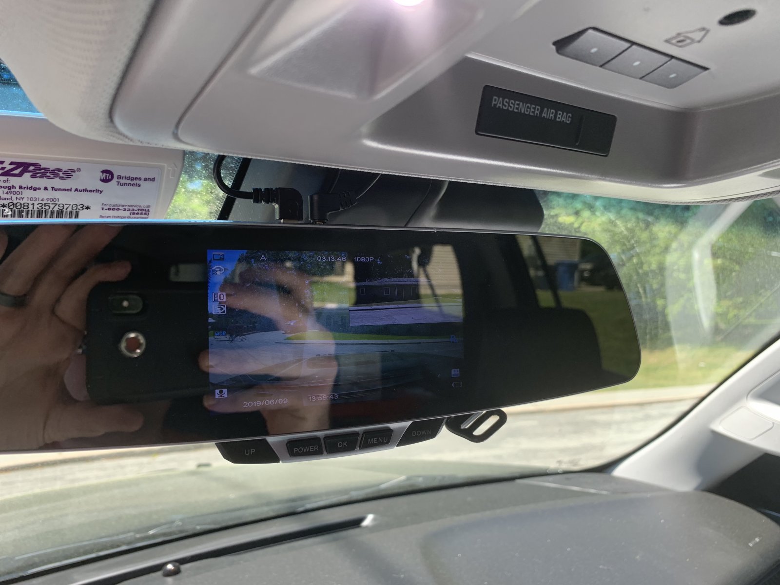

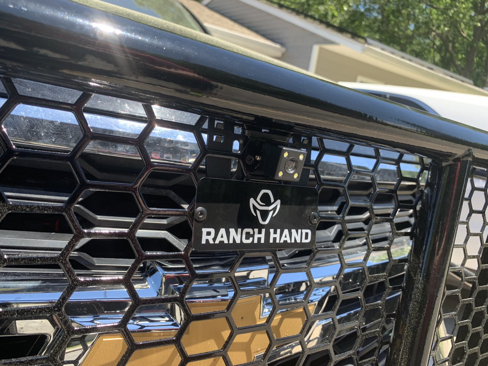

74A41070-C298-44DD-8AB2-2D365D938FBE.jpeg DDFE48FD-7E94-4050-B05E-73635771D5FC.jpeg 2ED12003-7F15-408F-861F-3042CCBBA4E0.jpeg Added a camera to the ranch hand. Don’t want to hit anything
For now am using my driving camera to view. I am researching a dash monitor setup. Can’t find something I’m happy with yet
