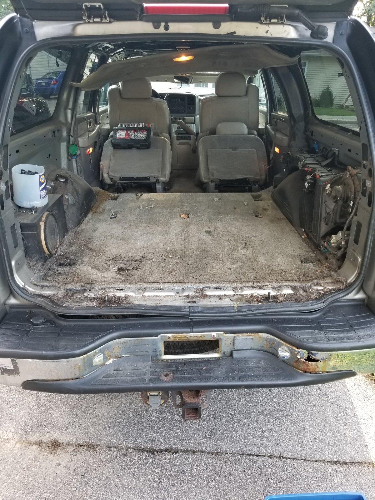

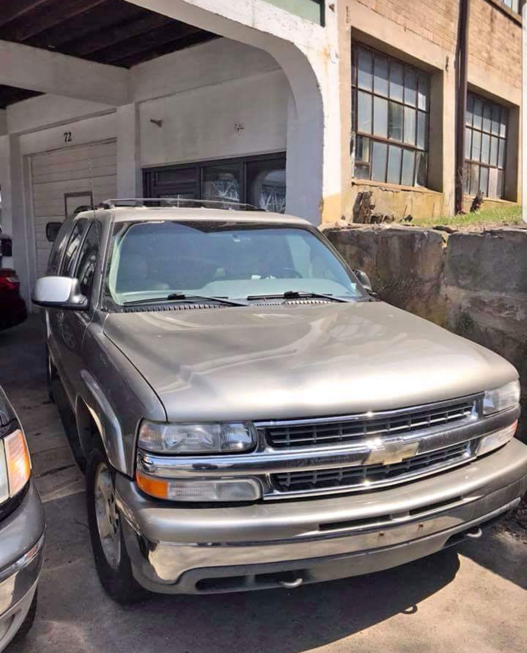

Paid $300 for a 2001 Suburban LT with 282,000 miles. Runs, drives, and has ice cold AC!
Previous guy had parked it due to blown brake line. And at some point he left the moonroof open due to it refusing to shut. So interior got super wet and mold/mildew set in.
It looks ugly inside and stinks. But every single widget/electronics work. This is to document the repairs and other stuff I do to it.

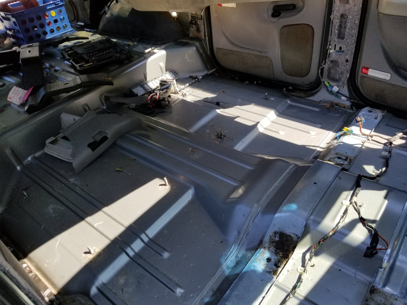

1. Gut the interior and kill the mold - DONE
2. Pressure wash interior - DONE

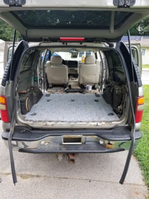

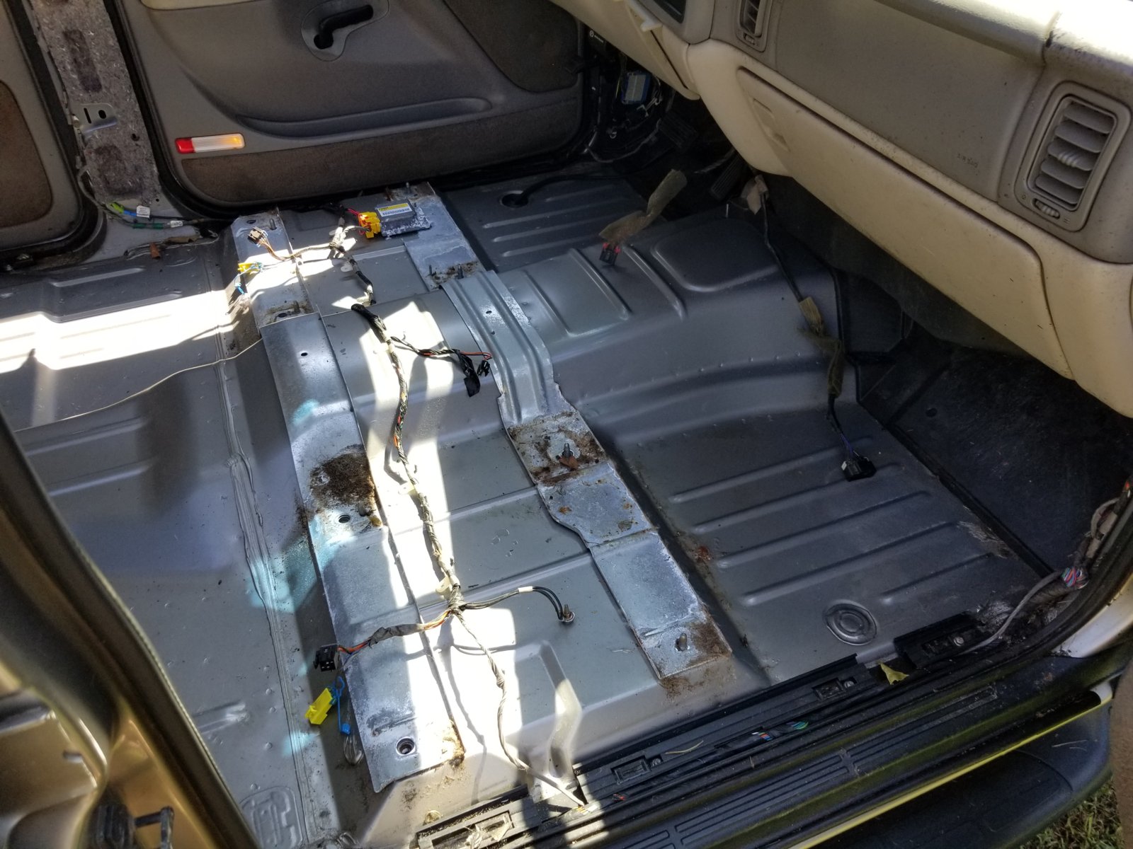

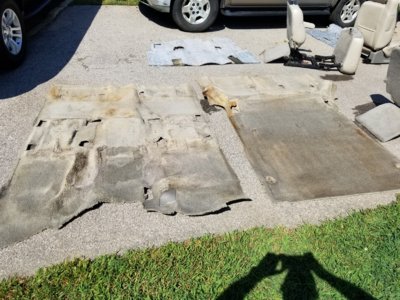

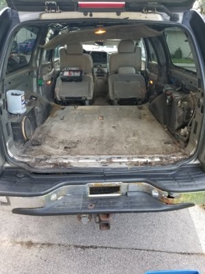

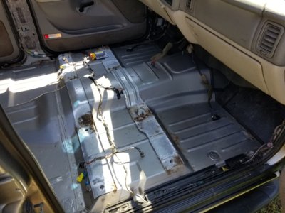

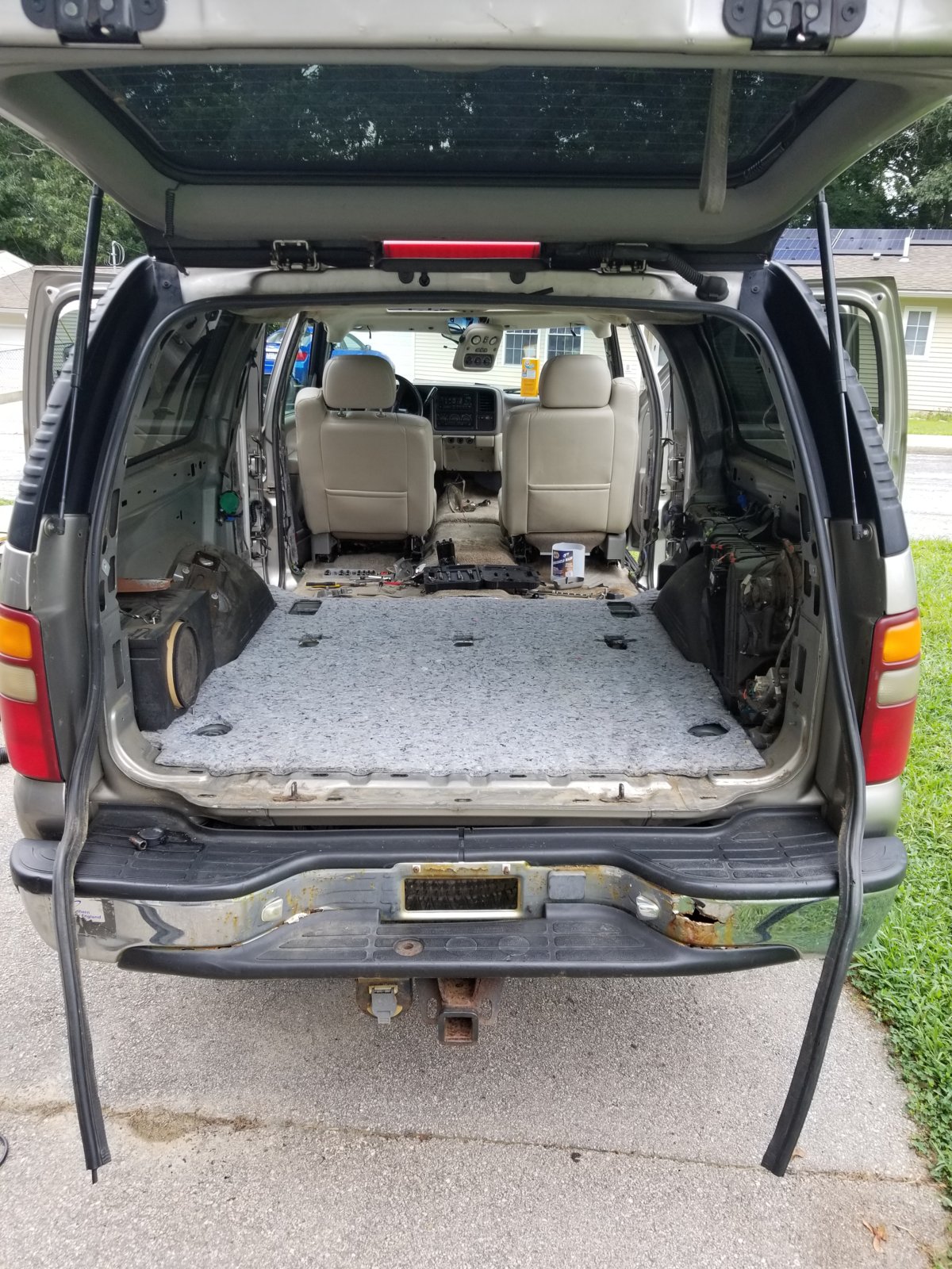

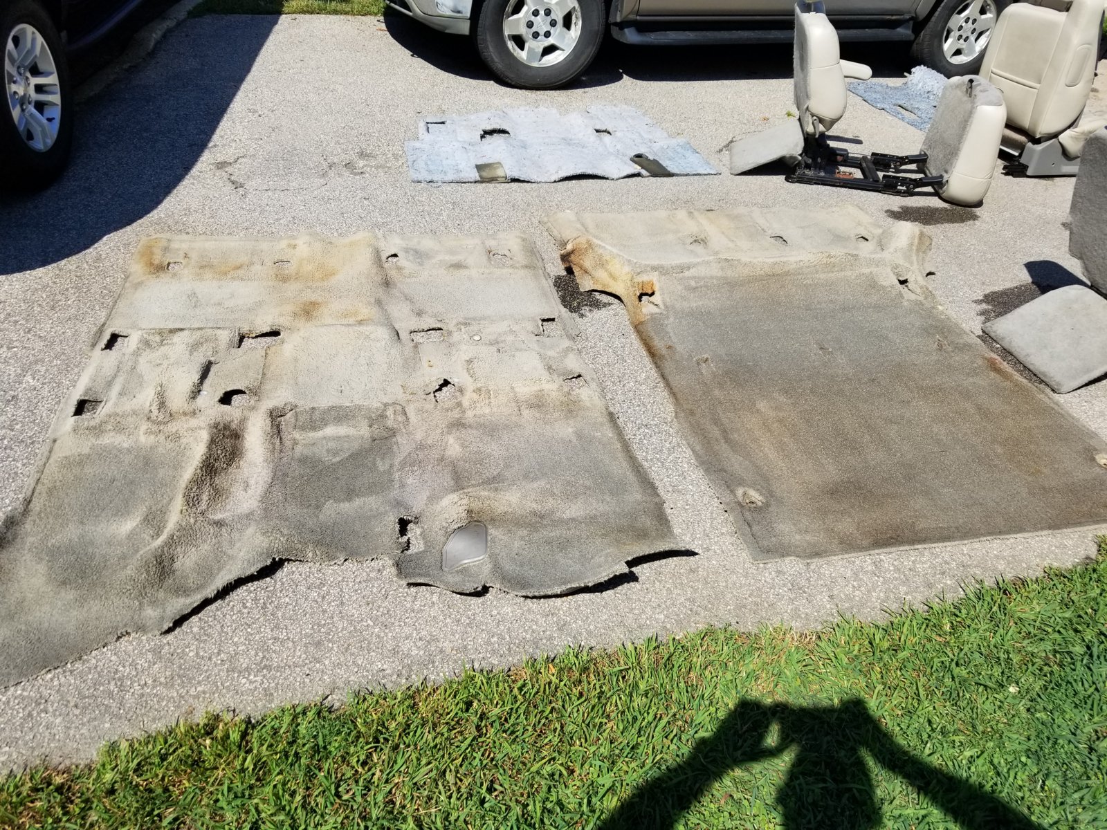

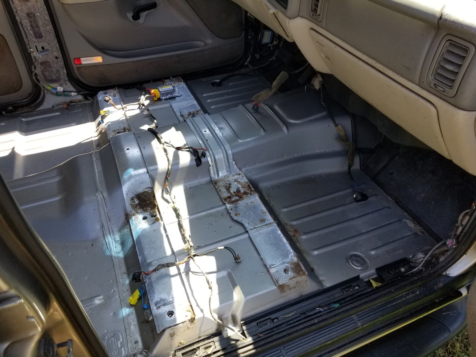

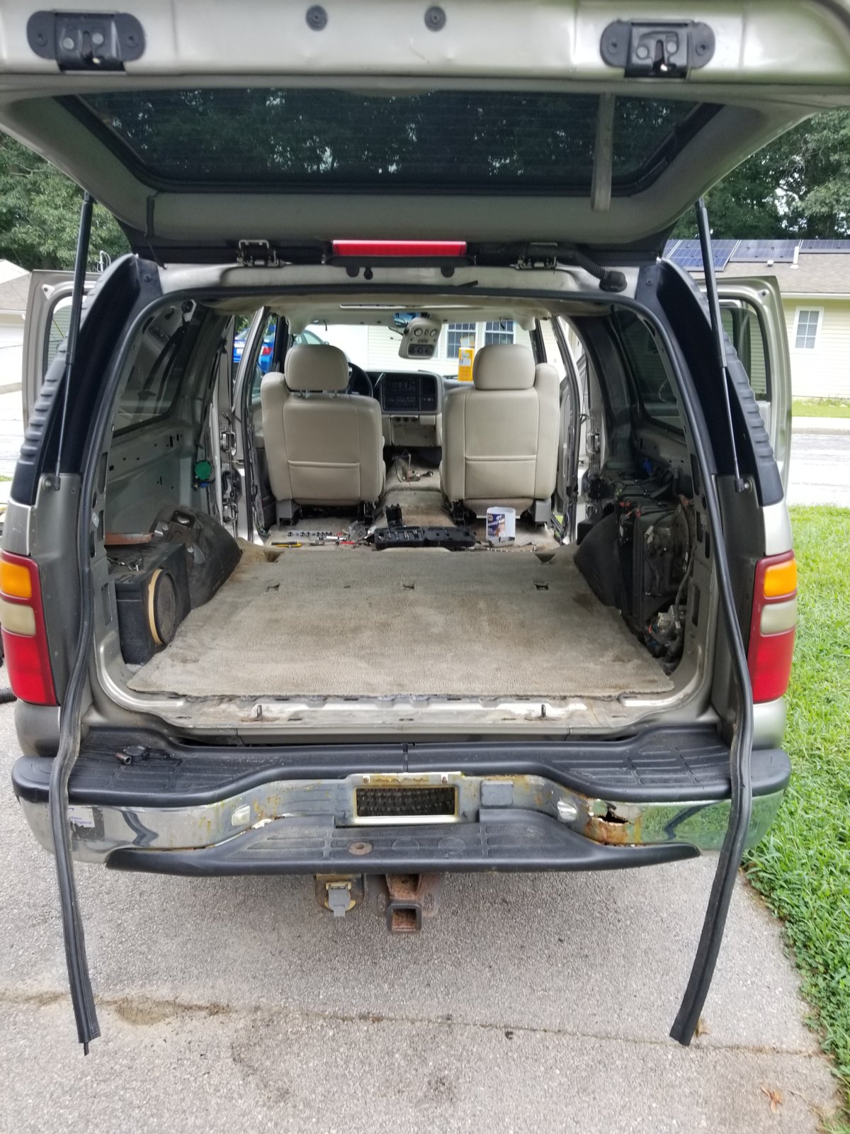

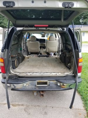

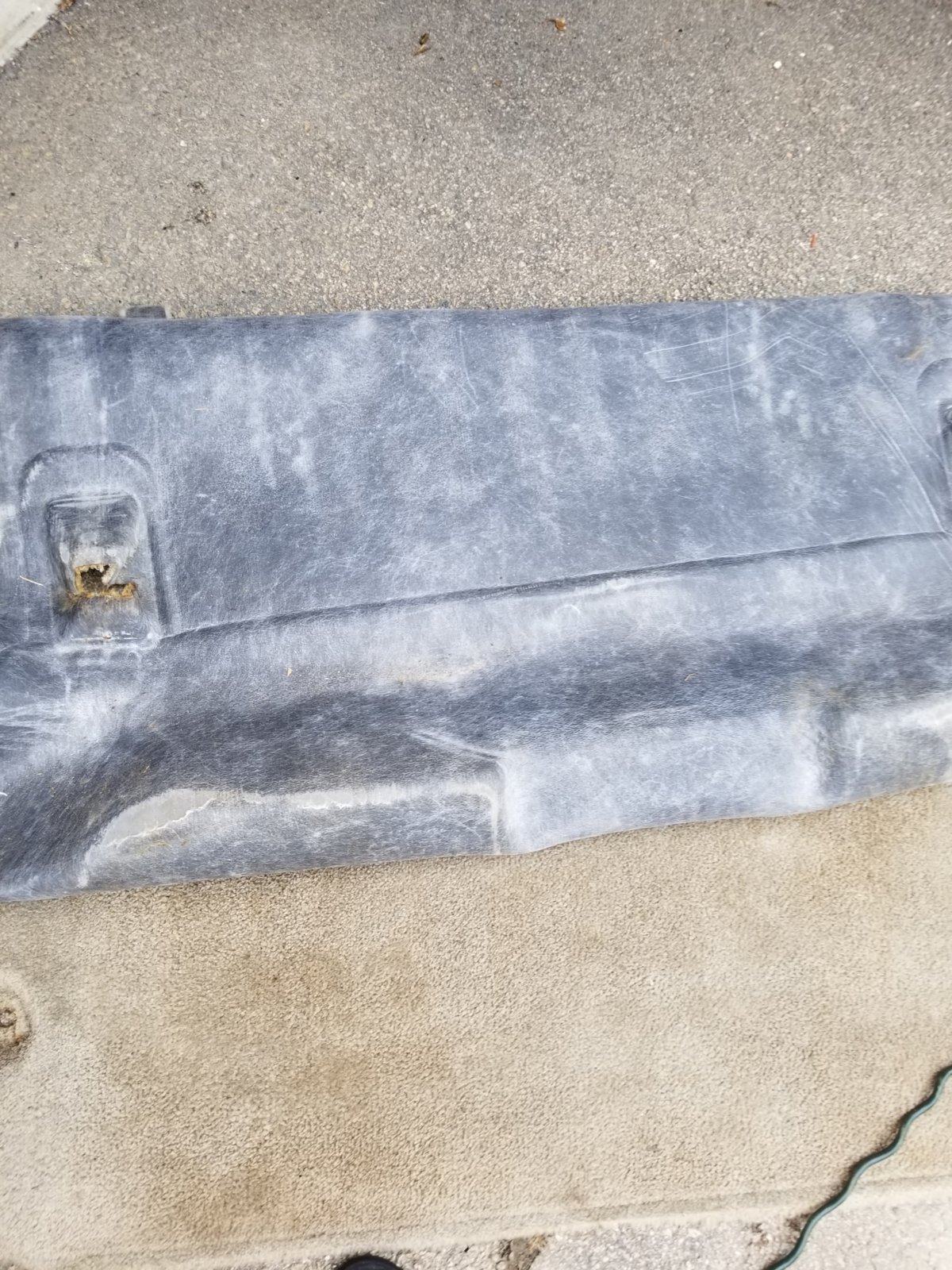

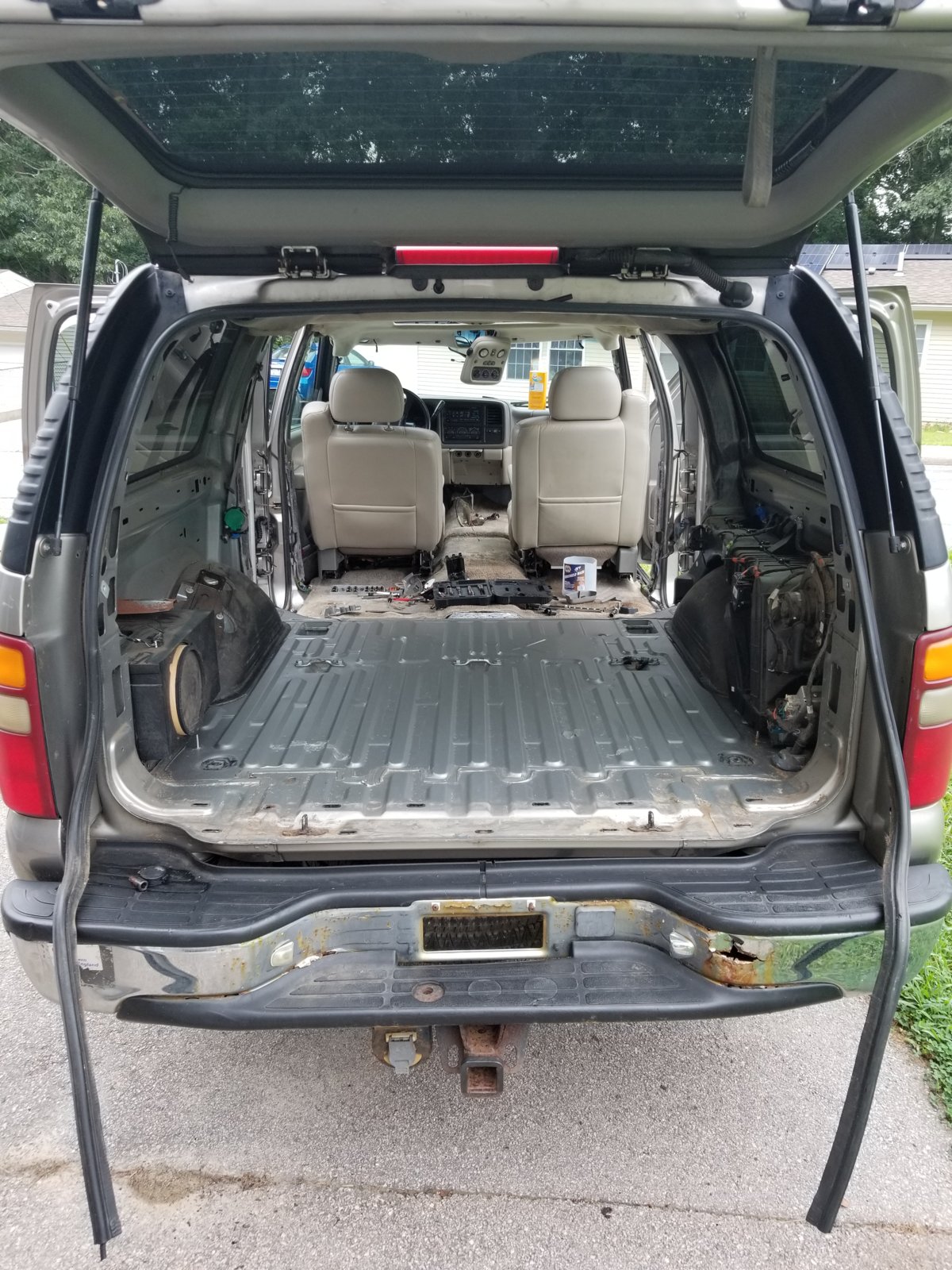

Soaked carpet with Purple Power and then pressure washed everything. I'm happy with results
Cab looks like its brand new. Not 17yrs old!
I should be able to use all the seats even. Obviously a cover for the drivers until I get a replacement

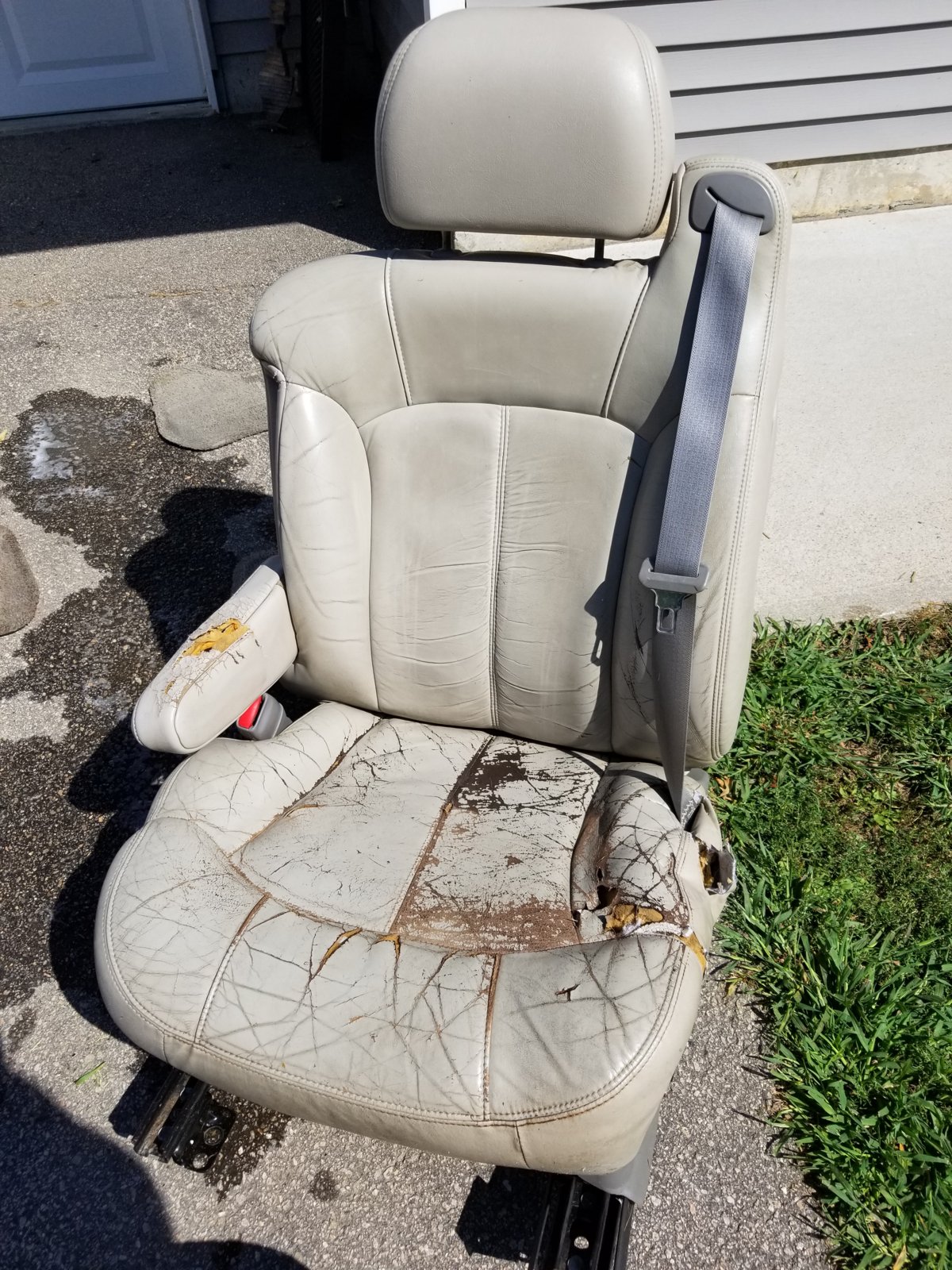

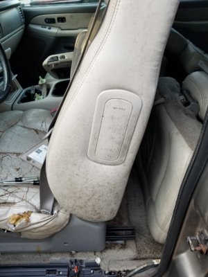

South GA

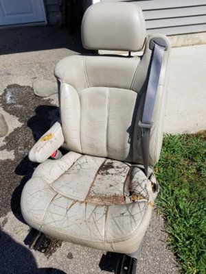

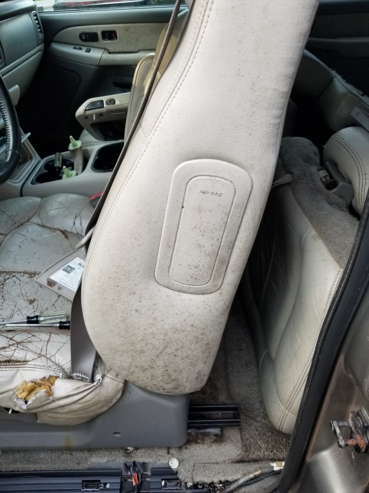

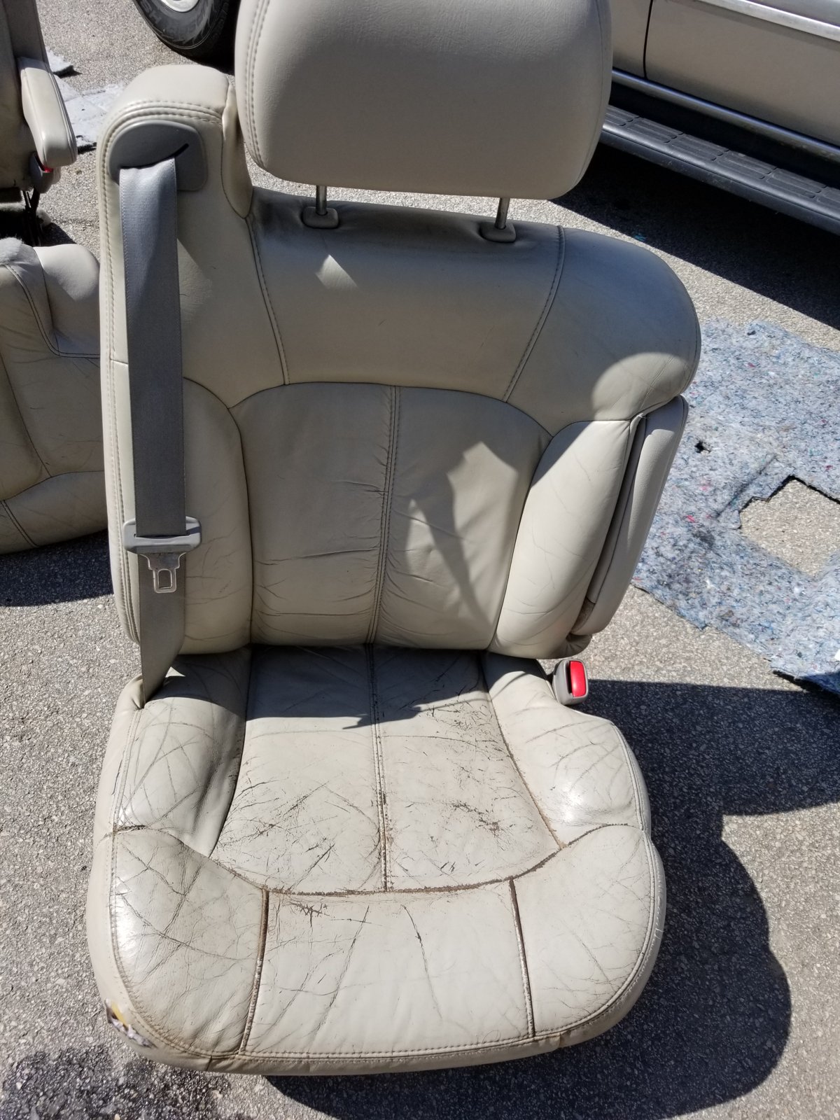

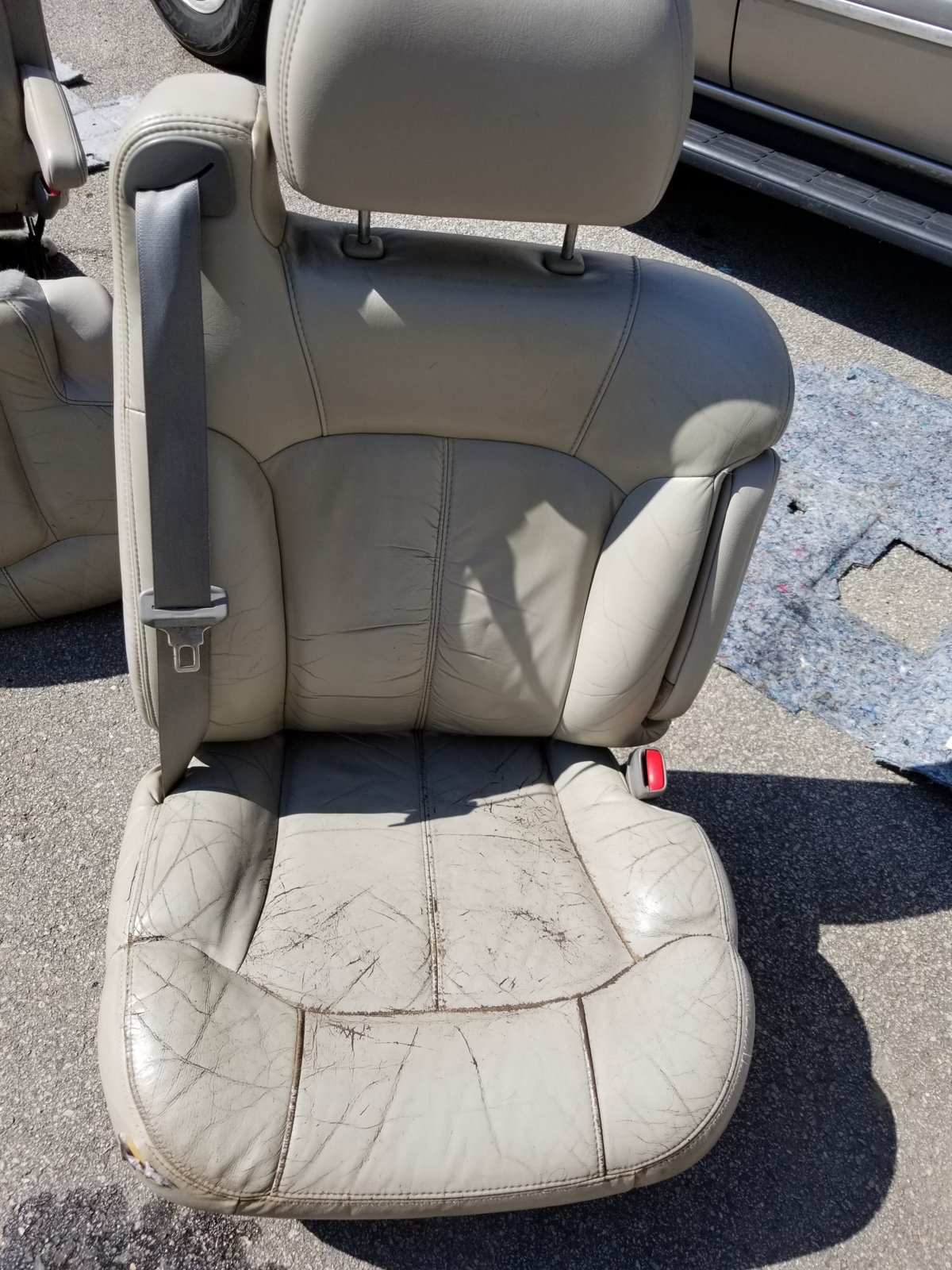

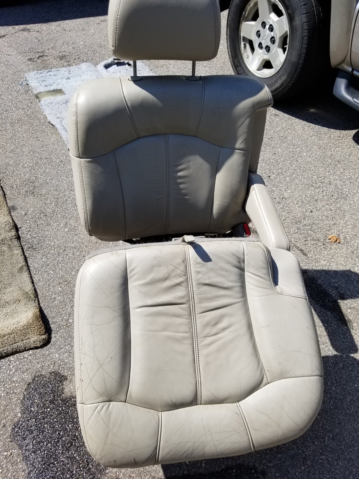

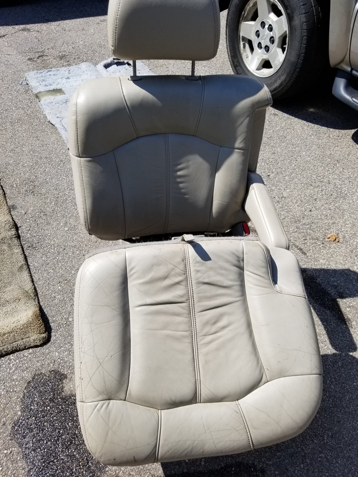

All seats are mold free now. This seat needs some love

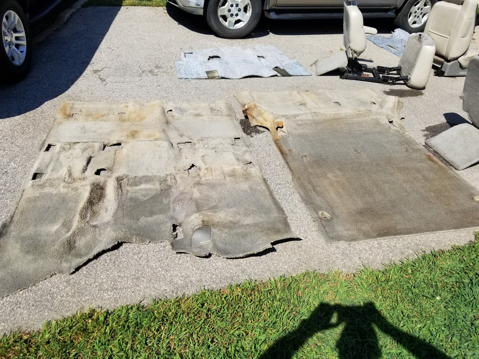

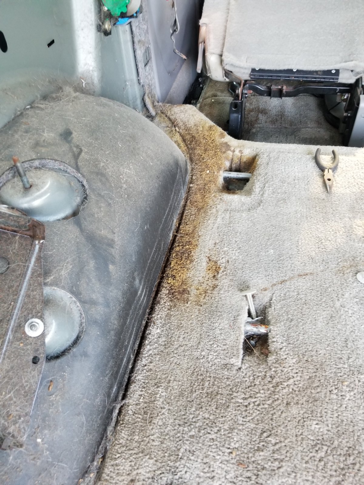

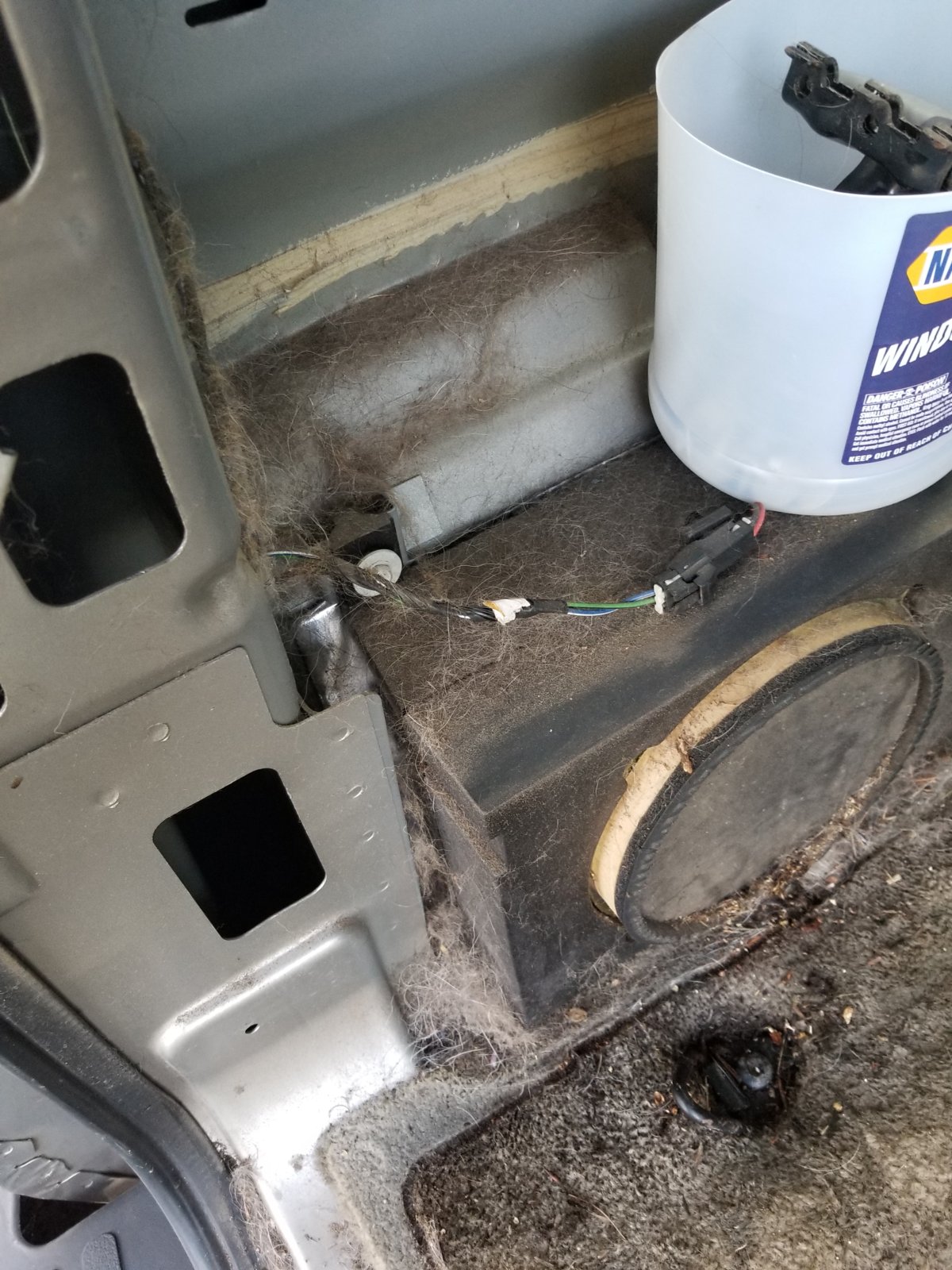

Making some progress. Interior is clean and smells good now. The carpets have permanent stains from 17yrs and dogs...but I dont feel the need for a bath now after touching them. My shop vac is utterly full of dog hair. Think German Shepherd
I am still going to get a seat cover for the drivers seat. Maybe. I found replacement seats for $100 each up front, and someone has middle buckets for $50
Cool fact, the carpet is backed with a waterproof membrane

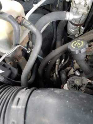

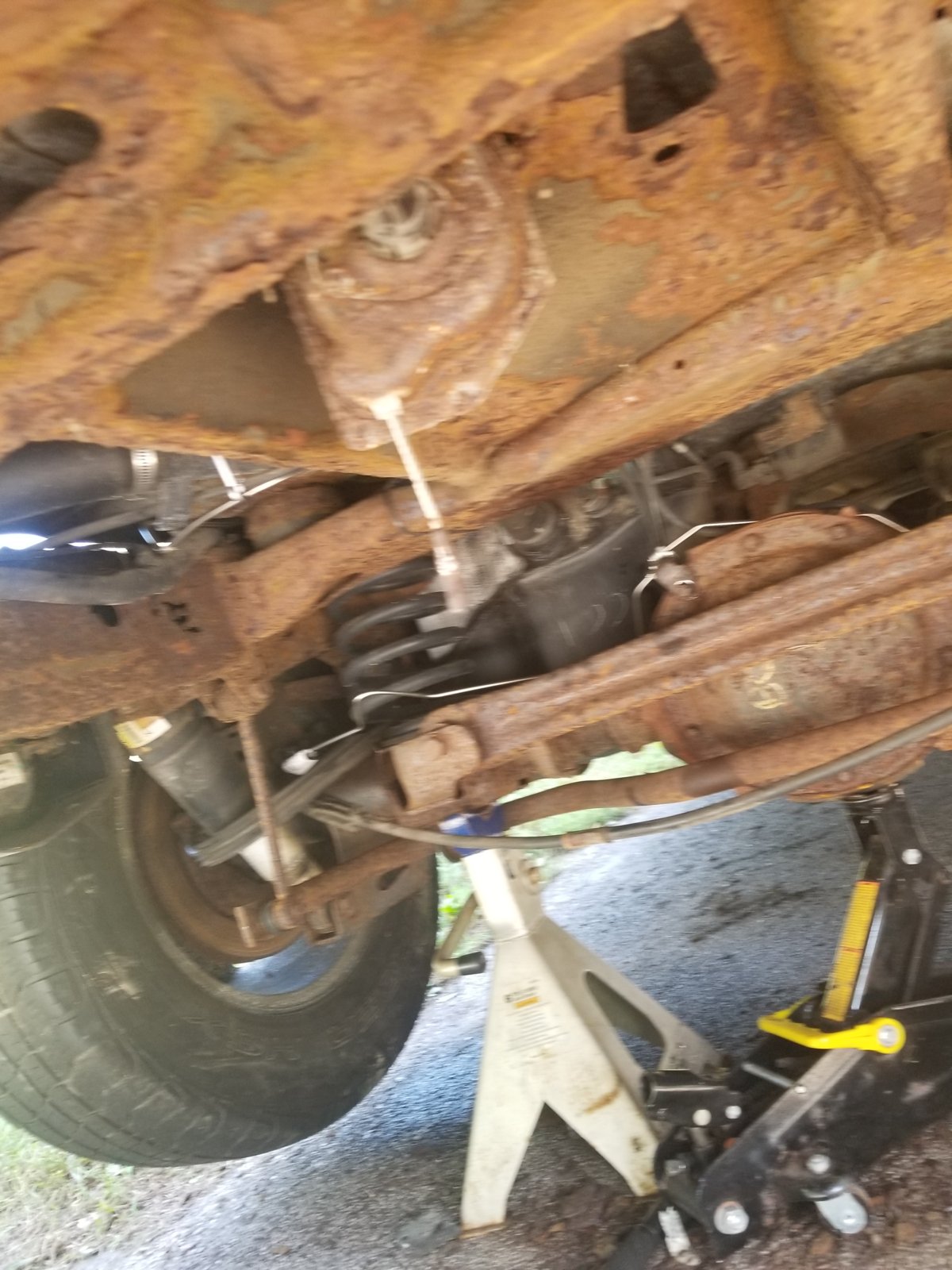

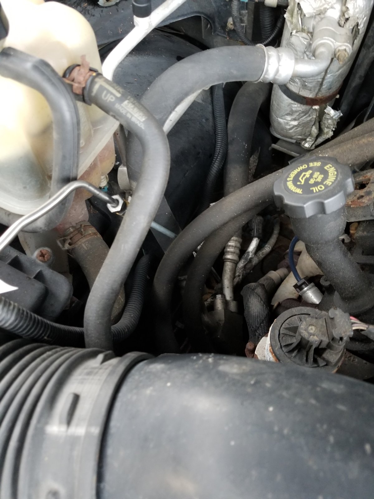

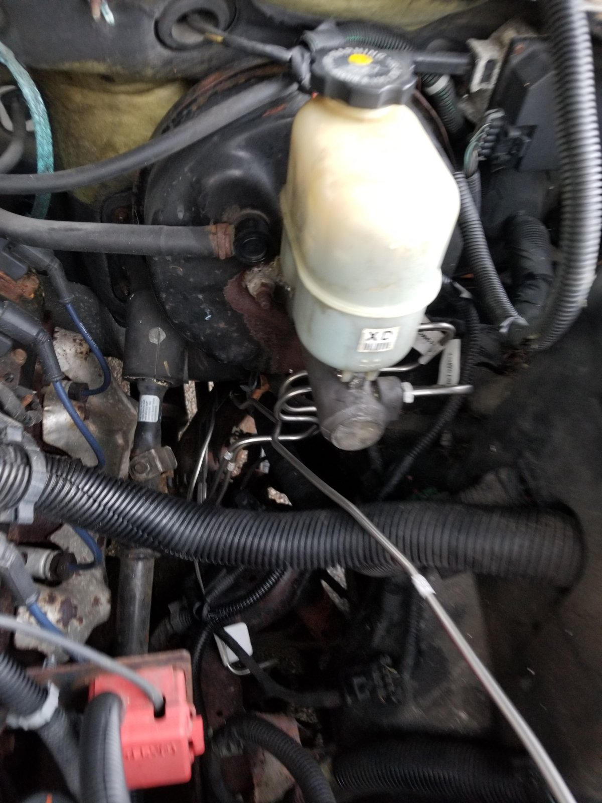

Got the stainless steel brake lines installed. What a fight.
Did 2 things my own way.
1. Wasnt going to take rad out, so I routed the front right up and over (see pics)
2. I ended up fishing the rear main line along the frame rail like it's supposed to be. Someone in the past had run a NICU line over the gas tank.
I need to hardcore bleed the system. Pressurize the master with 5-10 lbs of air and have fun. Wish me luck, will attempt after the hurricane rains ease up

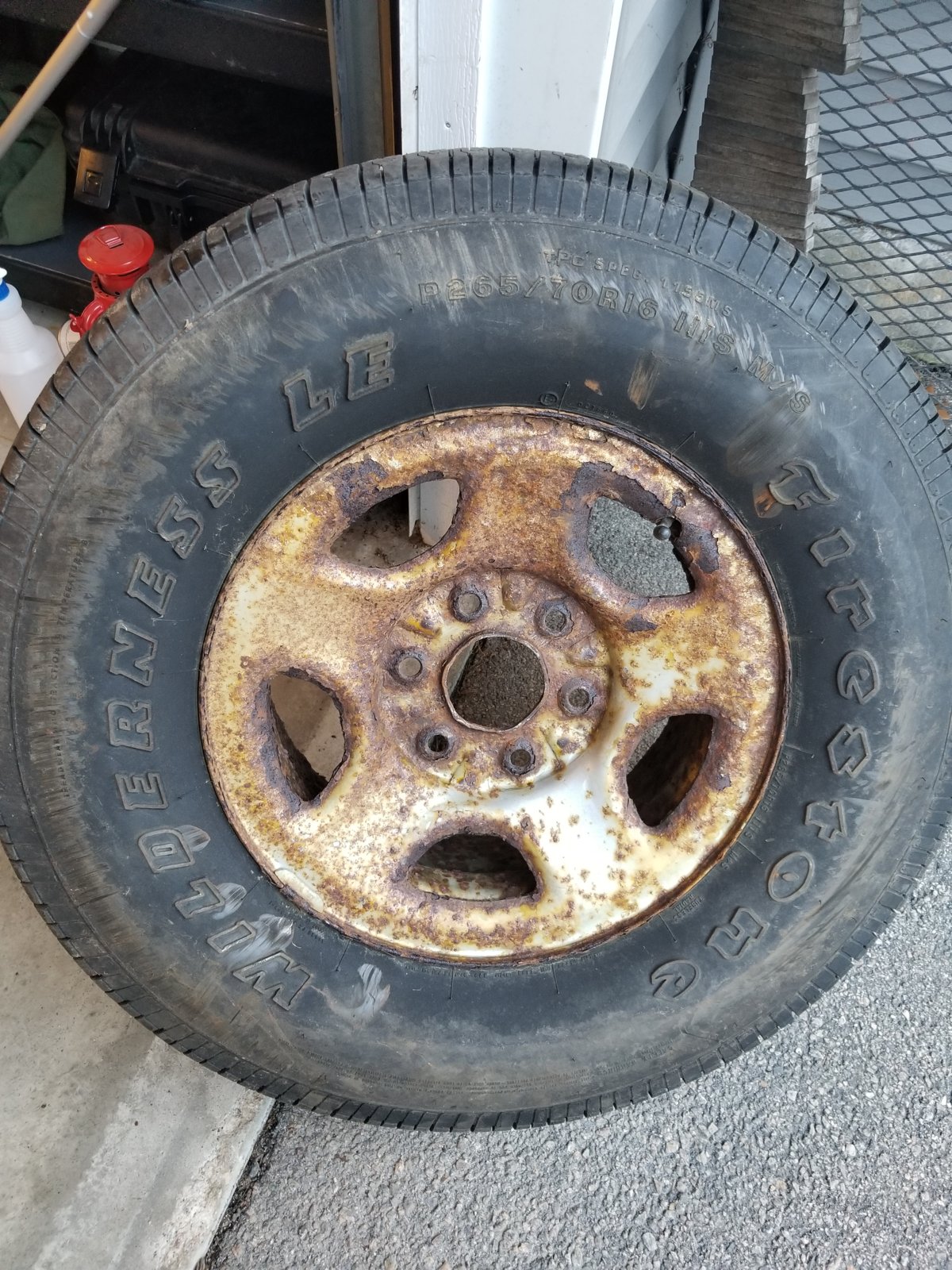

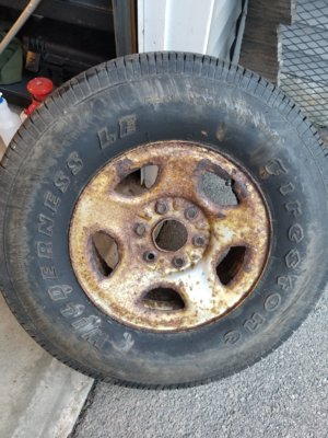

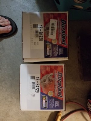

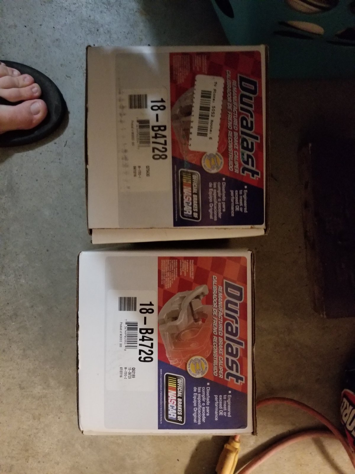

hard and soft brake lines are all replaced. Went to bleed the brakes and I can't get a single bleeder to come loose. Both rear ones snapped flush with the caliper. Fronts are just tiny rusted remnants
I spent around 1 hr trying to weld build-up on the bleeder. I was able to weld a nut on 2x. But each time the weld material failed and the nut popped off. That bleeder is on there good.

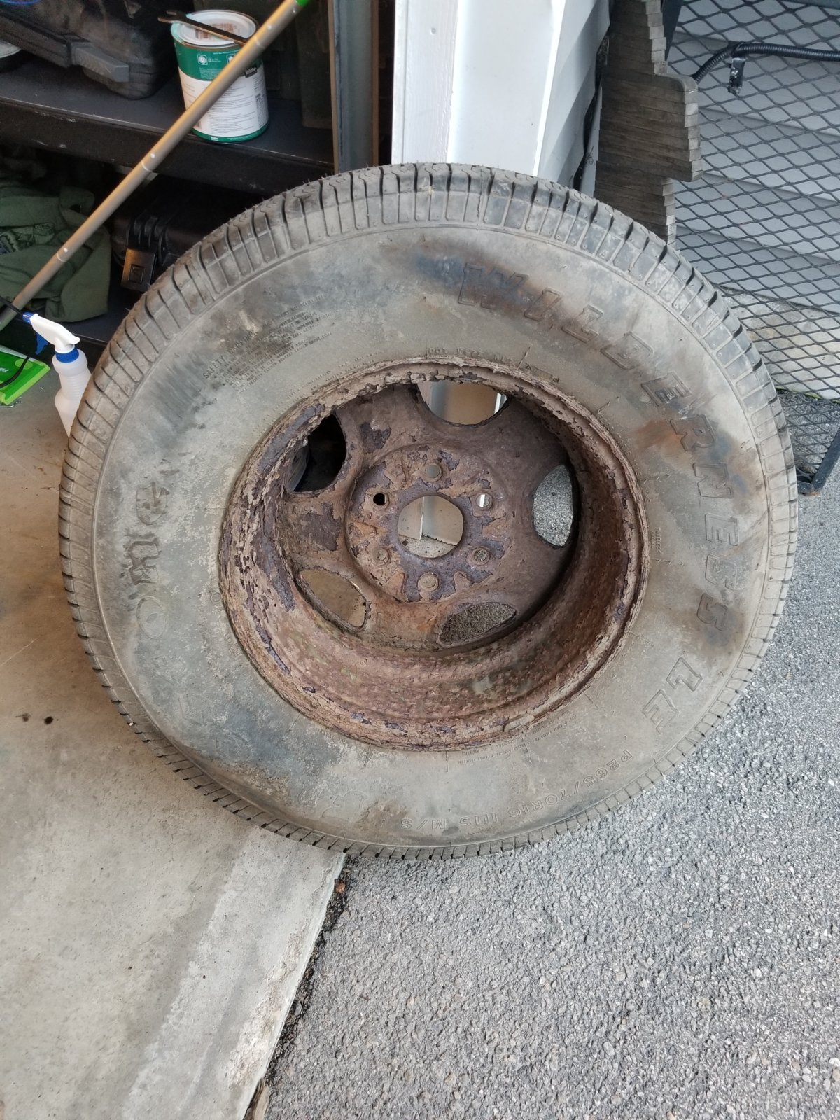

To access the rear axle lines, I had to cut the spare tire out. it's the original Firestone from 2001...the one they were recalling. Wonder if Firestone will honor a warranty replacement of it? lol
per my usual shopping method, I got on Facebook Marketplace and found new front calipers, rotors, and brake pads for $100. They're Duralast, but it was 1/3 the price of buying from Autozone. Trying to find another good deal locally before I fork over $120 for new rear calipers
