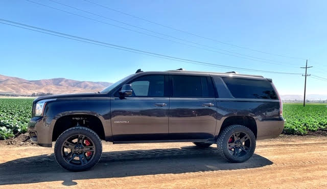

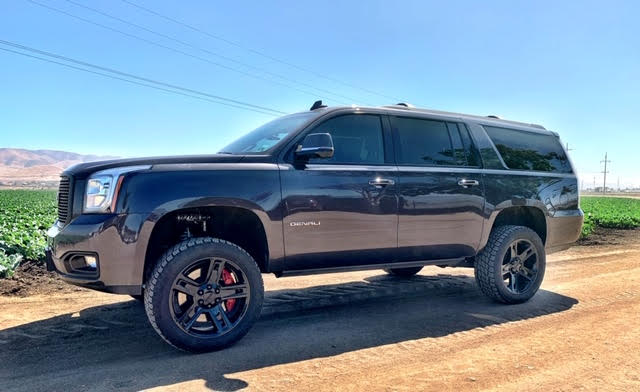

2017 Denali XL BDS 4" with Fox coils and rear shocks. MRC delete, night and day ride quality!!
Bryingram4
Jan 2, 2017
53
71
San Diego CA
I have 8k miles on it so far, nose never settled. I ended up swapping the rear to the 4" kit. Still love everything about this kit, wish I did it day one. No regrets on the MRC delete
View attachment 221805 View attachment 221806

I didnt keep the auto rear level option, I just swapped to fox 2.0 rear. There is another thread about swapping to an oem rear auto level shock without the MRC function. To clarify, I no longer have MRC nor rear auto level function any longer. I’ve only seen 2” and 6” link extensions for the auto ride arms. Have to fab something for the 4” When I said I swapped to the rear 4” I had to, swap for 4” coil drop brackets, extended sway bar links, bumpstop extensions, and rear trac bar recollection. This was all purchased from BDS. When you order the kit from them there are two options for the rear. I swapped from a rear 3” to their 4” version.
