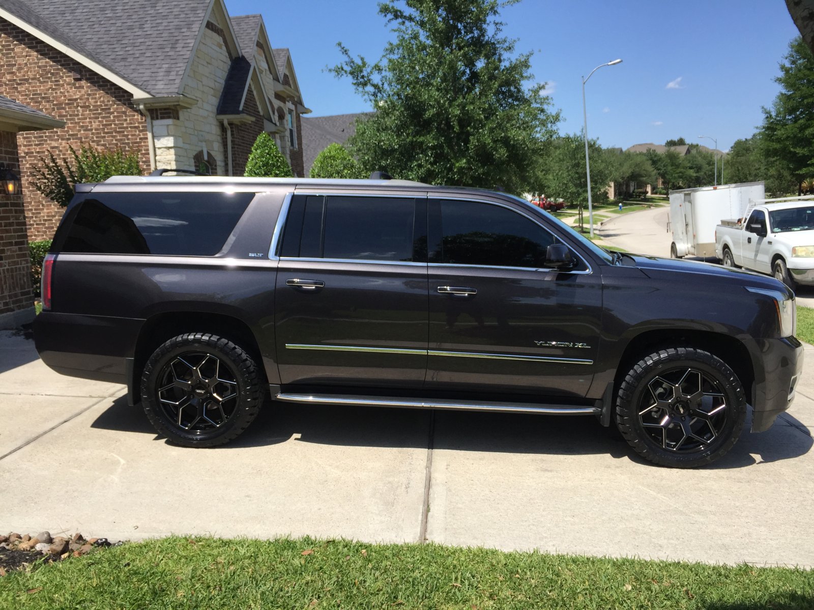

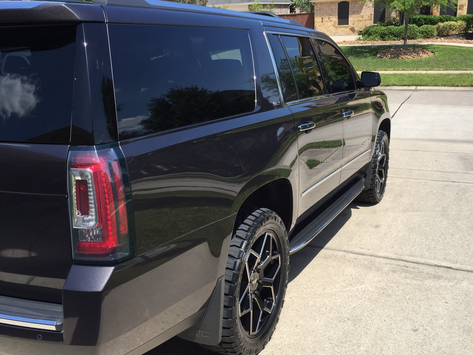

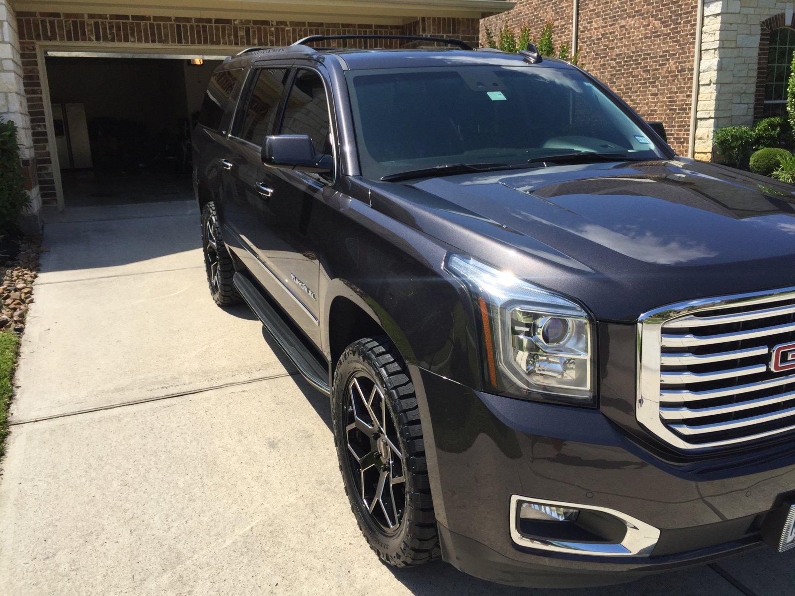

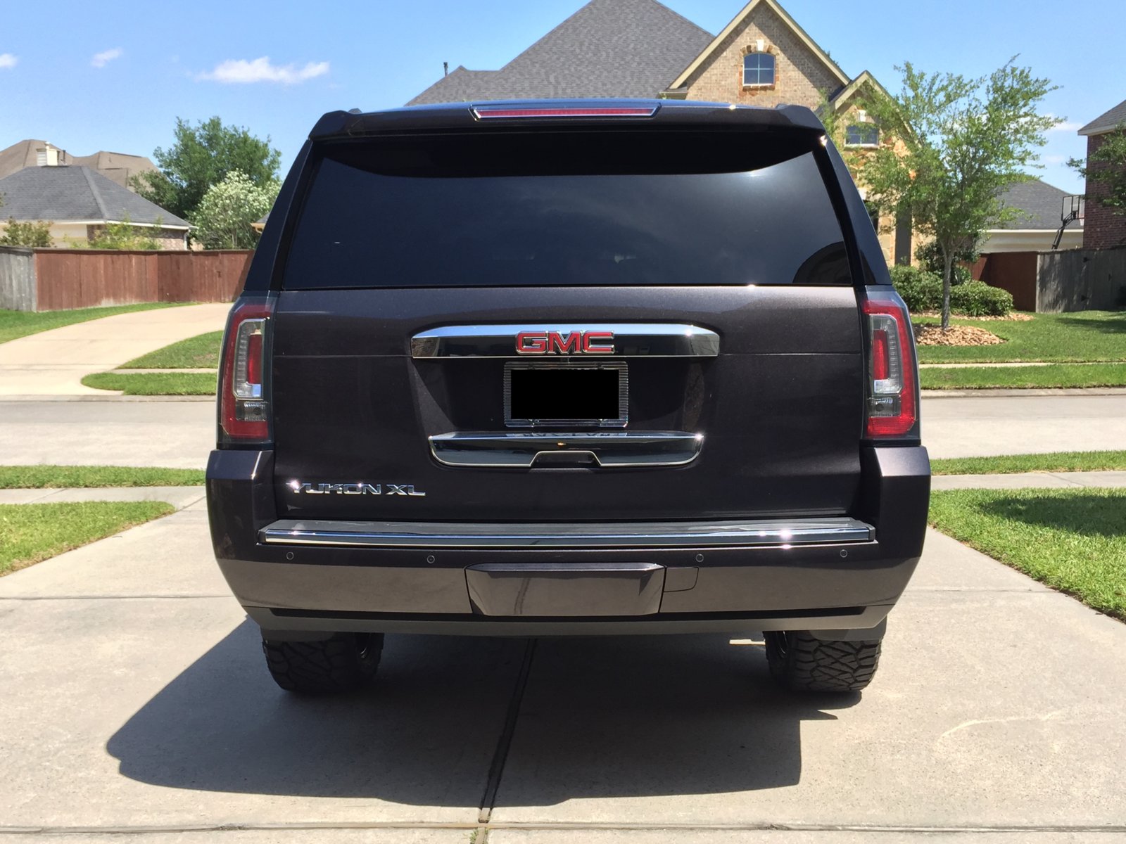

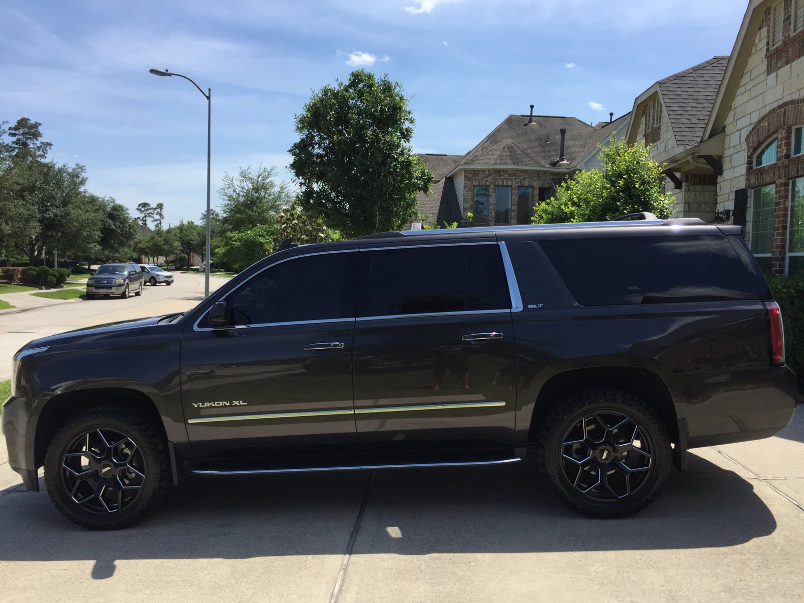

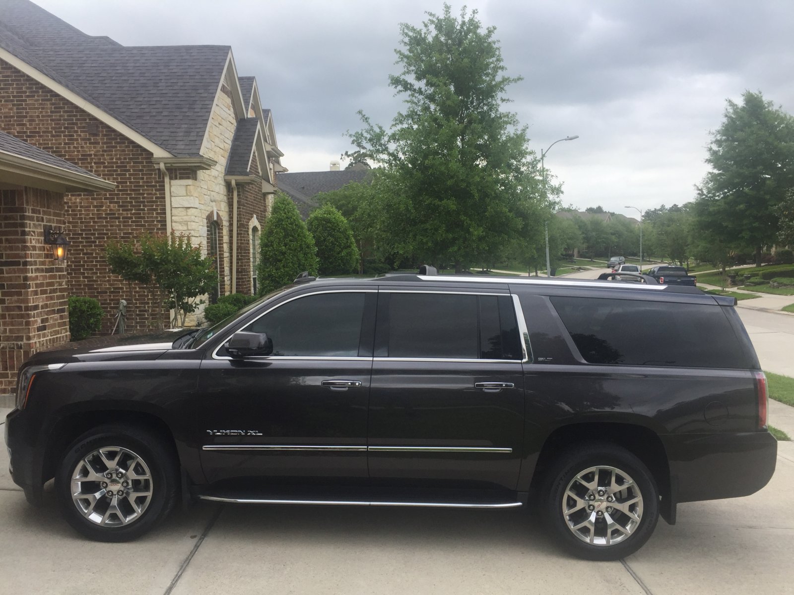

With inspiration from JennaBear and others (Thank You!), I finally got around to upgrading my GMC OEM rims from the factory (pictured first below and I’m selling - curious what a fair price would be), to some American Racing gloss black milled 22x9 +30 offset AR916 rims. Also went with some 33x12.5R22 Nitto Ridge Grapplers with a Rough Country 2 inch lift on the front (essentially the back remains technically 1/2 inch higher).
Loved how they turned out, and so far no rubbing (initially tried some Dropstars 654bm’s with a -25 offset, don’t do it, it is too wide, and I would be afraid going any wider than a +15 offset with this tire) and the ride is great and just as quiet as before. New specs are below...
-2016 Yukon XL SLT (Iridium Metallic)
-22x9 (+30 Offset) AR916 Gloss Black Milled Rims
-33x12.5R22 Nitto Ridge Grapplers
-Upgraded Factory Chrome Grill
-Upgraded to Denali Handles
-Upgraded to Denali Chrome Bumper
-Upgraded Tyger Chrome Roof Rack Molding Trim
-Upgraded Putco Chrome Back Door Molding Accents

Thanks all. :happy107: Anyone have an opinion on what price point I could sell the OEM rims at in the Houston area? I was seeing some threads state 1200 for all 4, but that was a while ago.

Yeah, my initial choice for rims was a 22x10 Dropstar 654bm...thing looked sick as well on the Yukon, but because it was a -25 offset, it caused the wheel to be further away from the suspension and made the wheel stick out about 2 inches from the wheel well. Looked awesome, but it caused the turn radius of the wheel in the front (with a two inch level) to be too wide...so much in fact that the wheel did not turn all the way and touched the back inner-side of the wheel well and would have ripped up the well and the static foot bar. My only choices were to lift the Yukon up to 6 inches which would have cost like 1400 to 1800 additional dollars as it would call for a total suspension lift or, return the rims and go for a different model with a more narrow rim (went with 22x9) and a more positive offset that would cause the rim to fit a little closer to the suspension and allow the wheel to clear the wheel well while turning.
I owe a lot of great guidance to those here and the gents at Big Tex Off-Road in Kingwood as they helped me through my initial mistake. Essentially, they recommended a 9 inch (instead of 10) wide rim and an offset of +18 to +30 (since the factory rims are +45...so while this rim did come in at a +15 offset...it was to risky for me to try when my first one failed. So you might be able to fit a +15 offset with this tire, but I certainly would not go lower than that with the Nitto Ridge Grappler.
